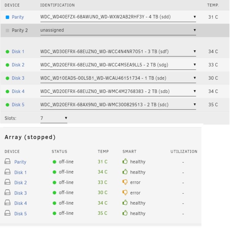

  24. tower-diagnostics-20230329-1712.zip These diagnostics were taken with the original data disk and the new parity (after it was synched for 13 hours). Thanks guys for all your help.
