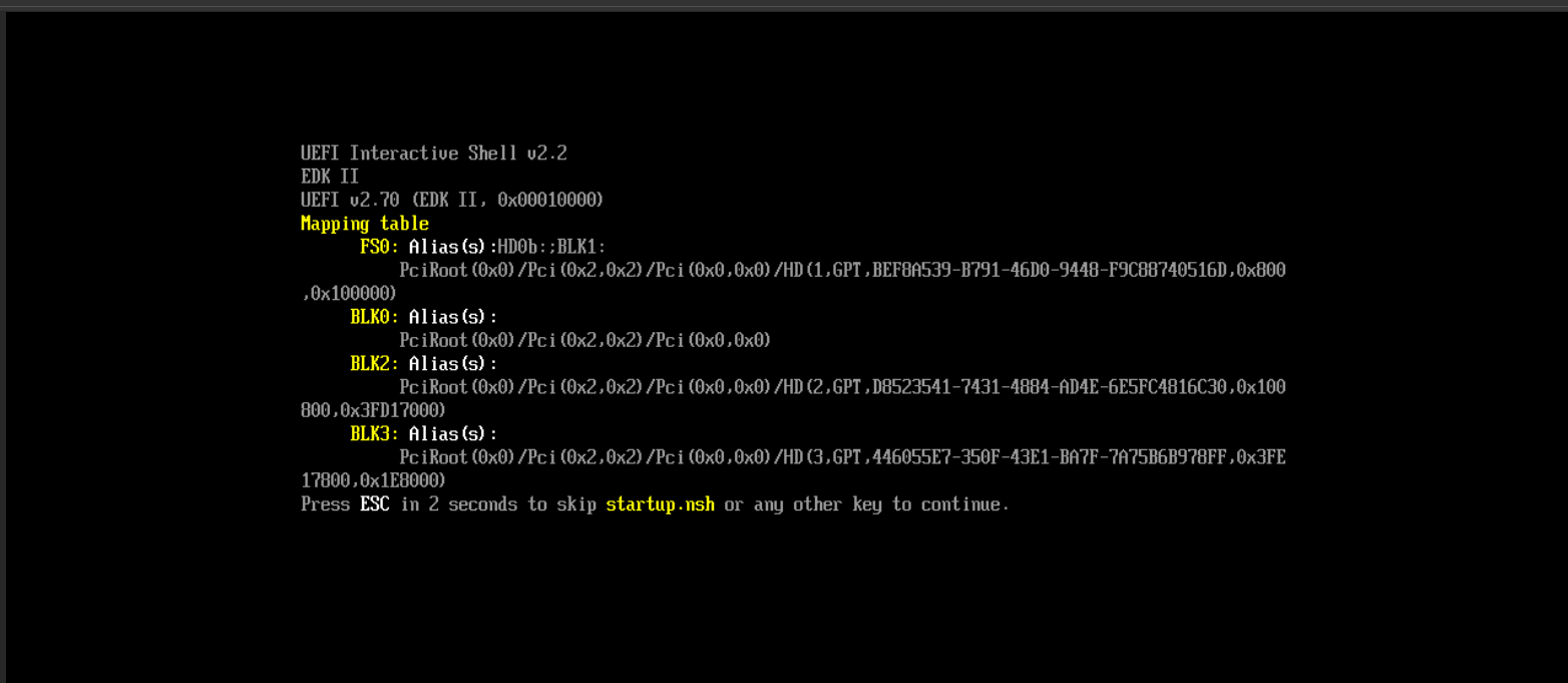

  2. Hello. A while back I added a gpu to my VM running my mail server and several other services. Since then I cannot download packages, it is not showing up in my local network, and I'm not even sure if it is connected to the internet. Not sure if it is related to that but when I try to remove the gpu from the VM and click update it does not update. I go back to the settings page then it says the gpu is not on the vm. Also on the bottom of that page it gives me the option to update even though the vm is running and i havent edited anything. When I click it nothing happens. After that someone in the unraid discord server suggested me to unbind the gpu to vfio to boot and still it didnt work. So after this I created another VM with the same disk and same ram, etc.. then i get this error Can someone please help me fix this? Not sure if I want more mailserver downtime.

  4. I tried testing GPU passthrough and it worked. I rebooted my system then it didn't work? I checked the VM log and found this "2023-04-08T21:26:39.380755Z qemu-system-x86_64: vfio_region_write(0000:01:00.0:region1+0x163272, 0x8a80,2) failed: Device or resource busy". So if I'm right the gpu is in use? I have binded both the gpu and the gpu sound card to vfio at boot. I have pcle override set to multifunction, and my gpu rom is valid as I used it before. I am confused on what is wrong here.
