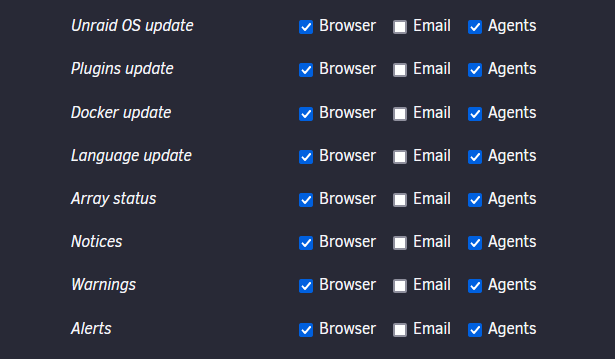

  3. Hello, I would like to receive a phone notification when only a webgui or ssh login to the UNRAID server occurs. I know that it is possible to set up notifications, but I have not found an option to get a notification when webgui or ssh authentication occurs. No found login noti here. -> Can anyone think of a solution? Thank you!
