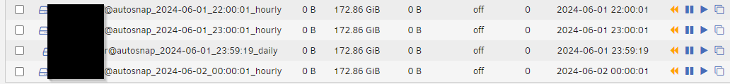

  1. Do someone has an idea why in the windows 10 shadow copy the snapshots are displayed 2 hours later? My smb config:

  6. Has someone find a solution to get the snapshots in windows shadow copy's with 6.12? Now the share's are configured unter the unraid gui "shares". Before i have configured them under the smb-extras.conf and there i have to put the following under each share: vfs objects = shadow_copy2 shadow: snapdir = .zfs/snapshot shadow: sort = desc shadow: format = %Y-%m-%d-%H%M%S shadow: localtime = yes But now because i have configured it under the unraid gui i can not make this options and i can not see the snapshots anymore in Windows 10. My Snapshots look like this: Someone has an idea?
