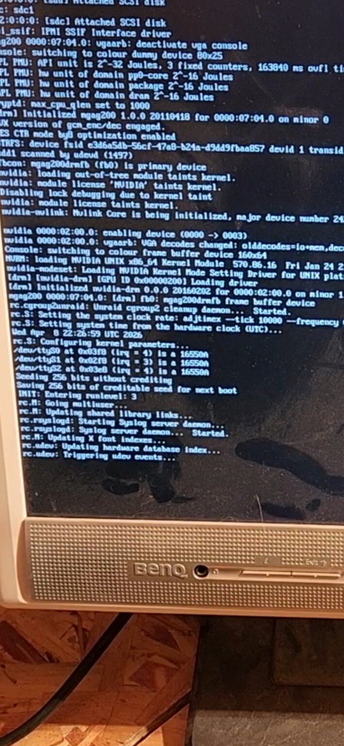

  2. Something the AI models tell me is that there's parameters that can be added to the boot that will display what device it's getting stuck on. Each model gives me a different parameter and none of them work. Is there any truth to this?
  3. I can't boot to get a diagnostics.zip. Is there another way to get this?

  7. Hello! I'm not sure when it started, but when moving data across my internal network, whether from SMB shares on a Win10 box into the Unraid filesystem, or LanCache pushing downloaded files, the Unraid computer reboots. Transfer will start, and may last for enough time to transfer a little something, but the transfer will eventually start to decrease and then stop altogether. When I check the WebGUI, the computer is either in the process of rebooting or shows my uptime only a few minutes. Incoming data on the WAN is just fine. Here's my diagnostics file. Thanks for your help! Jacob troll-diagnostics-20240812-2209.zip
