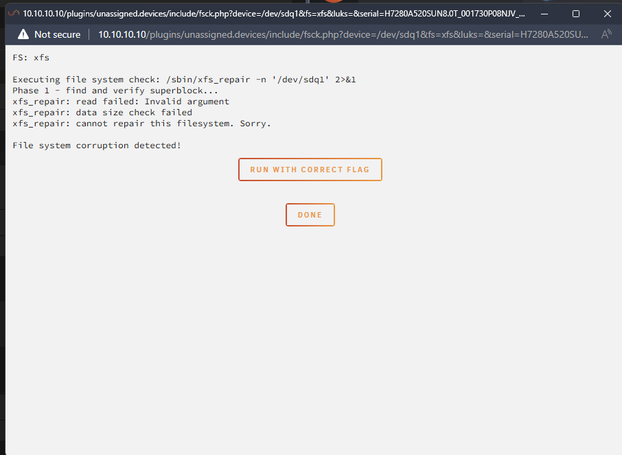

  18. Do you mean the “run with correct flag” option? I did that it still did not work unfortunately.

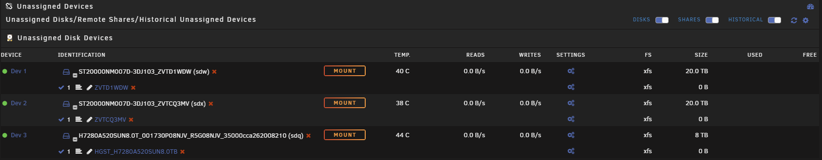

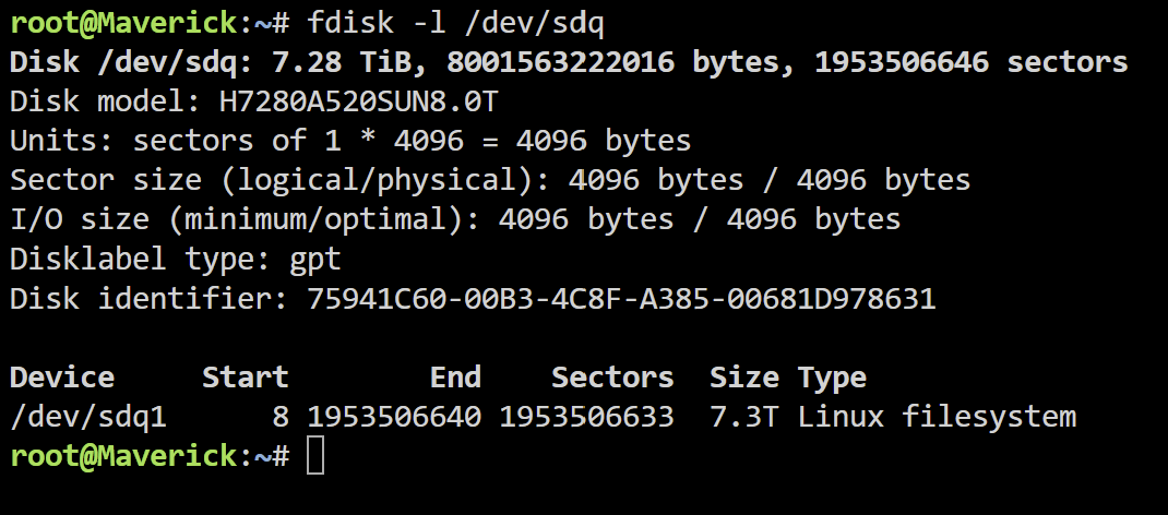

  19. I removed 5x8TB SAS disks from my array, and started a new config without parity, replacing those disks with 3x20TB and 2x16TB disks. The new config started up perfectly, no issues there, but now when I attempt to mount the 8TB disks under UD, it fails. Upon doing FS Check, it says they are corrupted. BUT THIS IS 20 MINS AFTER THEY WERE JUST IN THE ARRAY. It makes no sense. Any advise? maverick-syslog-20240825-2039.zip
  20. Ah I see. Yes both HBA’s have no bios installed and have the most up-to-date firmware from the Broadcom website (9305-16e - 16.00.12.00). I did double and triple check to make sure both had the correct firmware zip files. as for the cables, unfortunately that’s pretty dummy proof. The configuration of the cables where they are connected on the JBOD’s has not changed it in over two years of a working system and was triple checked to confirm they were in the primary ports. When leaving the JBOD’s, all four cables were connected to the 9206 HBA and the system was confirmed to be running as normal. Upon shutting down the system, each cable was removed from the 9206 HBA, and subsequently switched to the corresponding port on the 9305 HBA (0-0, 1-1, 2-2, 3-3)
