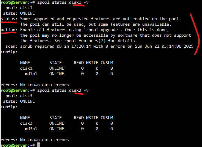

i moved the data, formatted the drive, didnt rebuild it from parity, started is as a fresh drive and now it all works. i have two final questions though: 1) what do you think could've caused this and what do i do to prevent this in future? 2) when i run zpool status disk3 -v it shows me less info, compared to other disks1,2,4,5. why is that so? does this mean other disks need to be formatted too because they have some features disabled and only disk3 has them enabled since it is a "newly" installed disk?

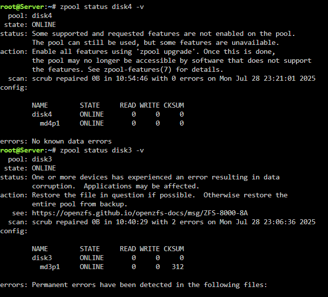

i just finished scrubbing disk4 with this result so i think disk4 is healthy, right? i'm going to start moving data from disk3 to disk5 now and post an update afterwards.- Folder inside share empty, but files accessible from disks. Also random damaged files on two disks.
does this definitely mean disk4 is healthy and only disk3 is corrupted? or do i need to run some additional commands to make sure disk4 is definitely healthy? what do i do now? do i start copying data from disk3 to other disks? and whats the next step after i copy that data? do i just remove the disk3 from array and keep using the server? idk how to properly REMOVE the drive from array, so far i've only ever added new drives to the server.- Folder inside share empty, but files accessible from disks. Also random damaged files on two disks.
but i ran memtest for a long time with no issues. how can the ram be faulty? i am going to throw this disk3 away completely after this scrub is done. and i'll monitor disk4 too. in case it also starts acting up imma throw it too. i have 12th gen i3. is that risky too? its just the disk that is corrupted right? not the files. i mean moving data from disk3 to other disks wont damage them too, right?- Folder inside share empty, but files accessible from disks. Also random damaged files on two disks.

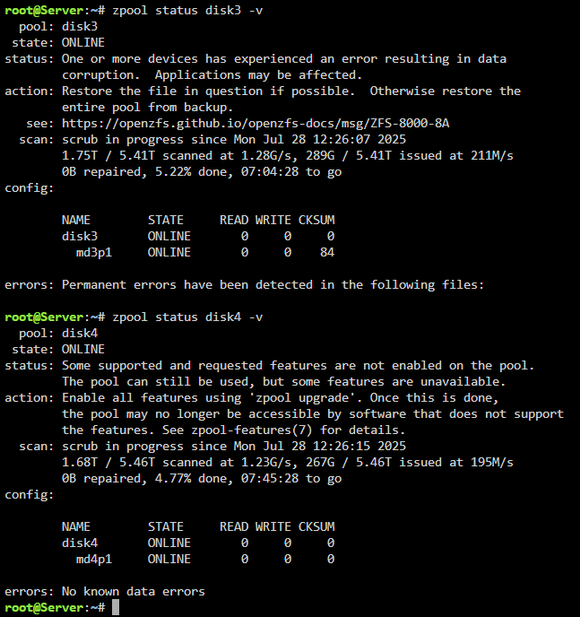

i tried manually removing, clearing and re-adding disk3 and disk4 to the array rebuilding each one of them separately from parity. issue still persists. now i started scrub again and this is the current situation as of right now: I'm going to reboot system after scrub and post here again. i'm so confused at this point. how can everything inside share be accessible except one folder. and how can even that one folder still be accessible through individual disks? what is the problem with my server exactly? are the drives dying? are the cables faulty?- Folder inside share empty, but files accessible from disks. Also random damaged files on two disks.
