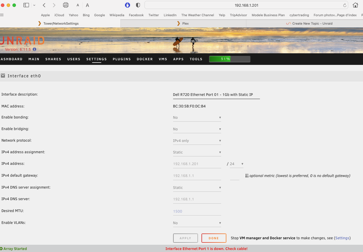

  9. Thanks for the info, I have stopped all Ethernet 1,2 and 3 and set Eth 0 to static IP and static DNS. Reboot and now it seems to be working ok. and I can access the APPS and I can reconnect to Plex from mobile ad TV. Thus WORKS Yet, it still displays Interface Ethernet Port 1 is down. Check cable! yet Mystery to me, Anyone knows where I can find literature to understand better Unraid networking / Bridge/ Host..etc Thibaut
