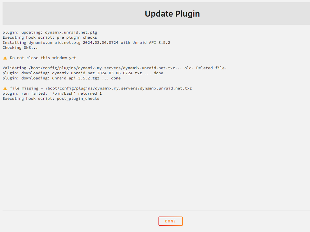

  7. Got some help on the discord a bit ago...did these steps and it got it back working: Uninstall the connect plugin, check the flash drives config > plugins folder for anything related to connect or myservers and delete it, reboot unraid and install the plugin again and sign in

  9. When trying to upgrade to 2024.03.06.0724, I am getting failures due to "file missing". Once this is run and fails, it kills all the shares on the server too, and only a reboot will restore them. Here is the error:
