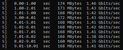

    Those are all good suggestions. Thank you After a few hours of tinkering, I have come to the conclusion that my 10Gbe NIC thats built into my desktop is acting wonky. I was able to make a 2.5Gbe connection, and iperf3 gave me a 2.35Gbit result. This means that my Unraid box is not at fault, my switch is fine, my cables (mix of cat 7 and 8) are fine, and the 2.5Gbe port on my desktop maxed out. But when I connected to the 10Gbe on my desktop, I was limited to 185MB's in iperf3. That's the conclusion that I've come up with. Now what to do about the 10Gbe port on my desktop? I cant just replace the port? I'm out of PCI-e slots. I do have a USB4 / Thunderbolt capable port on my motherboard, 2 of them. BTW, U have a Asus ProArt X670E-CREATOR WIFI motherboard in my desktop. Or, I have a setting in BIOS or Windows thats nerfing my 10Gbe port. I'll update you guys soon.

    I'm having issues reaching 10GBE speeds. I've tried disabling ASPM in bios, disabling flow control in my Unifi switch, enabling and disabling MTU, setting MTU to 1500 and 9000, and many more settings I already forgot. I have a desktop connected to a Unifi switch via 10GBE. Desktop PC says its connected at 10G. Cool! Then I have a Unraid server. Motherboard is a MSI MPG B-560 Gaming Edge Wifi. My Unraid server is connected to the Unifi switch via a custom DAC cable, built for Intel and Unifi systems. Both ends are connected to their proper device. Anyways, I'm using a M.2 to SFP+ adapter, why you ask, because the other M.2 slot is occupied by an NVME card. What suggestions can you guys give me to rectify my situation I'm having. I've used iperf3 and was able to get a 180MB's, not even close to 10GBE. Thank you tower-diagnostics-20260912-2128.zip
