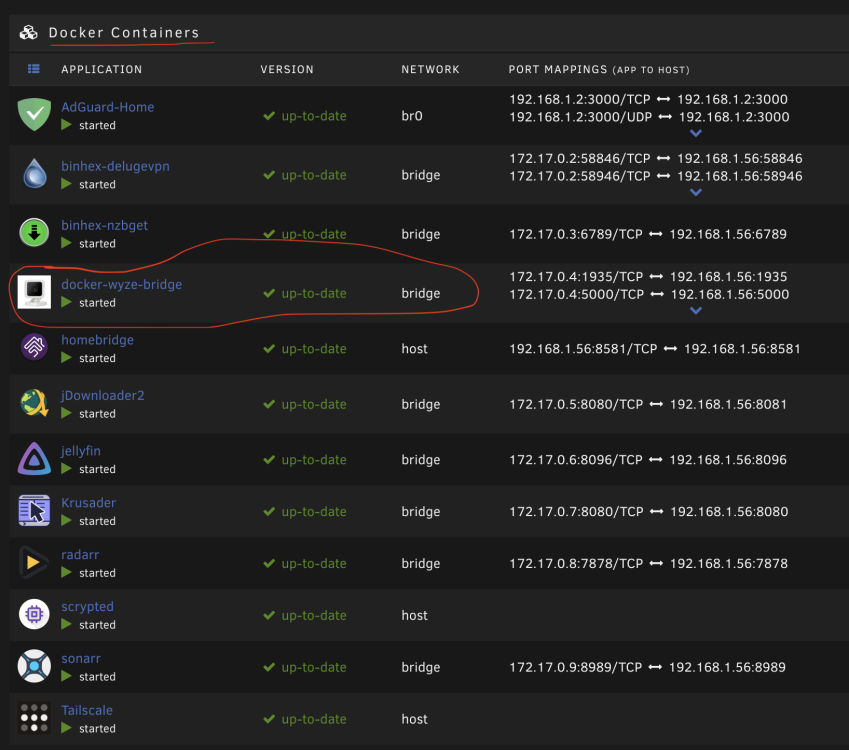

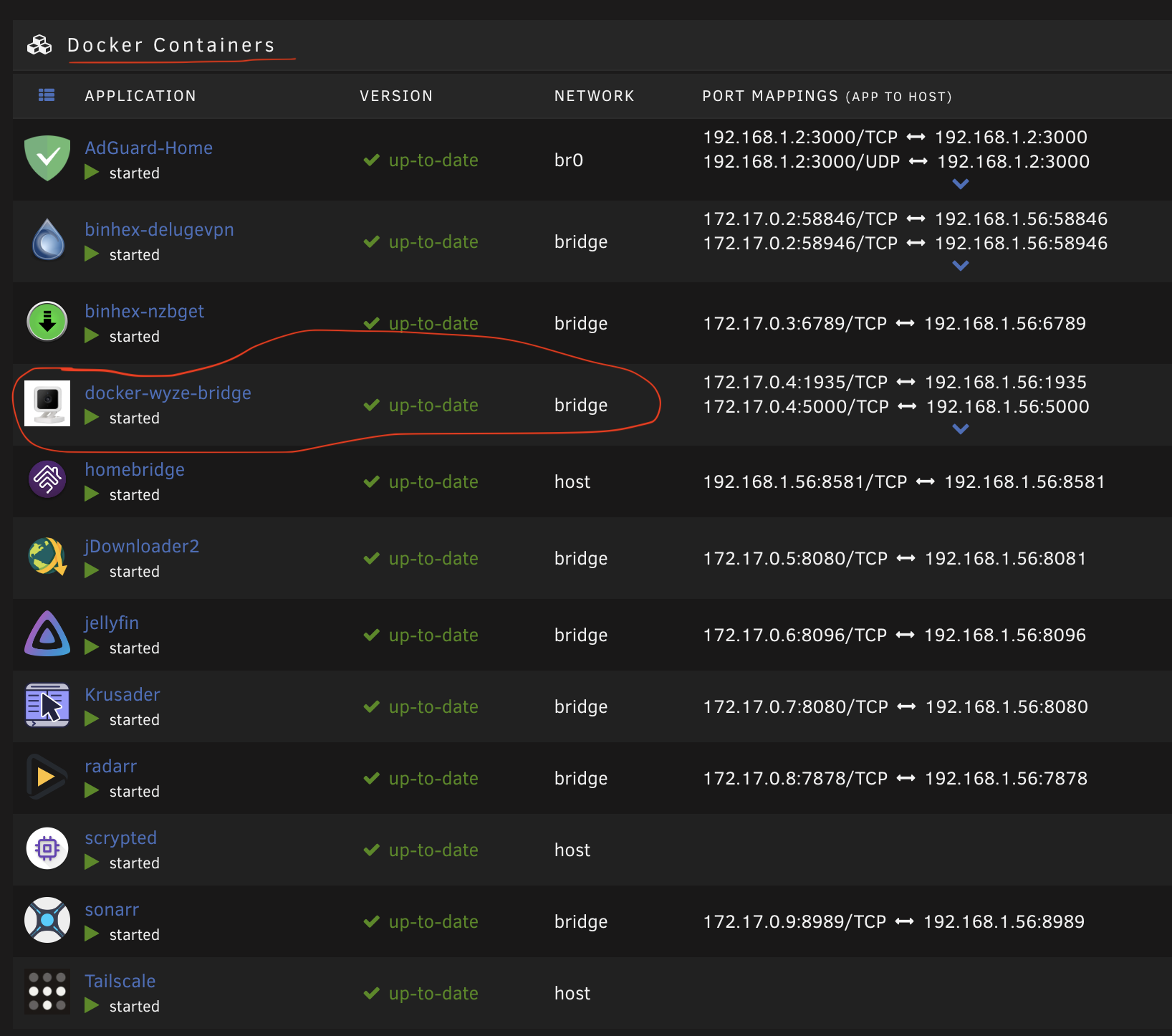

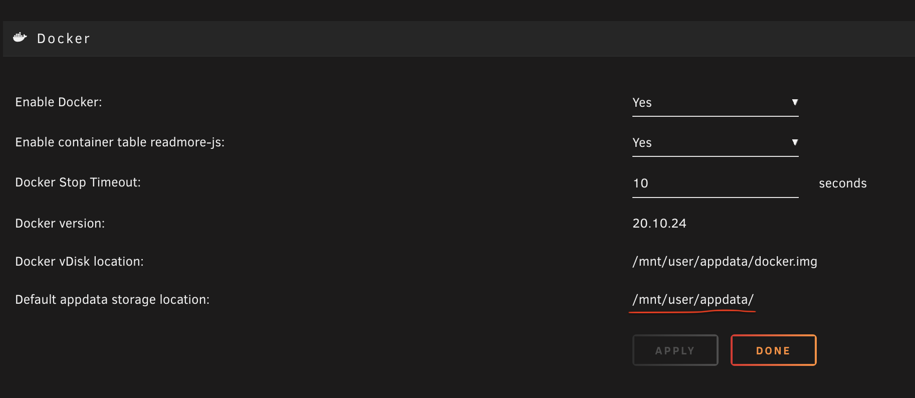

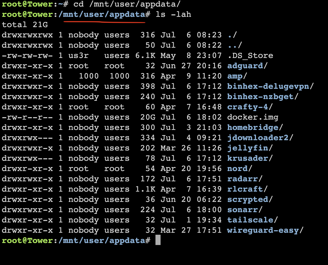

  1. Hi All, Still learning docker so bare with me! I have multiple docker containers running successfully and needed to change the enviornment variable for the wyze docker container... I don't see it in /mnt/user/appdata... am i missing something? Thanks in advance!!
  2. Thank you both for your help! Correct I added a second drive to the cache pool and had renamed it! Thanks again!
