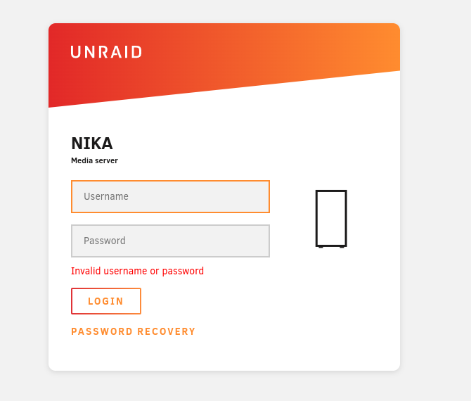

  6. Seems I can login if I use Firefox, but not Brave. "/

  8. When I login to the server from the server, it just works, but when I try to login to the server from the https://serverip/login page, it doesn't work and it refreshes the page. It's also strange, why does the server give me a different local IPv4 address then what the computer actually has? Local IP 192.168.0.3 IPv4 address: 169.254.xxx.xx It's totally off the ribbon, it changes the local IP every other reboot, between the local and the other. "/ It's a newly created USB stick too, with unRAID 7b2. "/ EDIT: I tested out resetting the password, and changed it to the same, and rebooted, and it's still not working. "/ EDIT2: Sooooo, it's Brave that is the problem. "/ I can login with Firefox without a problem. Why doesn't it work with Brave? It's been working on Brave with my other stick without a hitch.
