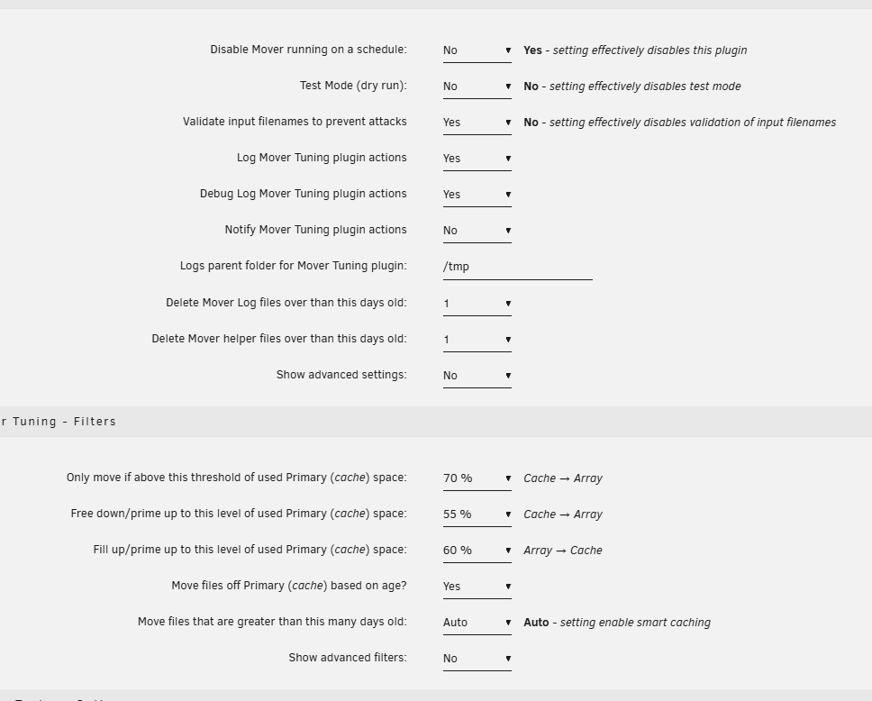

  1. Hello everybody ! i'm facing issue with mover tuning: i'm above threshold, and no files are moved. configuration is quite standard: is there a way to have more information about, why nothing is moved (maybe i have missed something) ? regards

  9. it seems that my cache has been flushed ???!! As it is base on "old age", is it possible that files with less that 1 day old, are not moved ?
  10. Hello, i have an issue with CA Mover Tuning : data are not moved from cache to array : Unraid Version: 7.0.1 Mover Tuning Version: 2025.04.24a Issue: eg. data are not moved from cache to array : Here my cache : CA mover Tuning settings : Logs : Apr 26 19:00:04 Saroumane move: ------------------------------------------------------------ Processing [media] share ----------------------------------------------------------- Apr 26 19:00:05 Saroumane move: Primary storage: cache - size: 457GiB - used: 83 % (367GiB) Apr 26 19:00:05 Saroumane move: Secondary storage: user0 Apr 26 19:00:05 Saroumane move: Share Information: Name: media - Path: /mnt/cache/media Apr 26 19:00:05 Saroumane move: Moving threshold: 70% (320GiB) ; Freeing threshold: 55% (252GiB) Apr 26 19:00:05 Saroumane move: Mover action: cache->user0 (cache:yes). Pool is above moving threshold percentage: 83% >= 70%. Apr 26 19:00:05 Saroumane move: => Will smart move old files from cache to user0. Nothing will be moved from user0 to cache Apr 26 19:00:05 Saroumane move: ------------------------------------------------------ Debugging [media] share Find Function ---------------------------------------------------- Apr 26 19:00:05 Saroumane move: FINDSTR: find "/mnt/cache/media" -type f -depth -not -name '.placeholder' -printf '%T@|%s|%S|%n|%i|%p|\0' | awk -v RS='\0' -v FS='|' -v SPARSENESS='0' -v PRIMARYSTORAGENAME='cache' -v SECONDARYSTORAGENAME='user0' -v SHARENAME='media' -v SHAREUSECACHE='yes' -v PRIMARYSIZETHRESH='269557680128' ' { printf "%s|%s|%s|%s|%d|%d|%d|%d|%d|%d|%s\n", PRIMARYSTORAGENAME, SECONDARYSTORAGENAME, SHARENAME, SHAREUSECACHE, $1, PRIMARYSIZETHRESH, $2, $3, $4, $5, $6}' Apr 26 19:00:05 Saroumane move: Apr 26 19:00:05 Saroumane move: Updated Filtered filelist: /tmp/ca.mover.tuning/Filtered_files_2025-04-26T190002.list for media Apr 26 19:00:05 Saroumane move: ------------------------------------------------------------ Processing [system] share ---------------------------------------------------------- Apr 26 19:00:05 Saroumane move: Primary storage: cache - size: 457GiB - used: 83 % (367GiB) Apr 26 19:00:05 Saroumane move: Secondary storage: user0 Apr 26 19:00:05 Saroumane move: Share Information: Name: system - Path: /mnt/*/system Apr 26 19:00:05 Saroumane move: Moving threshold: % (0B) ; Filling up threshold: 60% (55GiB) Apr 26 19:00:05 Saroumane move: ----------------------------------------------------- Debugging [system] share Find Function ---------------------------------------------------- Apr 26 19:00:05 Saroumane move: FINDSTR: find "/mnt/disk2/system" -type f -depth -not -name '.placeholder' -printf '%T@|%s|%S|%n|%i|%p|\0' | awk -v RS='\0' -v FS='|' -v SPARSENESS='0' -v PRIMARYSTORAGENAME='cache' -v SECONDARYSTORAGENAME='user0' -v SHARENAME='system' -v SHAREUSECACHE='prefer' -v PRIMARYSIZETHRESH='58052586700' ' { printf "%s|%s|%s|%s|%d|%d|%d|%d|%d|%d|%s\n", PRIMARYSTORAGENAME, SECONDARYSTORAGENAME, SHARENAME, SHAREUSECACHE, $1, PRIMARYSIZETHRESH, $2, $3, $4, $5, $6}' Apr 26 19:00:05 Saroumane move: Apr 26 19:00:05 Saroumane move: --------------------------------------------------------- Debugging [system] count files -------------------------------------------------------- Apr 26 19:00:05 Saroumane move: Amount of files on secondary storage: 0 Apr 26 19:00:05 Saroumane move: Apr 26 19:00:05 Saroumane move: ************************************************************ ANALYSING MOVING ACTIONS *********************************************************** Apr 26 19:00:05 Saroumane move: Deciding the action (move/sync/keep) for each file. There are 131 files, it can take a while... Apr 26 19:00:06 Saroumane move: No new files will be moved/synced from primary to secondary Apr 26 19:00:06 Saroumane move: No new files will be moved/synced from secondary to primary Apr 26 19:00:06 Saroumane move: Cleaning lock and stop files Apr 26 19:00:06 Saroumane move: ****************************************************************** WE ARE DONE ! **************************************************************** I know that in media i have 135G all data than can be fluh to array. But nothing happen. I don't see any errors. maybe i have misunderstood something in the settings ?! regards
