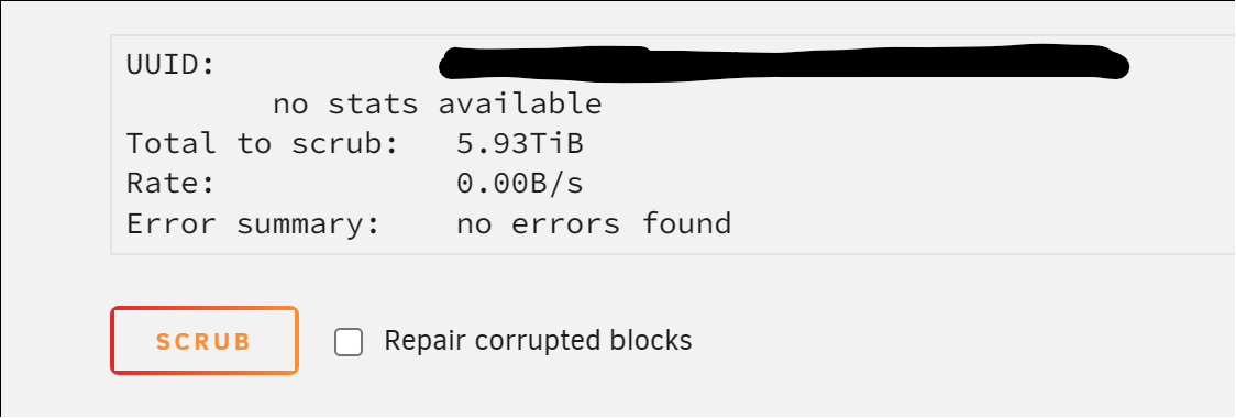

  12. Thank you. I run scrub all of disks without error.
