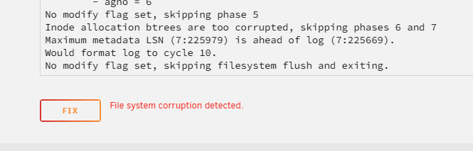

  3. I've run the Filesystem check on Disk 3 and the Fix option, it did a lot more than last time, I did see it has created some lost+found from the repair logs, however before I proceeded any further I wanted to check what was the correct next steps as I've just run the check on Disk 2 now that Disk 3 is finished repairing, and I've now got this message:

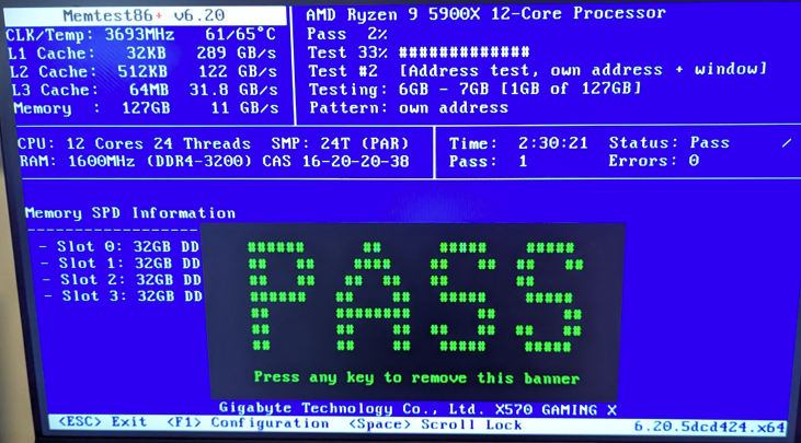

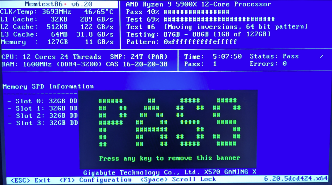

  4. Ran memtest86+ for just over 5 hours and no issues were encountered, memory passes. morialta-diagnostics-20260829-1657.zip

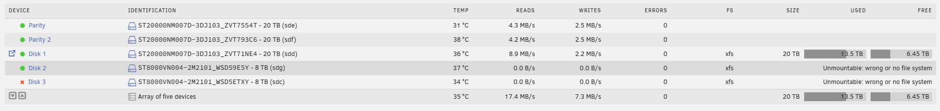

  8. Okay after data rebuild on that drive its gone back to a similar state, the parity check is flagging some errors so I could run the full parity check, the drive is also showing over 2000 device errors on the main array page: morialta-diagnostics-20260829-0752.zip

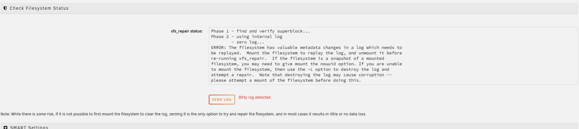

  12. Thanks for the super quick reply, I have done that now and its found corruption, should I click the button labeled "Fix" CheckFilesystemStatus.txt
