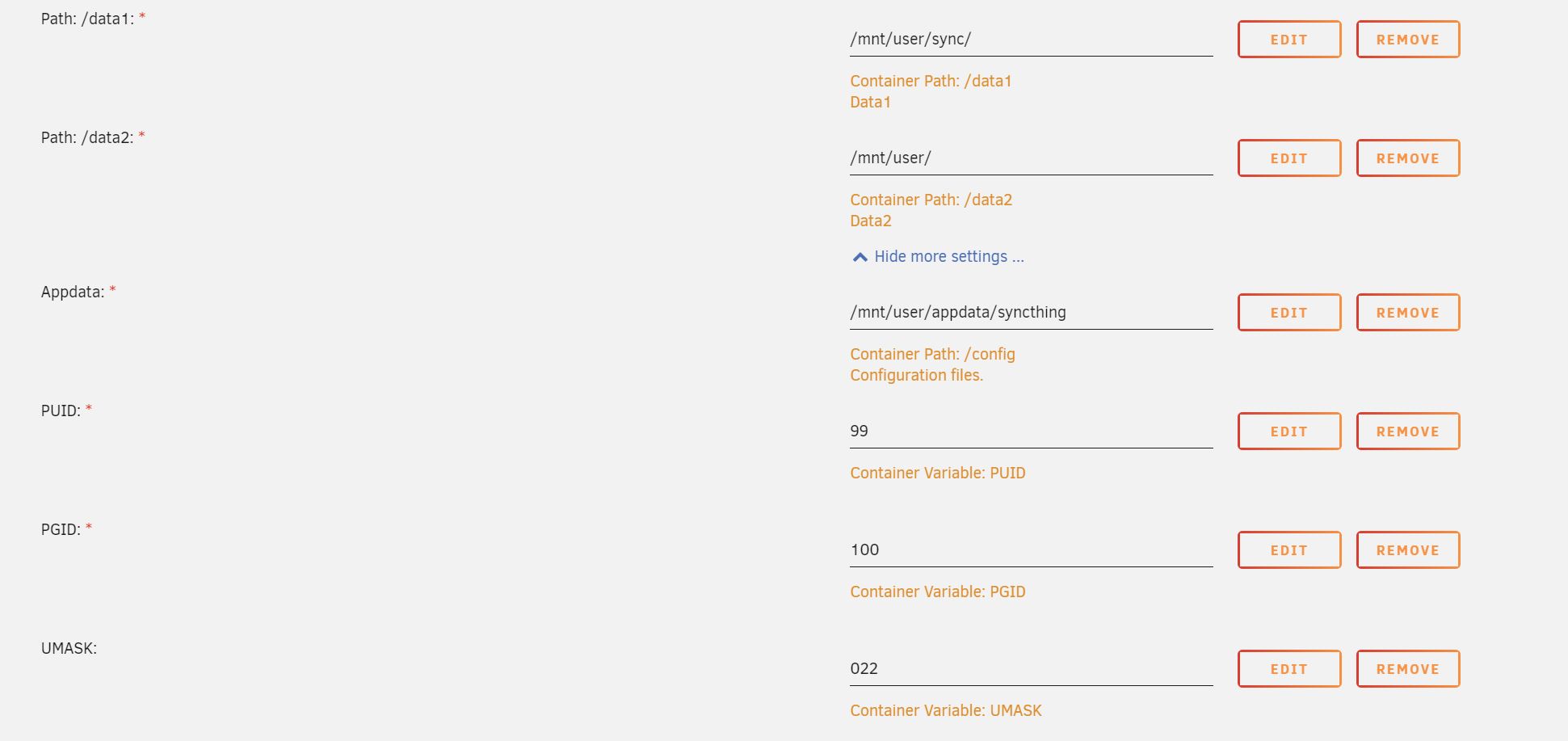

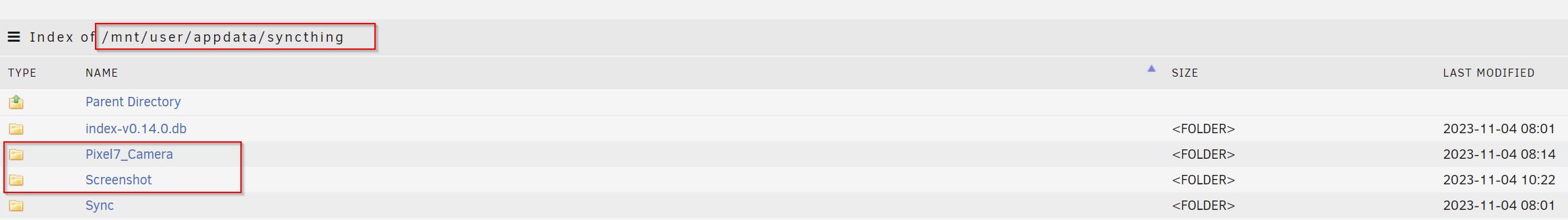

  2. I have set up Syncthing docker in Unraid as a backup/cloud for my Andriod phone pictures. Everything goes well but I find out the sync folder is created in appdata. /mnt/user/appdata/syncthing/Pixel7_Camera/Camera Is it possible to point the sync folder to another share, outside of appdata? It is because appdata is running on cache drive and it is not parity protected and I find it difficult to move the files inside appdata folder. Thanks

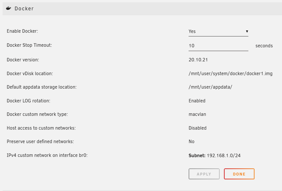

  3. How do I change my docker network to ipvlan? I am in setting but it wasn't editable.
