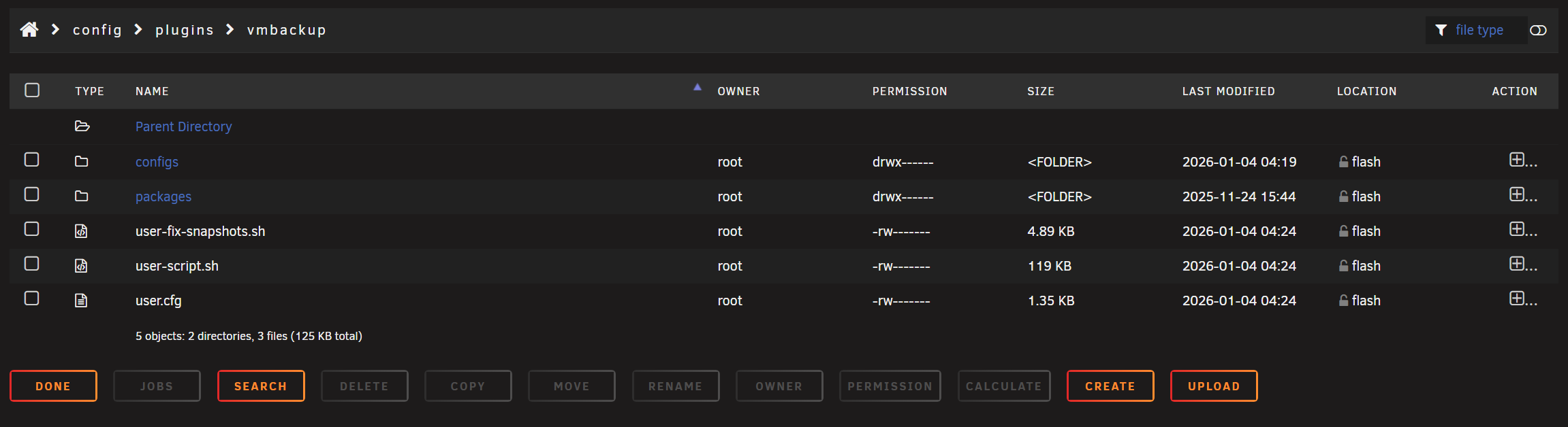

Hello, does anybody have a config that they could share with me for pre- or post-scripts of the Unraid VM Backup plugin? Unfortunately, there is a bug, and the repo is more or less unmaintained: https://github.com/JTok/unraid.vmbackup/issues/47 But if somebody already has some upload scripts and can show the structure of the folder with permissions, it would be awesome.

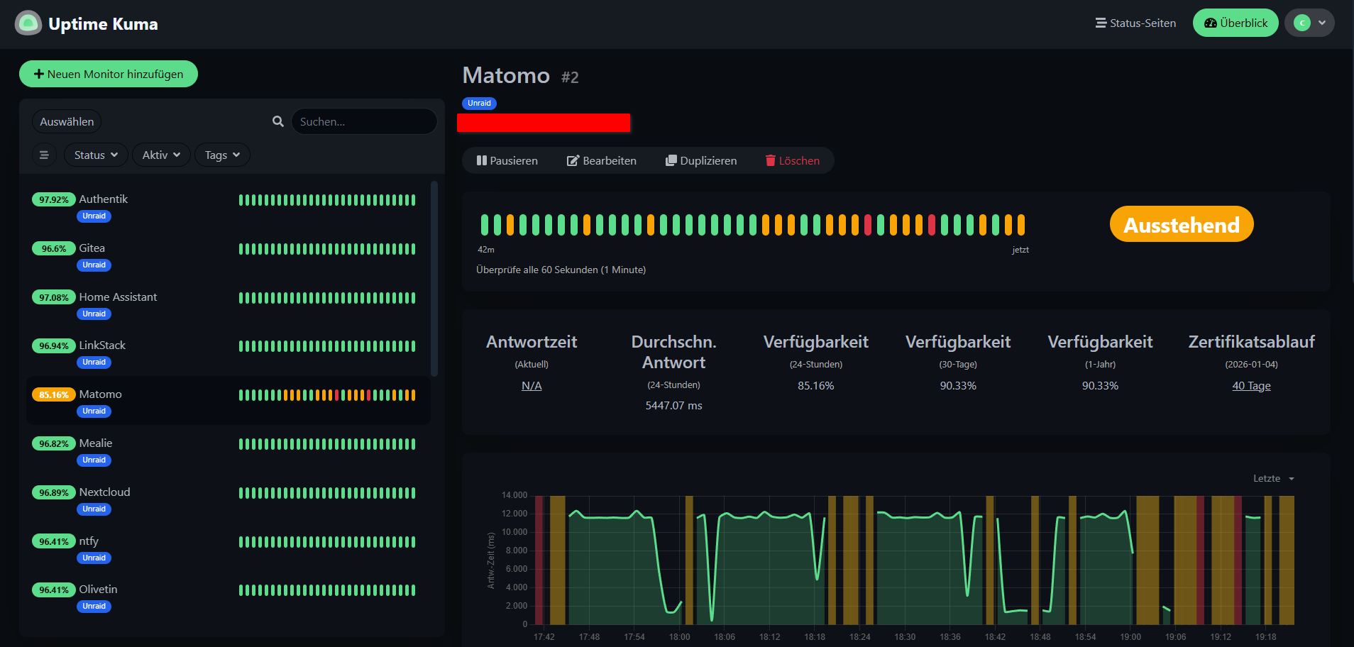

I cannot believe this. It started again yesterday. Now it's only one container behaving like this. It started like this when I had this issue as well. After rebooting Unraid, it seems to work flawlessly for at least an hour, but in general, something is wrong because I can see that calls to the service need between 2000 and 30000ms, and sometimes even timeout. In the container logs, I see: [Mon Nov 24 19:11:25.604359 2025] [php:notice] [pid 87:tid 87] [client 172.19.0.29:56560] [stats.xyz.de] Error in Matomo: Could not connect to the database: SQLSTATE[HY000] [2002] No route to host This may be a temporary issue, try refreshing the page. Please contact your Matomo administrator if the problem persists. 172.19.0.29 - - [24/Nov/2025:19:11:20 +0100] "GET / HTTP/1.1" 500 2278 "-" "Uptime-Kuma/2.0.2" 172.19.0.29 - - [24/Nov/2025:19:11:52 +0100] "GET /matomo.php HTTP/1.1" 200 502 "-" "Uptime-Kuma/1.23.17" 127.0.0.1 - - [24/Nov/2025:19:11:53 +0100] "GET /matomo.php HTTP/1.1" 200 609 "-" "curl/8.14.1" [Mon Nov 24 19:12:23.334519 2025] [php:notice] [pid 53:tid 53] [client 172.19.0.29:35966] [stats.xyz.de] Error in Matomo: Could not connect to the database: SQLSTATE[HY000] [2002] No route to host This may be a temporary issue, try refreshing the page. Please contact your Matomo administrator if the problem persists. 172.19.0.29 - - [24/Nov/2025:19:12:20 +0100] "GET / HTTP/1.1" 500 2278 "-" "Uptime-Kuma/2.0.2" 172.19.0.29 - - [24/Nov/2025:19:12:27 +0100] "GET /piwik.js HTTP/1.1" 200 22396 "https://xyz.de/" "Mozilla/5.0 (Linux; Android 10; K) AppleWebKit/537.36 (KHTML, like Gecko) Chrome/142.0.0.0 Mobile Safari/537.36" 172.19.0.29 - - [24/Nov/2025:19:12:52 +0100] "GET /matomo.php HTTP/1.1" 200 502 "-" "Uptime-Kuma/1.23.17" 127.0.0.1 - - [24/Nov/2025:19:12:53 +0100] "GET /matomo.php HTTP/1.1" 200 609 "-" "curl/8.14.1" [Mon Nov 24 19:13:23.302342 2025] [php:notice] [pid 87:tid 87] [client 172.19.0.29:55620] [stats.xyz.de] Error in Matomo: Could not connect to the database: SQLSTATE[HY000] [2002] No route to host This may be a temporary issue, try refreshing the page. Please contact your Matomo administrator if the problem persists. 172.19.0.29 - - [24/Nov/2025:19:13:20 +0100] "GET / HTTP/1.1" 500 2278 "-" "Uptime-Kuma/2.0.2" 172.19.0.29 - - [24/Nov/2025:19:13:38 +0100] "GET /piwik.js HTTP/1.1" 200 22396 "https://xyz.de/" "Mozilla/5.0 (Linux; Android 10; K) AppleWebKit/537.36 (KHTML, like Gecko) Chrome/142.0.0.0 Mobile Safari/537.36" 172.19.0.29 - - [24/Nov/2025:19:13:52 +0100] "GET /matomo.php HTTP/1.1" 200 502 "-" "Uptime-Kuma/1.23.17" 127.0.0.1 - - [24/Nov/2025:19:13:53 +0100] "GET /matomo.php HTTP/1.1" 200 609 "-" "curl/8.14.1"Before, you only saw 200er status codes. How is it possible that it starts the connection to the database container? The database container is running, and I can see no issue. This issue is driving me insane. It must have something to do with Docker networking. The more time the server is running, the more containers will become slowly when calling them. How can I debug this or find out what is going on? Syslogs do not really show any reason. Nothing is logged. Still, these logs are concerning me: Nov 24 17:41:30 UNRAID-Server sshd[2156]: Received signal 15; terminating. Nov 24 17:41:30 UNRAID-Server sshd[39256]: Server listening on fd7a:115c:a1e0::3801:2f78 port 1997. Nov 24 17:41:30 UNRAID-Server sshd[39256]: Server listening on 100.76.47.120 port 1997. Nov 24 17:41:30 UNRAID-Server sshd[39256]: Server listening on fd31:e9c1:819e::53 port 1997. Nov 24 17:41:30 UNRAID-Server sshd[39256]: Server listening on 192.168.178.29 port 1997. Nov 24 17:41:32 UNRAID-Server avahi-daemon[39819]: *** WARNING: Detected another IPv4 mDNS stack running on this host. This makes mDNS unreliable and is thus not recommended. *** Nov 24 17:41:32 UNRAID-Server avahi-daemon[39819]: *** WARNING: Detected another IPv6 mDNS stack running on this host. This makes mDNS unreliable and is thus not recommended. ***

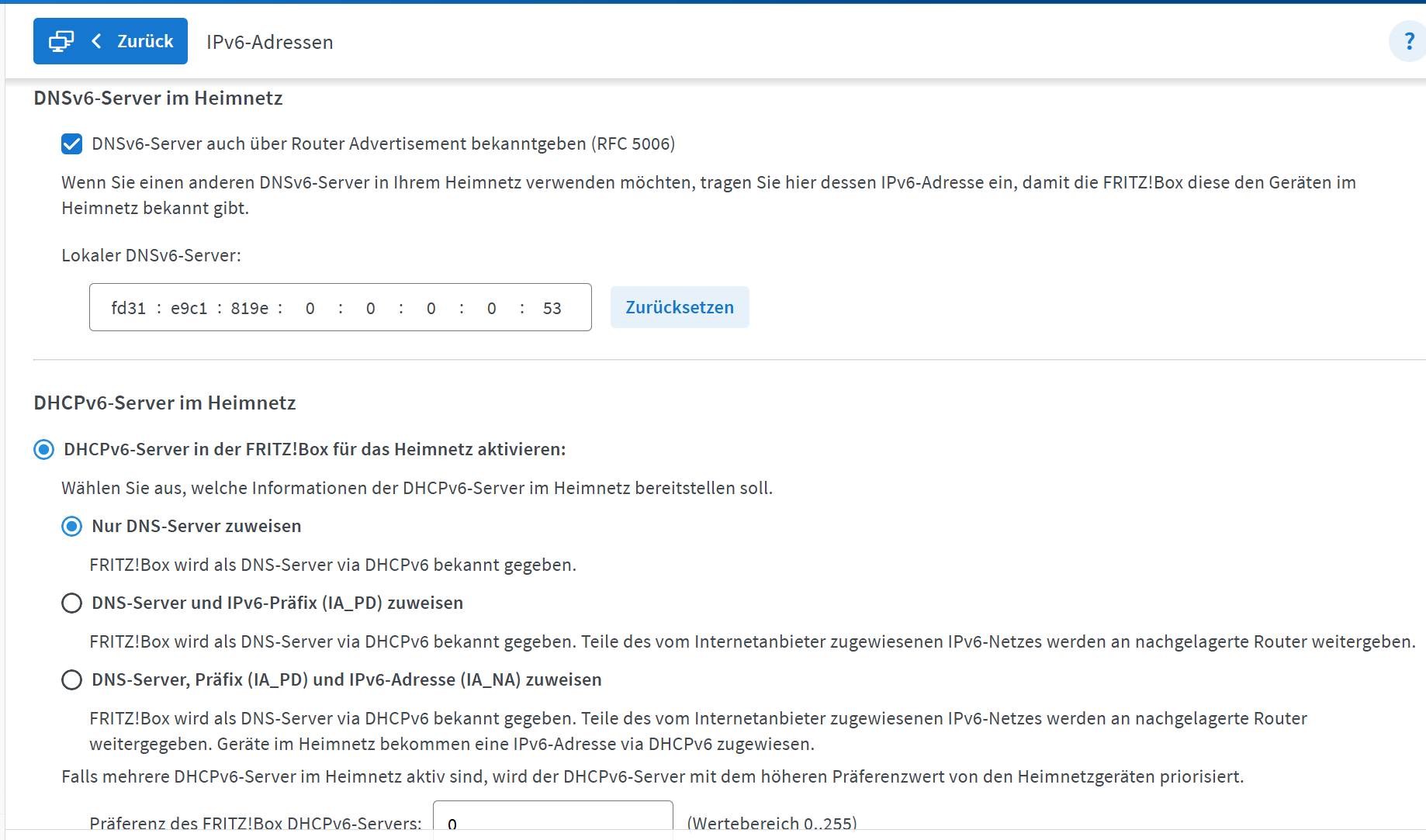

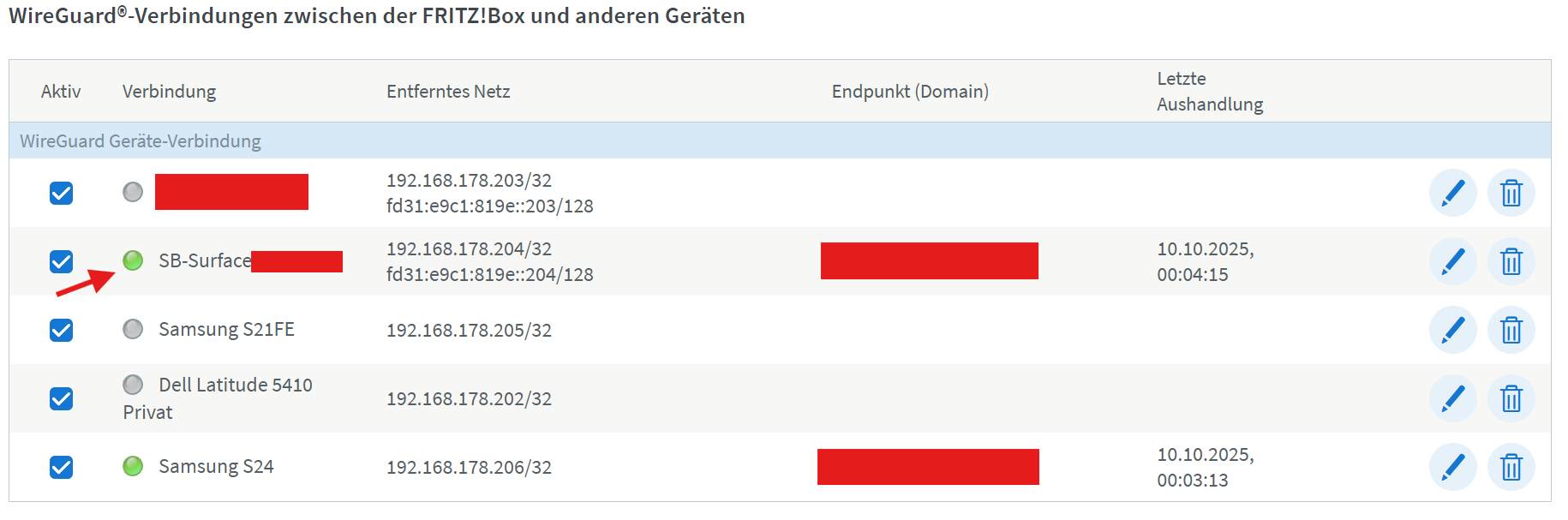

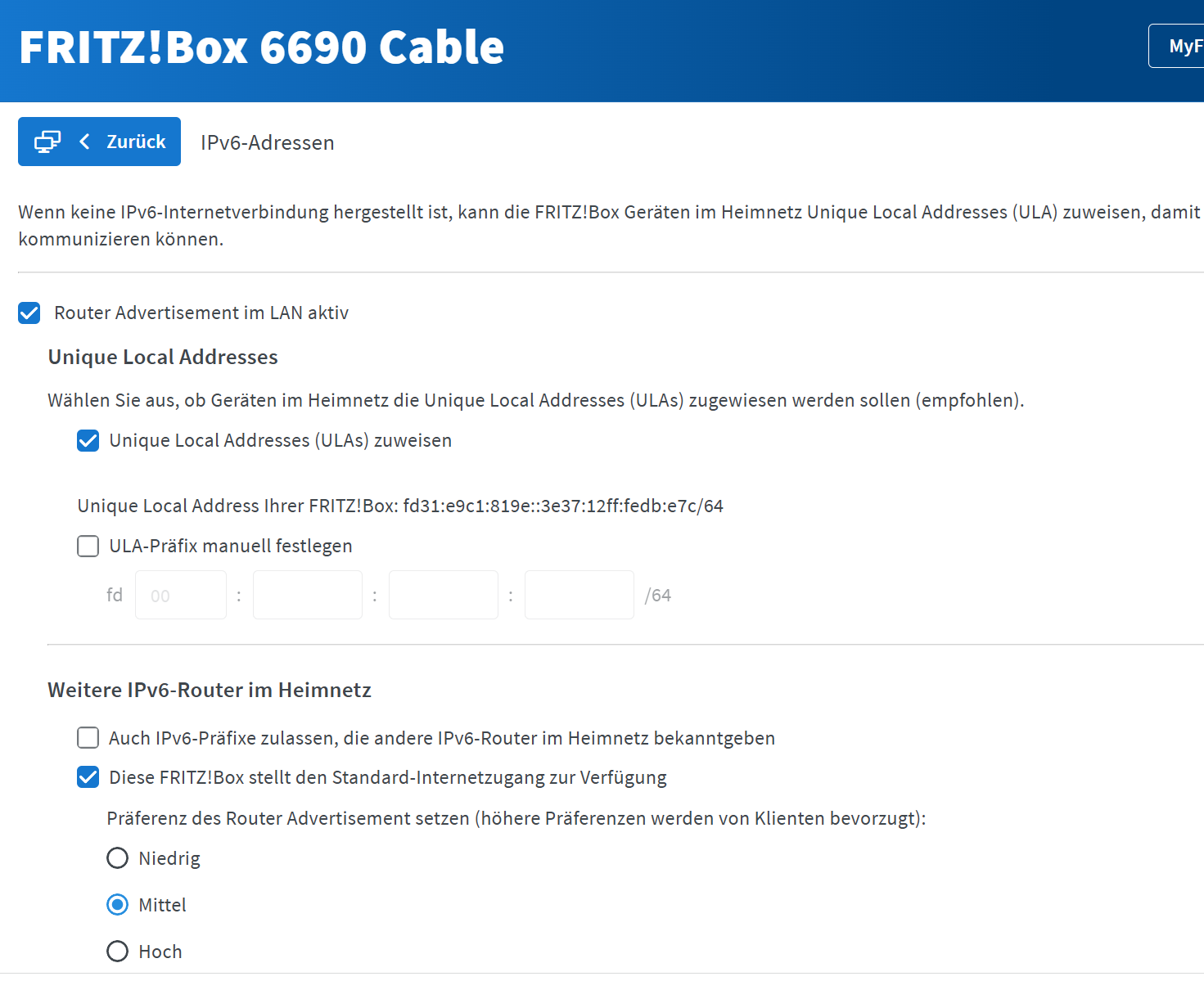

Altes Thema, aber dasselbe Problem. Ich dachte eigentlich, ich hätte es, aber ich bin nun im Ausland per VPN nach Hause über WireGuard in meiner FRITZ!Box verbunden. Ich nutze ebenfalls br0 für AdGuardHome. Zu Hause hatte ich seit der Aktivierung von IPv6, die ich für ein Thread Netzwerk für mein Smart Home brauchte, erstmal nur Probleme und es dann mit der jetzigen Konfiguration aber geschafft, dass alle Geräte über AdGuardHome laufen. In der FRITZ!Box habe ich unter IPv4 Adressen für Lokaler DNS-Server die IP-Adresse von AdGuardHome, also bei mir 192.168.178.2 angegeben. Bei IPv6 Adressen, ebenfalls unter Heimnetz, so: Meine Unraid Einstellungen: Meine AdGuard DNS Einstellungen: dns: bind_hosts: - 0.0.0.0 - '::' port: 53 anonymize_client_ip: false ratelimit: 0 ratelimit_subnet_len_ipv4: 24 ratelimit_subnet_len_ipv6: 56 ratelimit_whitelist: [] refuse_any: true upstream_dns: - '[/fritz.box/]192.168.178.1' - '[/168.192.in-addr.arpa/]192.168.178.1' - '[/local/168.192.in-addr.arpa/]192.168.178.1' - https://dns10.quad9.net/dns-query upstream_dns_file: "" bootstrap_dns: - 9.9.9.10 - 149.112.112.10 - 2620:fe::10 - 2620:fe::fe:10 fallback_dns: [] upstream_mode: load_balance fastest_timeout: 1s allowed_clients: [] disallowed_clients: [] blocked_hosts: - version.bind - id.server - hostname.bind trusted_proxies: - 127.0.0.0/8 - ::1/128 cache_enabled: true cache_size: 4194304 cache_ttl_min: 0 cache_ttl_max: 0 cache_optimistic: false bogus_nxdomain: [] aaaa_disabled: false enable_dnssec: false edns_client_subnet: custom_ip: "" enabled: false use_custom: false max_goroutines: 300 handle_ddr: true ipset: [] ipset_file: "" bootstrap_prefer_ipv6: false upstream_timeout: 10s private_networks: [] use_private_ptr_resolvers: true local_ptr_upstreams: - 192.168.178.1 use_dns64: false dns64_prefixes: [] serve_http3: false use_http3_upstreams: false serve_plain_dns: true hostsfile_enabled: true pending_requests: enabled: true Scheinbar umgehe ich geschickt IPv6 irgendwie, da in meinen AdGuardHome Logs immer nur IPv4-Adressen auftauchen. Das war nämlich mit einer anderen Konfiguration so, dass Windows Rechner IPv6 hatten und dem entkommen waren. Und nun ist es so, dass die VPN-Verbindung definitiv weiterhin über IPv6 geht und deshalb meine schönen Redirects für meine Domain nicht klappen. Der Windows Rechner mit der VPN Verbindung gibt bei ifconfig nämlich: nslookup int.xyz.de Server: fritz.box Address: fd31:e9c1:819e:0:3e37:12ff:fedb:e7c Name: int.xyz.deDie IPv4-Adresse taucht auch in AdGuardHome auf. Kurioserweise sogar manche Redirects, die aber nicht klappen. Wo liegt der Fehler?

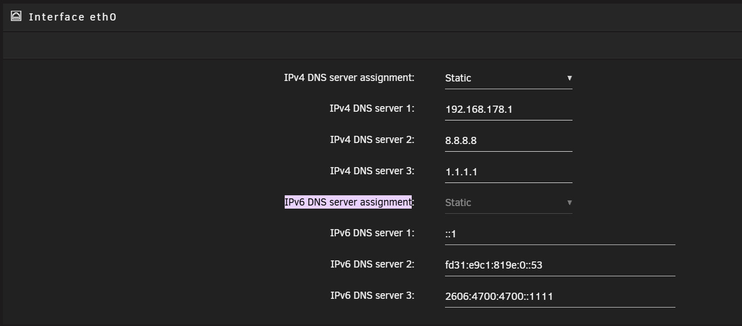

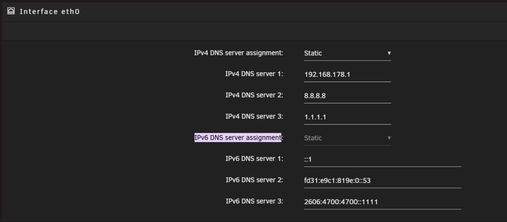

Sorry please for beginners. Where to add those then? I'm already annoyed because since I activated IPv6 my internal AdGuardHome redirections stopped working properly...
Matter x Docker doesn't work

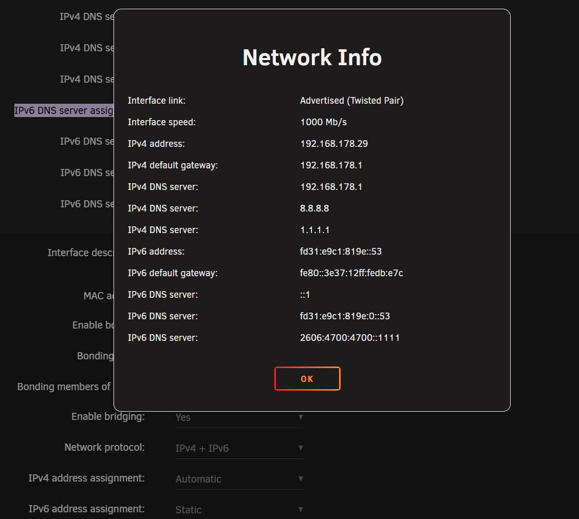

Sorry for coming back to this old topic, but I'm in the same situation. With this post I realized that I even had no IPv6 DNS server in unRAID because my router (FritzBox) had IPv6 not correctly enabled. But I have the same problem. I don't get any errors if I run the matter-server container on br0 but on host it won't work. Where or how to set sysctl -w net.ipv6.conf.all.forwarding=1? Didn't work for the container. My docker settings:
