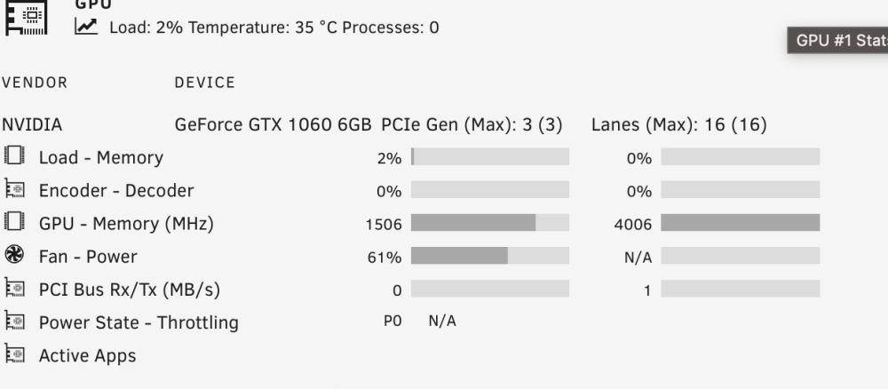

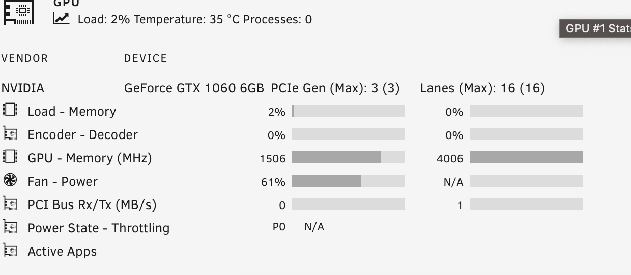

  4. Hi, I'm attaching a screenshot, as you can observe Power is N/A and Throttling is also N/A with the new Nvidia driver.

  10. Hi, This is the result: nvidia-smi -q -x -g 0 | grep -a power <clocks_event_reason_sw_power_cap>Not Active</clocks_event_reason_sw_power_cap> <clocks_event_reason_hw_power_brake_slowdown>Not Active</clocks_event_reason_hw_power_brake_slowdown> <gpu_power_readings> <power_state>P0</power_state> <power_draw>26.89 W</power_draw> <current_power_limit>120.00 W</current_power_limit> <requested_power_limit>120.00 W</requested_power_limit> <default_power_limit>120.00 W</default_power_limit> <min_power_limit>60.00 W</min_power_limit> <max_power_limit>140.00 W</max_power_limit> </gpu_power_readings> <module_power_readings> <power_state>P0</power_state> <power_draw>N/A</power_draw> <current_power_limit>N/A</current_power_limit> <requested_power_limit>N/A</requested_power_limit> <default_power_limit>N/A</default_power_limit> <min_power_limit>N/A</min_power_limit> <max_power_limit>N/A</max_power_limit> </module_power_readings> Kind regards,
  11. Hi, After installing 23-06-09 the Power Draw shows N/A, I have a Nvidia Gforce GTX-1060 and nvidia-smi shows the power correctly. Any suggestion? Kind regards, Vicent
