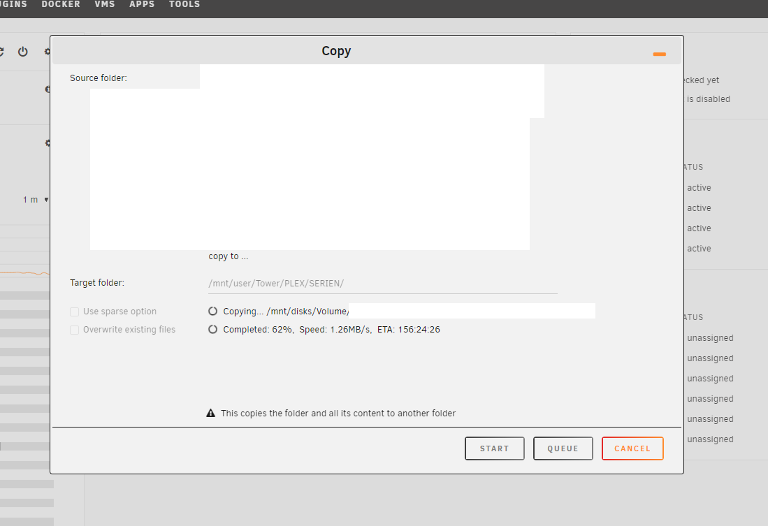

  1. Now i have tried plugging in my External Drive via USB to the Server and copy it then to the array (User Share) It was very fast for around 3 Hours and now i'm copying with ca 600kbps.

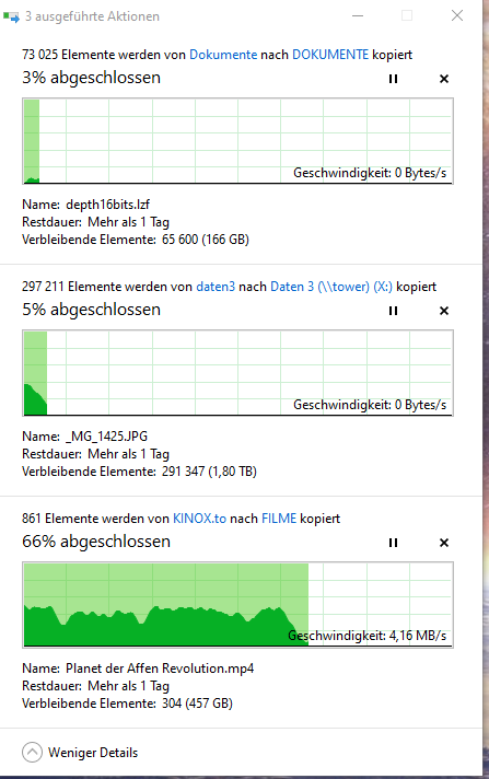

  2. I have tried as you said a disk share to only drive 3 (CMR) which works perfectly fine i get like 100Mbis read/write (limitet through ethernet). Then i tried a disk share to Drive 2 (SMR) and it also worked like drive 3. Only when i write to the array of drives then it doesnt work see the first picture. Sometime transferspeed is good then after like 10minutes it drops to 0.
  3. also disk 1 is perfectly fine with copy speeds
  4. So i Have tried to copy direct to disk 3 and it works perfectly. I also tried to disk 2 (8TB) and it works aswell Why is it not working when i'm writing to the array?
  5. This does not help me out. I need to transfer about 12 TB of Data and Disk 3 is only 3TB

  8. Hello everyone, i have set up a fresh install of Unraid with an array of 4 Drives+1Parity+1Cache. I also have a 1Gbs connection to the server, but after like 15 minutes i get non measurble transfer speeds like shown in picture down below. I have also tried without parity drive, without cache, other system also same issue. Also Turbo Write doesnt change a thing. No dockers are running just file transfer from a Win10 Machine. Sys Log files are also down below. Please HELP me i dont know what is wrong with my server. tower-diagnostics-20230520-1907.zip
  9. Thanks for the answers, i am Using SMB over the local Network 1000Mbit/s
