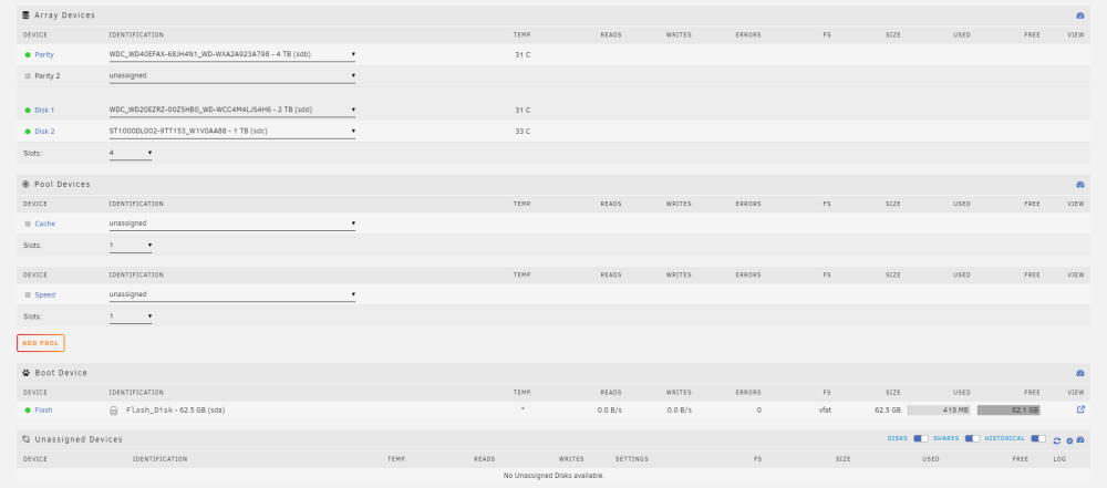

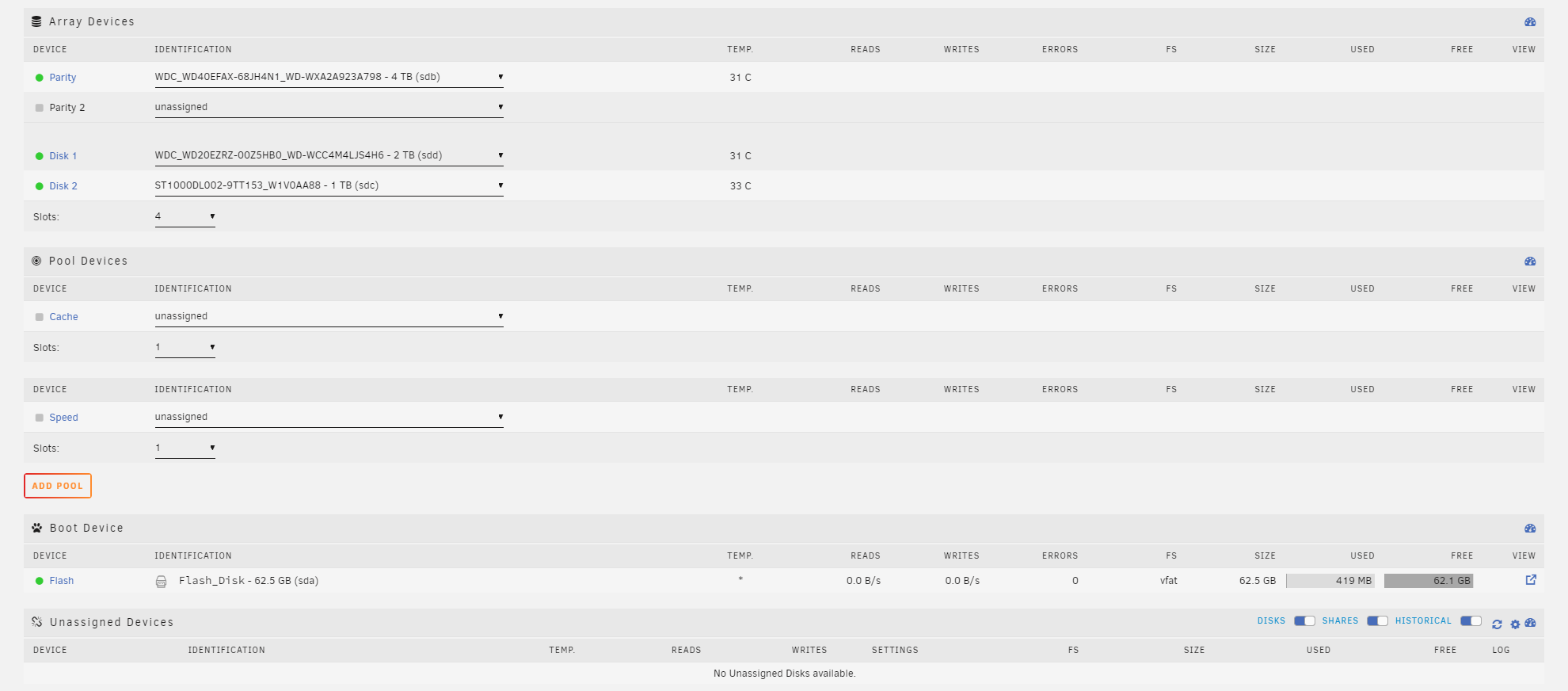

  7. Résolu : c'est le SSD M2 qui était mal fixé !

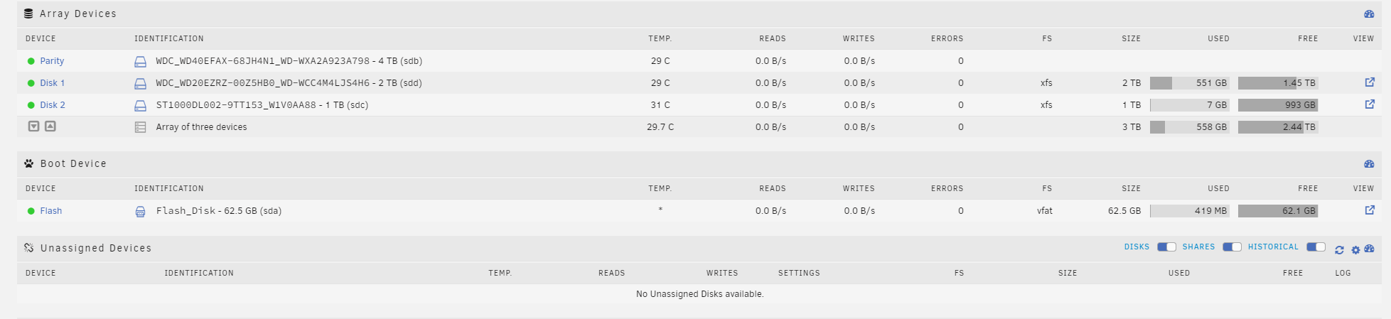

  9. Oh that's way out of my league I don't know how to do this therefore I think my cache SSD is now gone for good. Too bad since I thought that Unraid was a stable OS and now I am facing a massive fail. It all just started from a plex update that escaladated.

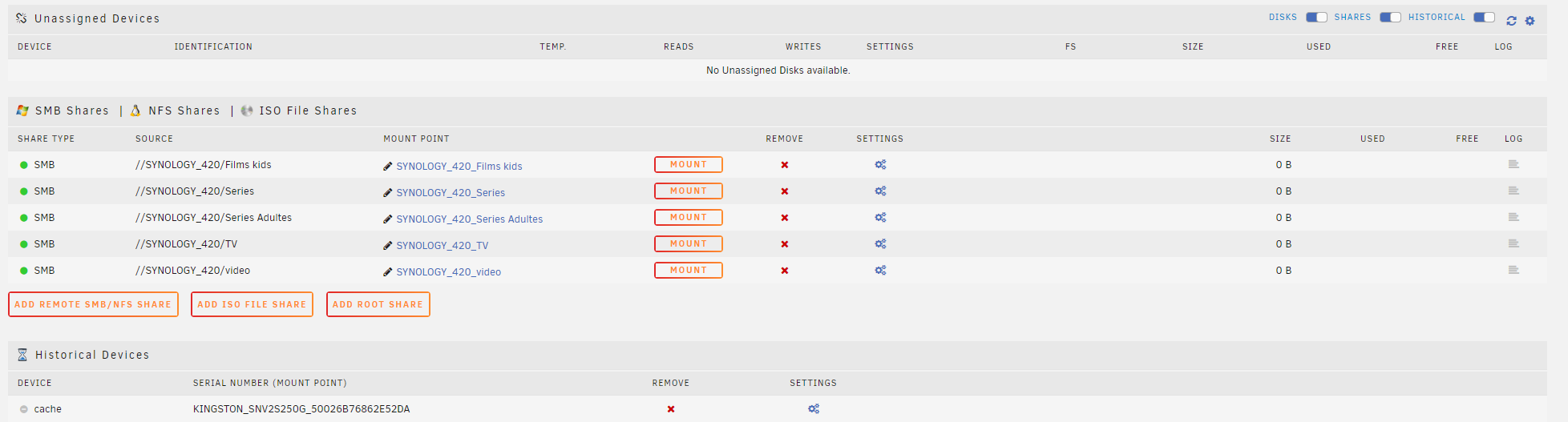

  10. I rebooted it but SSD is still MIA doesn't it ? No identification...
  11. Since I updated UD it can't show any disk anymore. My cache SSD is MIA, so are the mounting points from my synology shares... To sum it up : my UD is blind. Any ideas ?
  12. Tant mieux pour toi mais je cherchais une réponse pour le faire fonctionner à nouveau...
