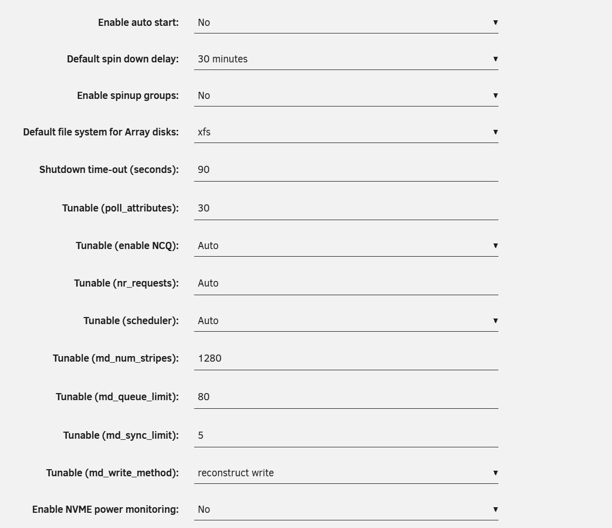

  5. No, that's not what happens. The array will never stop. It gets hung up and will sit there for a zillion hours, stuck. SSD is inaccessible as well.
  6. It never hits this timer. It gets stuck waiting for something...and I think it has to do with closing files as "shutdown -f" works.
  7. I get that...the issue is what does Unraid expect that it's not getting from the array (inside the usb enclosure) when trying to shut it down? And, is that something I can configure in Unraid so it doesn't get stuck looking for it?

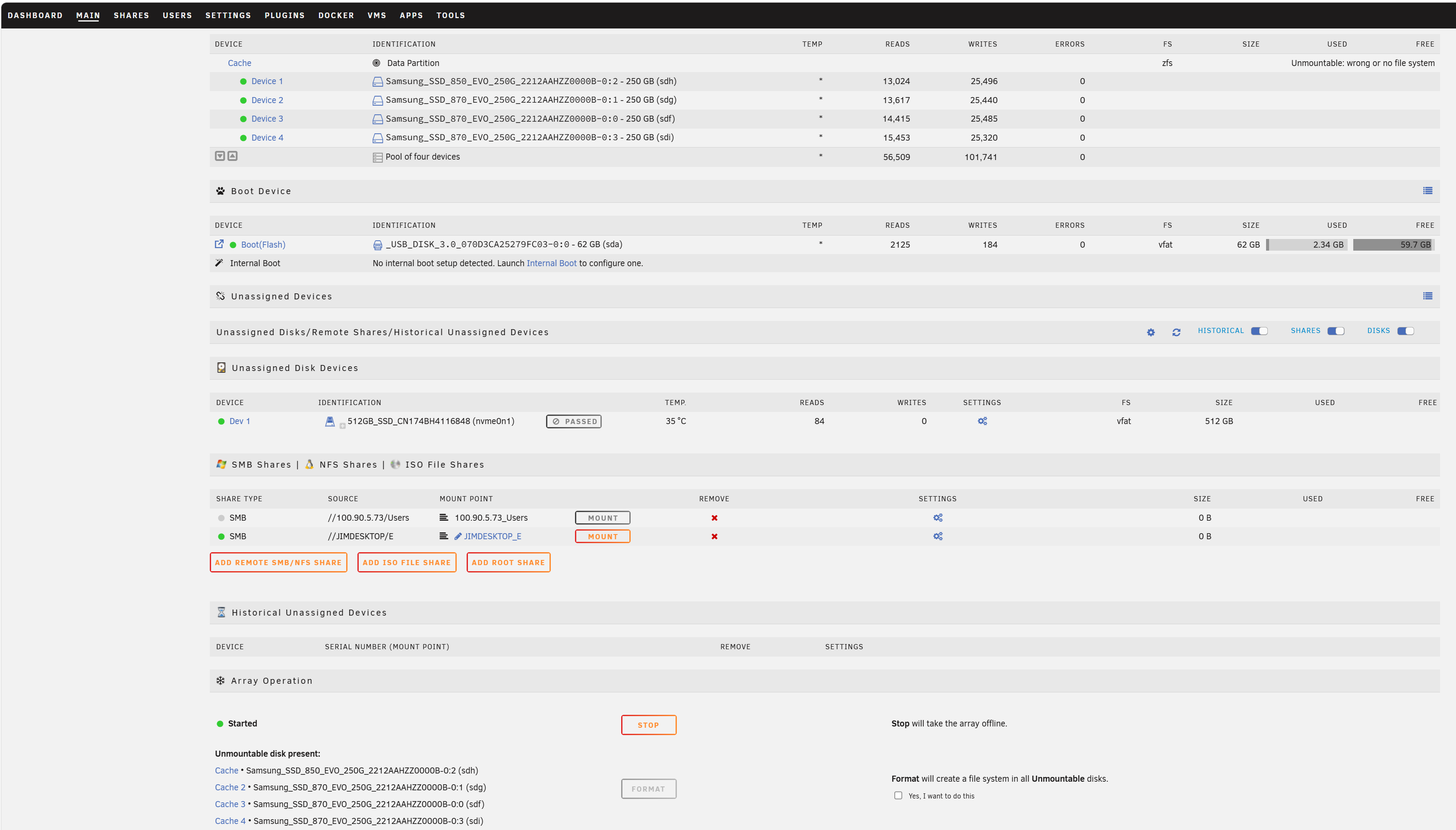

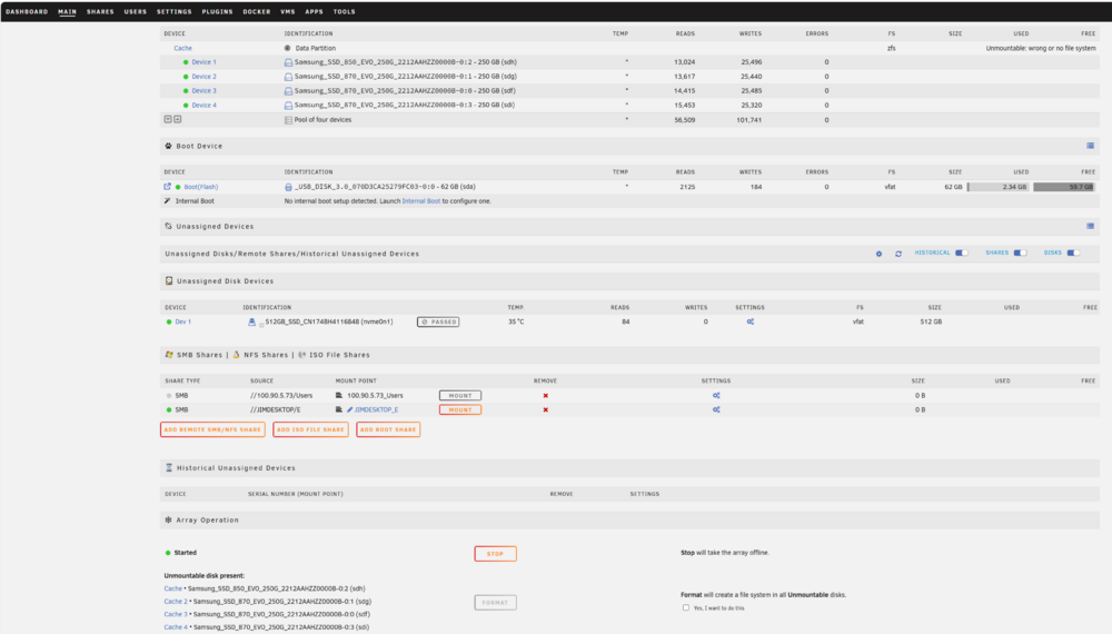

  12. mini12-diagnostics-20260105-1332.zip These diagnostics were done after trying to add the 4th cache disk and I got the "wrong pool state" error.
  13. I currently have a 3-ssd zfs cache living in a 4-bay usb Orico ssd enclosure. It works perfectly and has been for over a year. I decided to try to expand the cache pool to 4 disks using the new zfs 7.2.3 expansion functionality. I can add the 4th disk (it shows up as an unassigned disk as it should). I can change the pool size from 3 to 4 and assign the 4th ssd. The existing 3 ssds stay green dots, with the new fourth ssd with a blue dot. It says nothing about formatting or losing data. I try to start the array and I immediately get the "wrong pool state" error. Is there some kind of limit going to 4 disks? The example video only goes from 2 to 3 disks. Or, perhaps there is something else going on. Thanks in advance for any help.

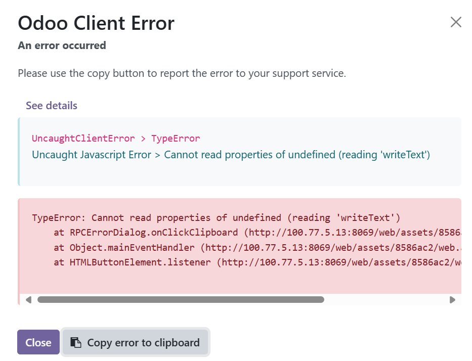

  14. NexusEFR, I think you may be right about getting support. Last night, there was an Odoo17 update which "broke" Odoo. Specifically, it broke the Dashboards. As near as I can tell, the dashboard is the only thing that got broken. The error message is attached below. Of course, I have no idea how to fix this. Any ideas with respect to getting support for these types of problems?
