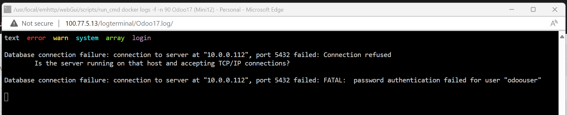

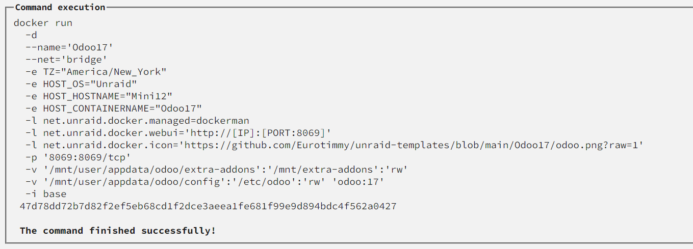

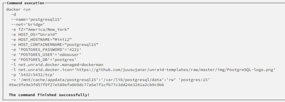

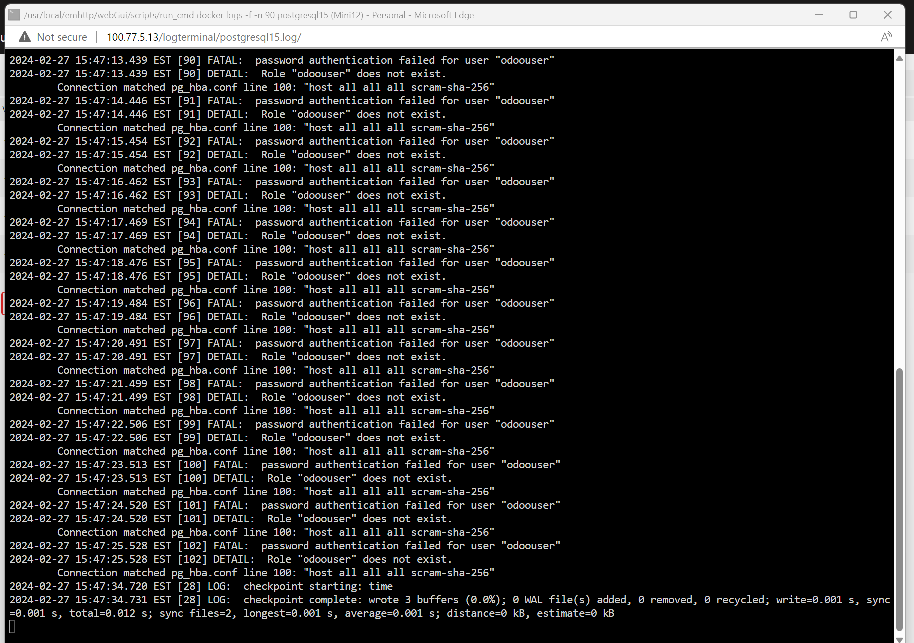

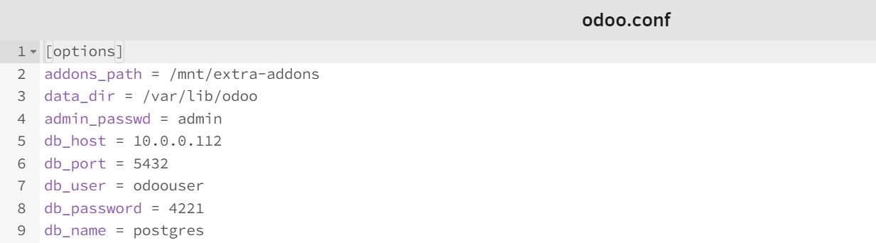

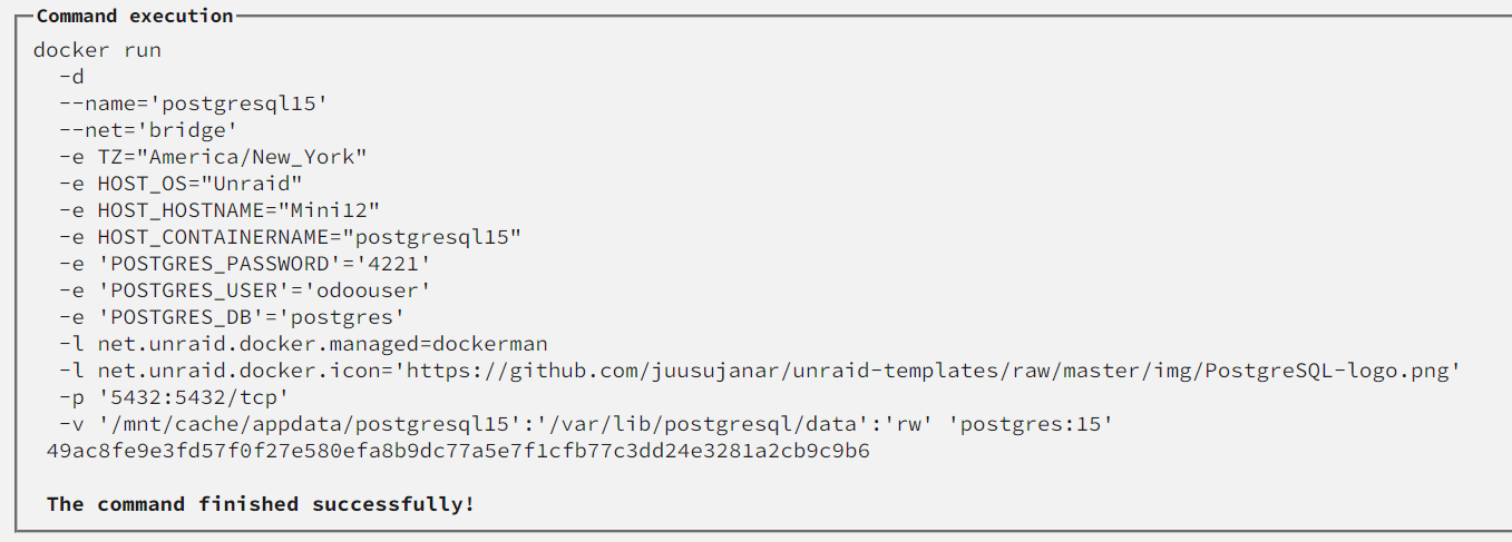

I too am having trouble getting Odoo to start. I've followed the template instructions but I'm getting logfile error messages - which I'm guessing are permissions issues. Here's the Odoo docker config: Here's the Postgresql15 docker config: Here's the Odoo config file: And here's the log files from Odoo and Postgresql15, respectively. It doesn't seem to recognize the user "odoouser". However, it is set up as an Unraid user as well as in the docker/config files. Any help would be appreciated.

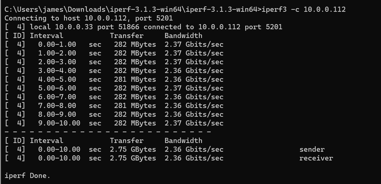

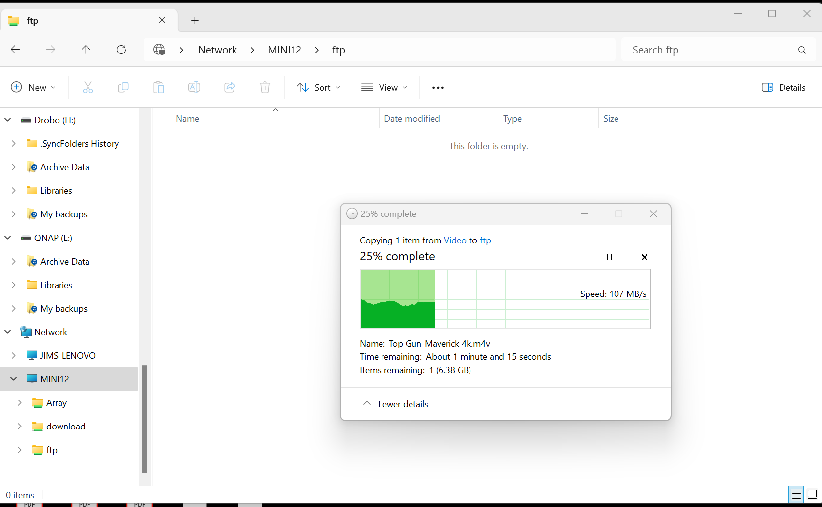

I downloaded iperf3 on my main Windows pc and tested it writing to the Unraid mini pc server. The Unraid mini pc server is 10.0.0.112, the main Windows pc is 10.0.0.33. Here's the result: This appears to me that the network is running at 2.5 gb. However, below is a screenshot transferring a 9 gb file via Windows 11 copy/paste from the main pc to the Unraid server (MINI12): You can see this is only running at 1.0 gb. I did not go through the trouble of hooking up a keyboard and monitor and rebooting the Unraid mini pc to Windows 11 and then copying a file to it. But, having done it many times, it would have shown the transfer taking place at the 2.5 gb speed. As I said in my original post, transferring files from my main pc to the mini pc Unraid server did work at 2.5 gb speed for about a month, then stopped and now only runs at 1.0 gb speed. I'm still looking for help.
