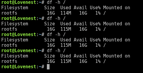

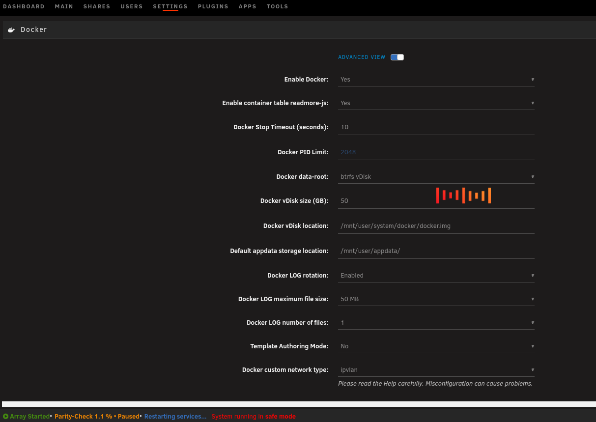

  7. So.. I paused the parity check, and tried to start docker. The screenshot below is what I see once I hit apply to start docker and it just sits there forever (I left it last night and it was the same when I got back home this evening.) I can refresh the page, and it will say that docker is stopped, but the docker tab shows up in the webui and shows "docker service failed to start". The cli shot is one before I did anything and then two while docker "was starting" and then one after I refreshed the page.

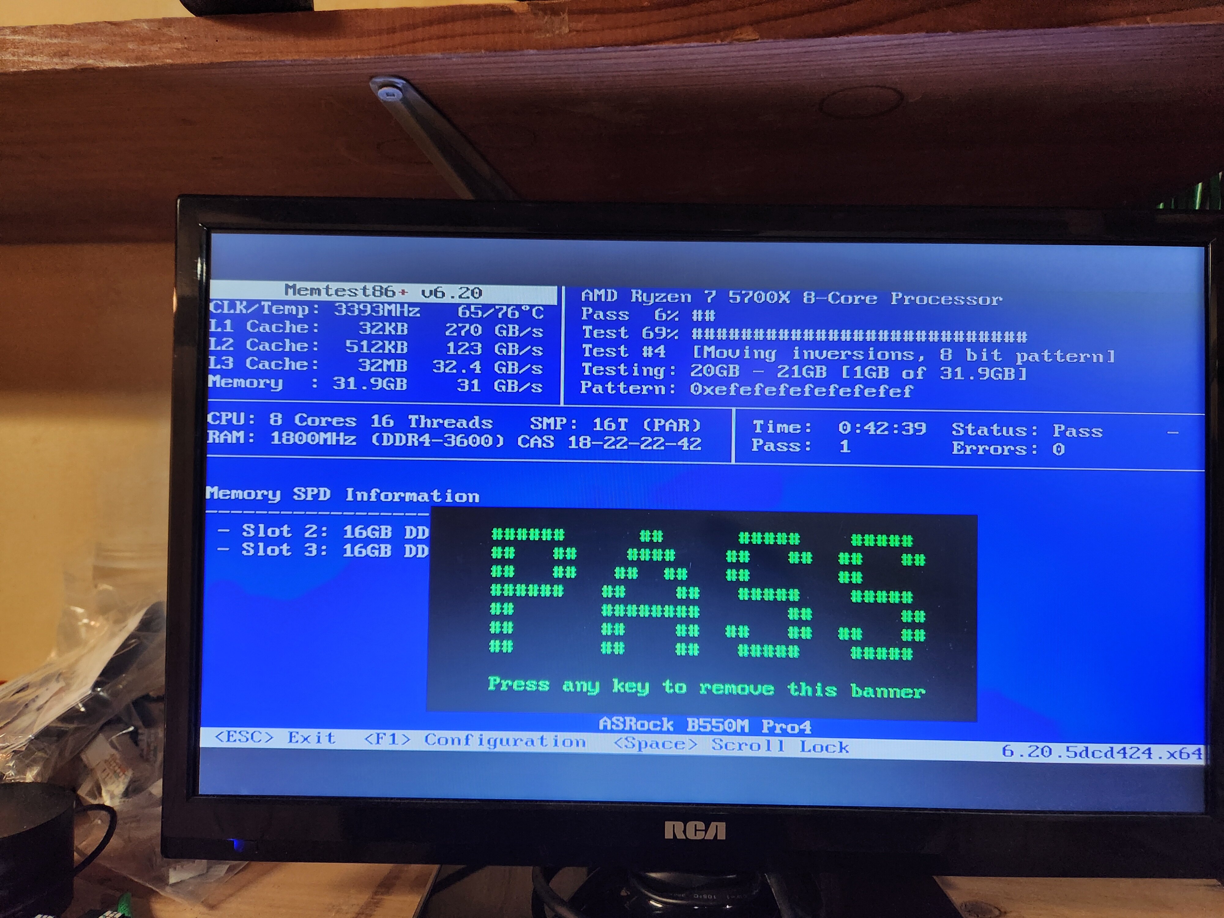

  14. Alright, so here's where I stand, I ran memtest on all the sticks, found a dead one and in the process of RMA. Installed two of the good sticks and started up. It booted fine as before, but still hangs/kills the web UI when I try to access the VM's tab or VM settings. If I don't navigate away from the dashboard, I can still see all the information (RAM/CPU usage, network graph) updating as it should. It's even showing the parity % working at the bottom. If I try to navigate away from the dashboard the pages won't load, also tried to SSH, and I can access it, but running any commands hang.
