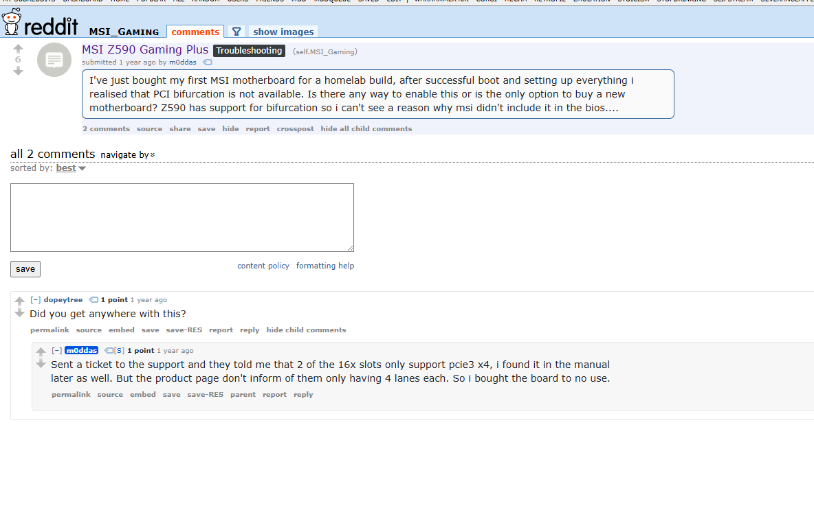

  3. Main card is an IBM LSI ServeRaid M1015 (IT Mode flashed) and an Intel RES2SV240NC expander card.

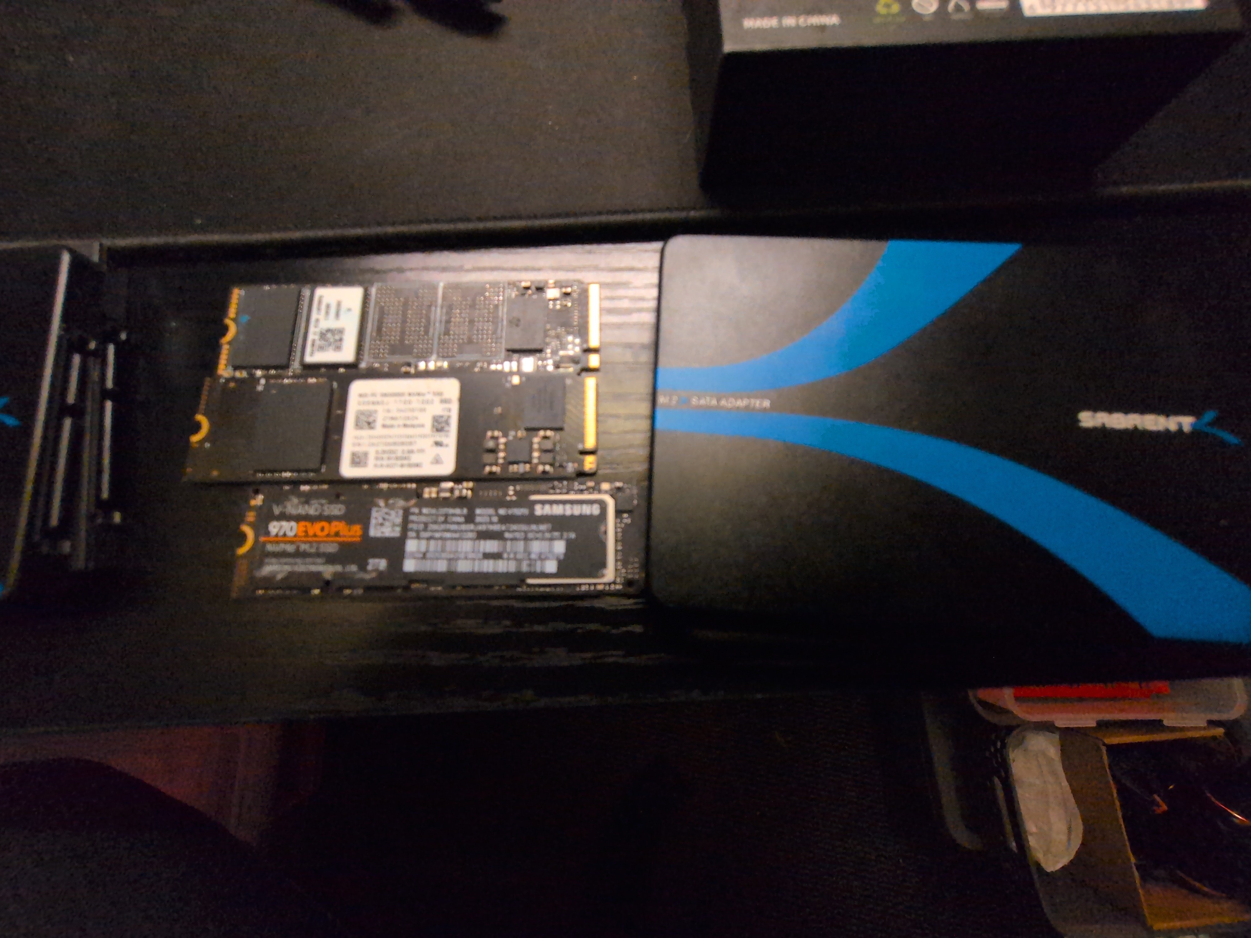

  4. https://www.amazon.co.uk/gp/aw/d/B01N6PMZLW?psc=1&ref=ppx_pop_mob_b_asin_image&th=1 Bought 3 of these, stuck some 500gb nvmes in, hooked up, sata to sas cables in my Intel sas splitter, sata powered, drives don't show up anywhere in Unraid - tried wiping / cleaning the drives first in different ways, Unraid still just doesn't see them at all. Have 4x unsealed sata to sas cables and tried two different ones, no cigar. Are the enclosures the wrong type? Should I return them for a different enclosure? Motherboard only has two nvme slots and I have about 6 nvmes that I'd like to use (obviously transfer speed won't be max possible but that's irrelevant for the intended use) Thanks, Para

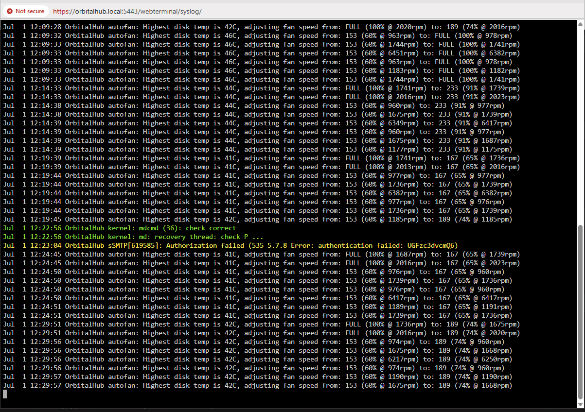

  5. My Psu might be dying that's my best guess but maybe there's something in the diagnostics someone can see. Thanks. orbitalhub-diagnostics-20250813-2108.zip
  6. smtp tells me it was an email thing in unraid but I deliberately had it try to send me a test email using the wrong password and didn't get anything like this come up.

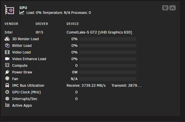

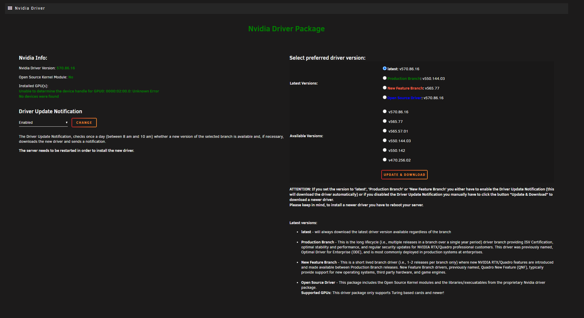

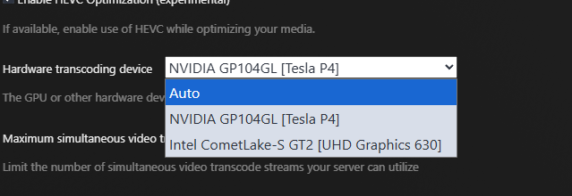

  7. I can post it now, I haven't rebooted since because i'm currently parity syncing, the plex thumbnail generator is still running, etc. I'll edit this in a min. orbitalhub-diagnostics-20250701-2236.zip

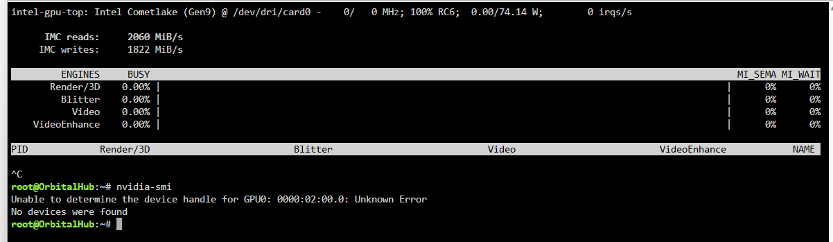

  8. I'm having a weird bug where on boot my GPU is found fine, but then I go check later and it says Installed GPU(s): No devices were found However Plex can see it; And plex thumbnail generator script that uses the GPU is running right now. There was nothing on the gpu stats dashboard plugin panel, until I selected the igpu; nvidia smi; Right now I am on v575.51.02 because I started from the latest (didn't detect on bootup) and went backwards until I found one that worked, but then it disappeared like this again, and I went back even more. What has happened recently to cause people so many problems?
  9. I had to drop down to using the previous version in order for it to be able to see my Tesla P4. The official previous version. On the latest version of unraid. Or did they fix it after the second recent update?
  10. Does it ask for a password on the web UI or do you need access to the server and plug a scren in?
  11. Ah crap, well, thank you for investigating and figuring it out. I filled that card with 2x 500gb and 2x 1tb drives planned to use for cache and dedicated plex pool. So.. New motherboard? Since I'll also need a CPU, as well as DDR5 ram, unless there's a DDR4 board I could find on ebay that is sufficient(suggestions?), I can't really spend that much, and won't be able to recoup a whole lot from the existing stuff CPU is Intel® Core™ i7-10700K CPU @ 3.80GHz With 64gb ram. A higher gen CPU would let me use the top M2 slot on any board, too, so consider that with any suggestions please. As for the specs I need well, just this is what I'm missing really. Everything else works / is sufficient for my needs.
  12. Thanks. IT's an MPG Z590 GAMING FORCE In the top slot I have my IBM ServeRaid card, second slot is my Tesla P4, next one down in the small slot I have a wifi on/off switch, and I put it on the bottom one. If I swapped it with the slot the Tesla P4 is in, would I be able to use it fully and still retain ability to use the tesla p4?
