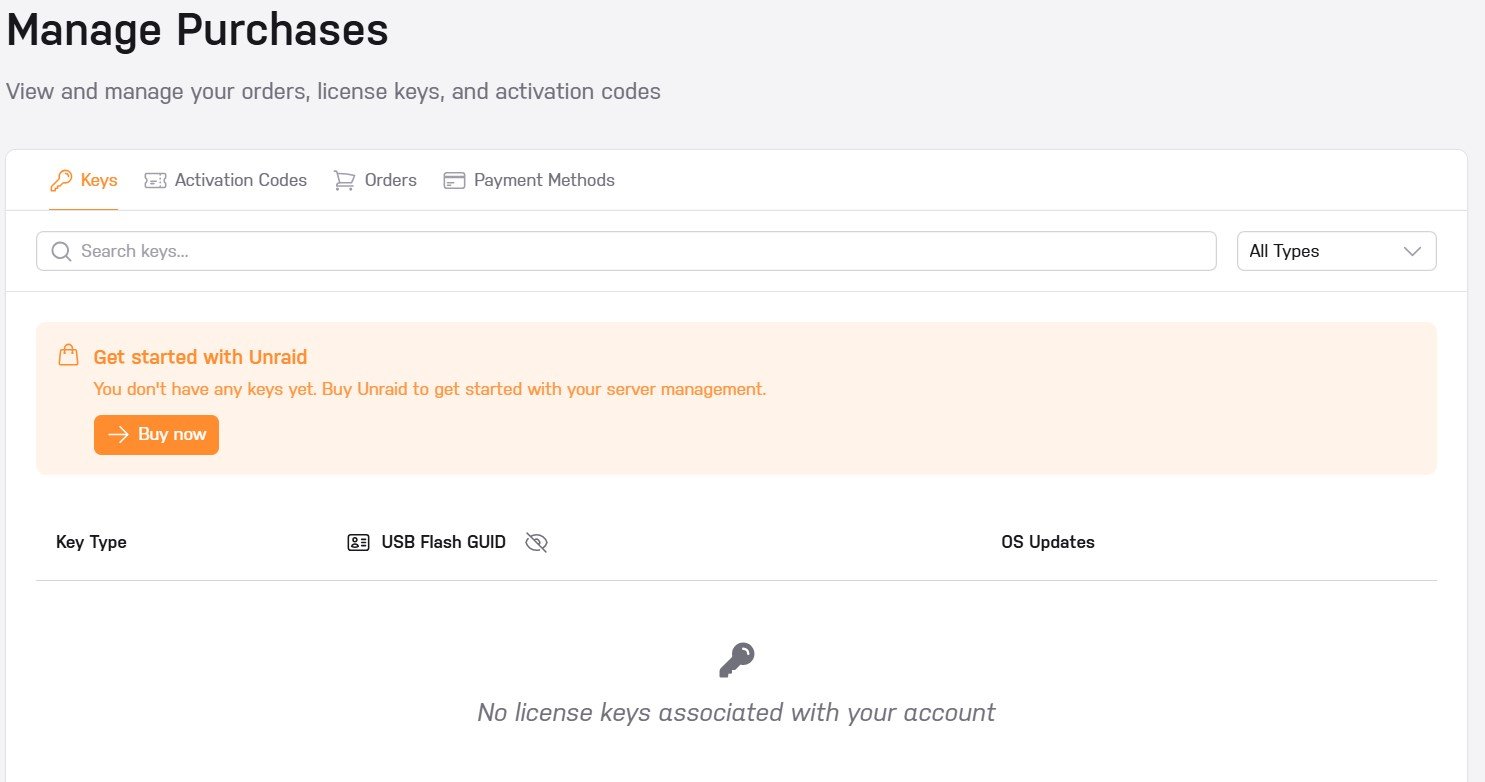

Rebuilding New USB-Flash-Drive but No License Key Associated With My Account.
Hello ! I am trying to rebuild a new flash drive from my Unraid Connect ID. I know I had my Unraid account connected and backed them up. But now I don't see any keys associated with my account. Am I doing something wrong ? I do have a local copy of the flash drive backed up but I don't think without the associated keys it would do any good to me. What is it am not getting ?

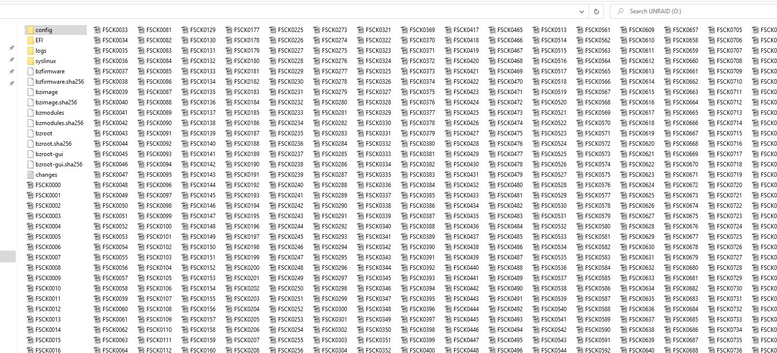

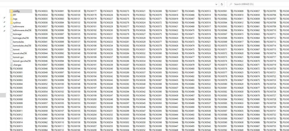

Unknown files on Usb Flash Drive. Server not booting (no Webgui)

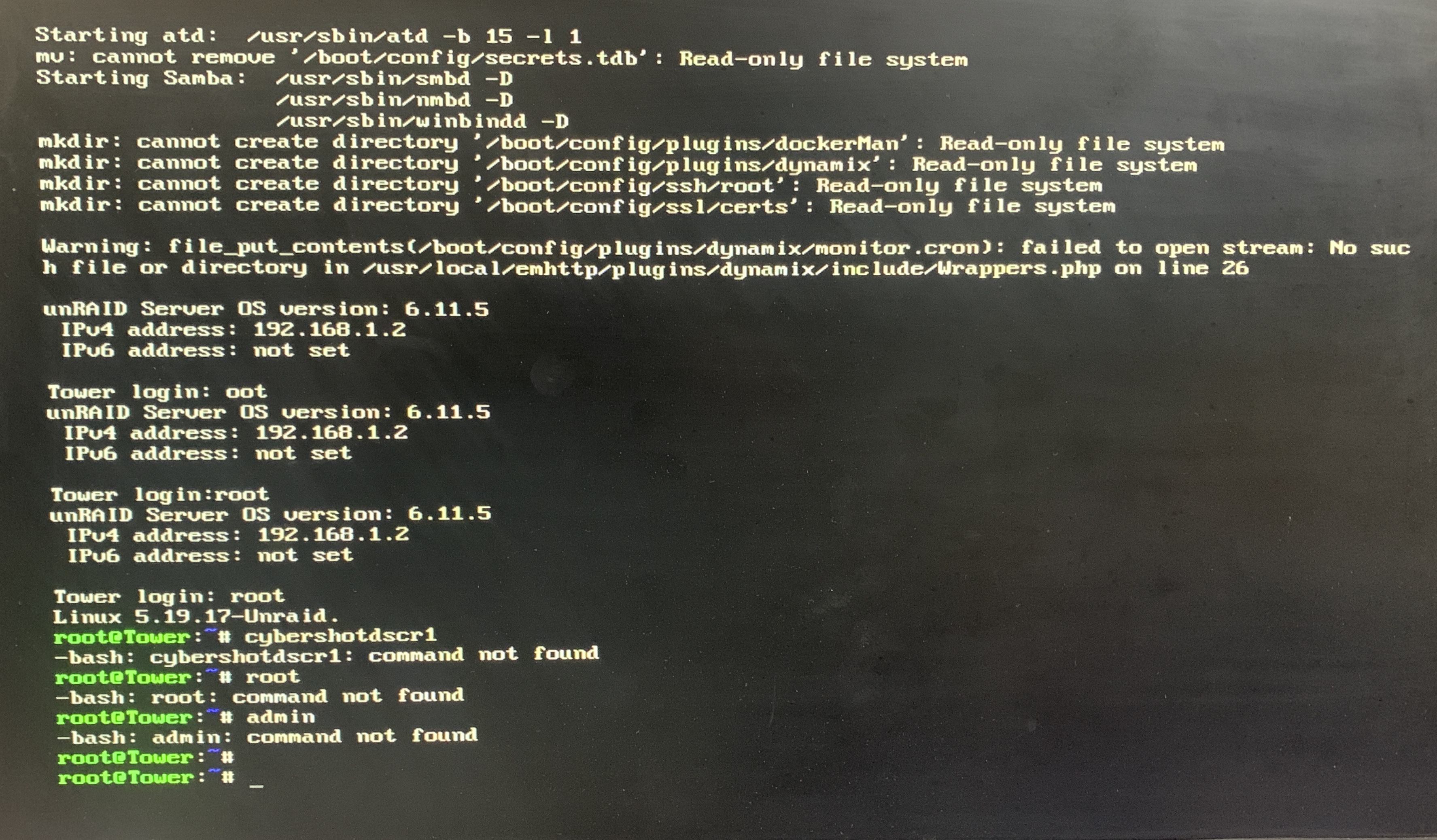

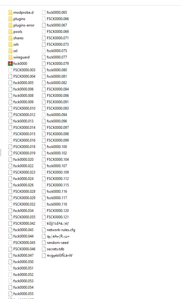

I have connected an LCD with the server and tried booting it again but I am guessing the bootable system is broken. if this is likely, how can I restore the flash usb. Is it even possible to install via the same flash drive ? Should I just format the flash drive and manual install Unraid ?
The USB Drive Is new. I used this for trial version for a few days before buying the basic key just a three days ago.

Hi, I am running 6.11.5 on HP Z820. First time user, its only been a week now. The server had a few unclean shut downs due to faulty PSU but parity was valid (I hope it still is). Today I attached an external USB disk for data transfer using SpaceInvader’s "krusader" guide (Part 2 of a 4 part series). While transferring the data a notification about the same external drive getting hot popped but I couldn’t see for much long (only that the disk was at 47C which shouldn’t be too hot for an external disk) before the server shutdown. After disconnecting the drive I tried booting the server again but it never booted. After a couple failed attempts I took the Unraid USB flash and inserted in Windows 10 just to have look and I found that the 16 GB USB FLASH drive is full of unknown files or at least unknown to me. Have no idea what are those. As I said earlier first time user and have no Linux or command line experience so please go easy on me. I am attaching the diagnostic file found on the USB which is from a couple a days ago. But the interesting thing is the presence of unknown files in USB I don’t know what are these but I am attaching screen shot My sole method of connecting to the Unraid is webgui through Windows 10 machine but it no longer works. So don’t know what to do next. tower-diagnostics-20230528-1600.zip

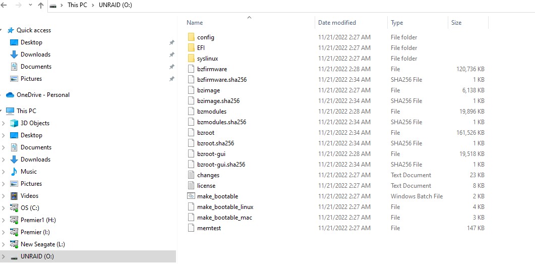

Can't find USB 2.0 Flash Drive in 2023.
Now that the bootable flash drive with free trial is ready I hope, I am wondering what would be the first thing to do after first boot. I mean ,the flash creator utility helps in setting up server name and DHCP etc and I have been so narrow on using this utilitly that havent looked elsewhere. Whats booting like after manual install method ? I am hoping to set it up once server is ready at the shop but the remaining of the stuff like pretesting drives and transfer of data is going to be where the server is going to live for the rest of its life. So any advice for me guys ?
This worked. The root or top level of the flash drive now has more files showing. I ran the script for making bootable. Hope thats it. Thanks a bunch guys.
