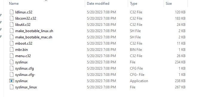

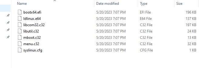

Hi, I am running 6.11.5 on HP Z820. First time user, its only been a week now. The server had a few unclean shut downs due to faulty PSU but parity was valid (I hope it still is). Today I attached an external USB disk for data transfer using SpaceInvader’s "krusader" guide (Part 2 of a 4 part series). While transferring the data a notification about the same external drive getting hot popped but I couldn’t see for much long (only that the disk was at 47C which shouldn’t be too hot for an external disk) before the server shutdown. After disconnecting the drive I tried booting the server again but it never booted. After a couple failed attempts I took the Unraid USB flash and inserted in Windows 10 just to have look and I found that the 16 GB USB FLASH drive is full of unknown files or at least unknown to me. Have no idea what are those. As I said earlier first time user and have no Linux or command line experience so please go easy on me. I am attaching the diagnostic file found on the USB which is from a couple a days ago. But the interesting thing is the presence of unknown files in USB I don’t know what are these but I am attaching screen shot My sole method of connecting to the Unraid is webgui through Windows 10 machine but it no longer works. So don’t know what to do next. tower-diagnostics-20230528-1600.zip

This worked. The root or top level of the flash drive now has more files showing. I ran the script for making bootable. Hope thats it. Thanks a bunch guys.
Can't find USB 2.0 Flash Drive in 2023.
Hi, Thanks for your reply. There were actually none. just two folders. Oh great. Wish I had known this yesterday. Thank you again.
