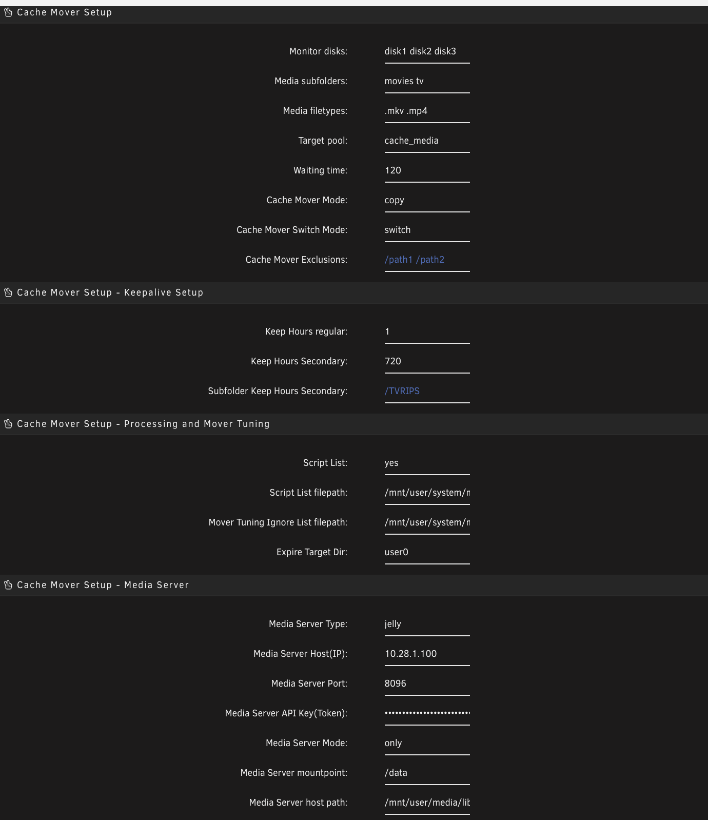

  5. Yes, I believe I have all the Cache Mover settings correct. See image. Here's my Jellyfin docker volumes: /data <--> /mnt/user/media/library /config <--> /mnt/user/appdata/jellyfin Cache Mover copies the movie file to cache_media, but Jellyfin does not "switch" to the pool, instead it continues to read from the array.

  8. understood - thank you. Odd it was working exactly as intended last weekend though. I did testing with you on January 13 related and my logs all have movies with bracketed names. I have not changed any Cache Mover settings since then. See attached image. Correct, there was a trailing slash, I just removed it and applied change. But again, it was like that last weekend, too.

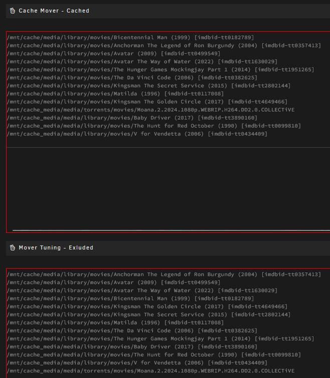

  10. Can confirm - setting to "only" mode does not move the files to the cache pool when Jellyfin is generating Trickplay. Thank you! Hope this helps someone else!
  11. Terminal command did not work. I will add that yesterday during a system hardware upgrade, I renamed the the cache pool "cache" to "cache_media" Jan 13 23:57:42 Vault root: cache-cleaner: find: ‘/mnt/cache/media/library/movies/Bicentennial Man (1999) [imdbid-tt0182789]/’: No such file or directory Jan 13 23:57:42 Vault root: cache-cleaner: /mnt/cache/media/library/movies/Bicentennial Man (1999) [imdbid-tt0182789] is not there Jan 13 23:57:42 Vault root: cache-cleaner: find: ‘/mnt/cache/media/library/movies/Anchorman The Legend of Ron Burgundy (2004) [imdbid-tt0357413]/’: No such file or directory Jan 13 23:57:42 Vault root: cache-cleaner: /mnt/cache/media/library/movies/Anchorman The Legend of Ron Burgundy (2004) [imdbid-tt0357413] is not there Jan 13 23:57:42 Vault root: cache-cleaner: find: ‘/mnt/cache/media/library/movies/Avatar (2009) [imdbid-tt0499549]/’: No such file or directory Jan 13 23:57:42 Vault root: cache-cleaner: /mnt/cache/media/library/movies/Avatar (2009) [imdbid-tt0499549] is not there Jan 13 23:57:42 Vault root: cache-cleaner: find: ‘/mnt/cache/media/library/movies/Avatar The Way of Water (2022) [imdbid-tt1630029]/’: No such file or directory Jan 13 23:57:42 Vault root: cache-cleaner: /mnt/cache/media/library/movies/Avatar The Way of Water (2022) [imdbid-tt1630029] is not there Jan 13 23:57:42 Vault root: cache-cleaner: find: ‘/mnt/cache/media/library/movies/The Hunger Games Mockingjay Part 1 (2014) [imdbid-tt1951265]/’: No such file or directory Jan 13 23:57:42 Vault root: cache-cleaner: /mnt/cache/media/library/movies/The Hunger Games Mockingjay Part 1 (2014) [imdbid-tt1951265] is not there Jan 13 23:57:42 Vault root: cache-cleaner: find: ‘/mnt/cache/media/library/movies/The Da Vinci Code (2006) [imdbid-tt0382625]/’: No such file or directory Jan 13 23:57:42 Vault root: cache-cleaner: /mnt/cache/media/library/movies/The Da Vinci Code (2006) [imdbid-tt0382625] is not there Jan 13 23:57:42 Vault root: cache-cleaner: find: ‘/mnt/cache/media/library/movies/Kingsman The Secret Service (2015) [imdbid-tt2802144]/’: No such file or directory Jan 13 23:57:42 Vault root: cache-cleaner: /mnt/cache/media/library/movies/Kingsman The Secret Service (2015) [imdbid-tt2802144] is not there Jan 13 23:57:42 Vault root: cache-cleaner: find: ‘/mnt/cache/media/library/movies/Matilda (1996) [imdbid-tt0117008]/’: No such file or directory Jan 13 23:57:42 Vault root: cache-cleaner: /mnt/cache/media/library/movies/Matilda (1996) [imdbid-tt0117008] is not there Jan 13 23:57:42 Vault root: cache-cleaner: find: ‘/mnt/cache/media/library/movies/Kingsman The Golden Circle (2017) [imdbid-tt4649466]/’: No such file or directory Jan 13 23:57:42 Vault root: cache-cleaner: /mnt/cache/media/library/movies/Kingsman The Golden Circle (2017) [imdbid-tt4649466] is not there Jan 13 23:57:42 Vault root: cache-cleaner: /mnt/cache_media/media/torrents/movies/Moana.2.2024.1080p.WEBRIP.H264.DD2.0.COLLECTiVE 30 still in range Jan 13 23:57:42 Vault root: cache-cleaner: find: ‘/mnt/cache_media/media/library/movies/Baby Driver (2017) [imdbid-tt3890160]/’: No such file or directory Jan 13 23:57:42 Vault root: cache-cleaner: /mnt/cache_media/media/library/movies/Baby Driver (2017) [imdbid-tt3890160] is not there Jan 13 23:57:42 Vault root: cache-cleaner: find: ‘/mnt/cache_media/media/library/movies/The Hunt for Red October (1990) [imdbid-tt0099810]/’: No such file or directory Jan 13 23:57:42 Vault root: cache-cleaner: /mnt/cache_media/media/library/movies/The Hunt for Red October (1990) [imdbid-tt0099810] is not there Jan 13 23:57:42 Vault root: cache-cleaner: find: ‘/mnt/cache_media/media/library/movies/V for Vendetta (2006) [imdbid-tt0434409]/’: No such file or directory Jan 13 23:57:42 Vault root: cache-cleaner: /mnt/cache_media/media/library/movies/V for Vendetta (2006) [imdbid-tt0434409] is not there Jan 13 23:58:41 Vault root: cache-cleaner: find: ‘/mnt/cache/media/library/movies/Bicentennial Man (1999) [imdbid-tt0182789]/’: No such file or directory Jan 13 23:58:41 Vault root: cache-cleaner: /mnt/cache/media/library/movies/Bicentennial Man (1999) [imdbid-tt0182789] is not there Jan 13 23:58:41 Vault root: cache-cleaner: find: ‘/mnt/cache/media/library/movies/Anchorman The Legend of Ron Burgundy (2004) [imdbid-tt0357413]/’: No such file or directory Jan 13 23:58:41 Vault root: cache-cleaner: /mnt/cache/media/library/movies/Anchorman The Legend of Ron Burgundy (2004) [imdbid-tt0357413] is not there Jan 13 23:58:41 Vault root: cache-cleaner: find: ‘/mnt/cache/media/library/movies/Avatar (2009) [imdbid-tt0499549]/’: No such file or directory Jan 13 23:58:41 Vault root: cache-cleaner: /mnt/cache/media/library/movies/Avatar (2009) [imdbid-tt0499549] is not there Jan 13 23:58:41 Vault root: cache-cleaner: find: ‘/mnt/cache/media/library/movies/Avatar The Way of Water (2022) [imdbid-tt1630029]/’: No such file or directory Jan 13 23:58:41 Vault root: cache-cleaner: /mnt/cache/media/library/movies/Avatar The Way of Water (2022) [imdbid-tt1630029] is not there Jan 13 23:58:41 Vault root: cache-cleaner: find: ‘/mnt/cache/media/library/movies/The Hunger Games Mockingjay Part 1 (2014) [imdbid-tt1951265]/’: No such file or directory Jan 13 23:58:41 Vault root: cache-cleaner: /mnt/cache/media/library/movies/The Hunger Games Mockingjay Part 1 (2014) [imdbid-tt1951265] is not there Jan 13 23:58:41 Vault root: cache-cleaner: find: ‘/mnt/cache/media/library/movies/The Da Vinci Code (2006) [imdbid-tt0382625]/’: No such file or directory Jan 13 23:58:41 Vault root: cache-cleaner: /mnt/cache/media/library/movies/The Da Vinci Code (2006) [imdbid-tt0382625] is not there Jan 13 23:58:41 Vault root: cache-cleaner: find: ‘/mnt/cache/media/library/movies/Kingsman The Secret Service (2015) [imdbid-tt2802144]/’: No such file or directory Jan 13 23:58:41 Vault root: cache-cleaner: /mnt/cache/media/library/movies/Kingsman The Secret Service (2015) [imdbid-tt2802144] is not there Jan 13 23:58:41 Vault root: cache-cleaner: find: ‘/mnt/cache/media/library/movies/Matilda (1996) [imdbid-tt0117008]/’: No such file or directory Jan 13 23:58:41 Vault root: cache-cleaner: /mnt/cache/media/library/movies/Matilda (1996) [imdbid-tt0117008] is not there Jan 13 23:58:41 Vault root: cache-cleaner: find: ‘/mnt/cache/media/library/movies/Kingsman The Golden Circle (2017) [imdbid-tt4649466]/’: No such file or directory Jan 13 23:58:41 Vault root: cache-cleaner: /mnt/cache/media/library/movies/Kingsman The Golden Circle (2017) [imdbid-tt4649466] is not there Jan 13 23:58:41 Vault root: cache-cleaner: /mnt/cache_media/media/torrents/movies/Moana.2.2024.1080p.WEBRIP.H264.DD2.0.COLLECTiVE 30 still in range Jan 13 23:58:41 Vault root: cache-cleaner: find: ‘/mnt/cache_media/media/library/movies/Baby Driver (2017) [imdbid-tt3890160]/’: No such file or directory Jan 13 23:58:41 Vault root: cache-cleaner: /mnt/cache_media/media/library/movies/Baby Driver (2017) [imdbid-tt3890160] is not there Jan 13 23:58:41 Vault root: cache-cleaner: find: ‘/mnt/cache_media/media/library/movies/The Hunt for Red October (1990) [imdbid-tt0099810]/’: No such file or directory Jan 13 23:58:41 Vault root: cache-cleaner: /mnt/cache_media/media/library/movies/The Hunt for Red October (1990) [imdbid-tt0099810] is not there Jan 13 23:58:41 Vault root: cache-cleaner: find: ‘/mnt/cache_media/media/library/movies/V for Vendetta (2006) [imdbid-tt0434409]/’: No such file or directory Jan 13 23:58:41 Vault root: cache-cleaner: /mnt/cache_media/media/library/movies/V for Vendetta (2006) [imdbid-tt0434409] is not there
  12. Awesome explanation - I've configured to "only" mode to keep Cache Mover from moving the movie files while Trickplay generation is happening. Last question - I may have gotten ahead of Cache Mover and manually deleted movie files it had cached. So Cache Mover hasn't been able to move them back and clear them from the list. Any easy way to do that? See image.
