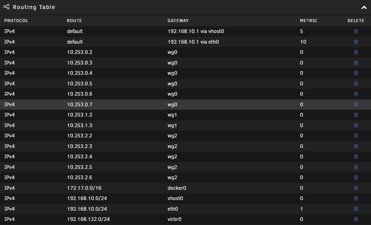

  18. I have a custom docker network created with; docker network create -d ipvlan \ --subnet=192.168.100.0/24 \ --gateway=192.168.100.1 \ -o ipvlan_mode=l2 \ -o parent=virbr1 \ --opt com.docker.network.bridge.enable_icc=false \ lab_net virbr1 is a libvirt network used for my VM's. Everything works if it all comes up in the correct order but when I reboot unraid the docker network is created (I have "Preserve user defined networks" enabled) but it doesn't function and the containers using it wont start. I have to remove the network and recreate it again manually (along with the containers using it) before the containers will start. I'm assuming this is because virbr1 probably doesn't exist when unraid starts docker. How can I fix this so it survives a reboot?
  19. L0k1 replied to Rkpaxam's topic in Lounge

  20. Okay, I decided this probably was due to the default route heading out of eth0 so I've changed the metric and added another for vhost0 with higher priority, my routing table now looks like this; and it works as I wanted, I've physically disconnected the LAN cable between pfSense and the switch and everything still works as it did when I had the switch in the middle. Now will this survive a reboot? and are there any security considerations I haven't thought about?
