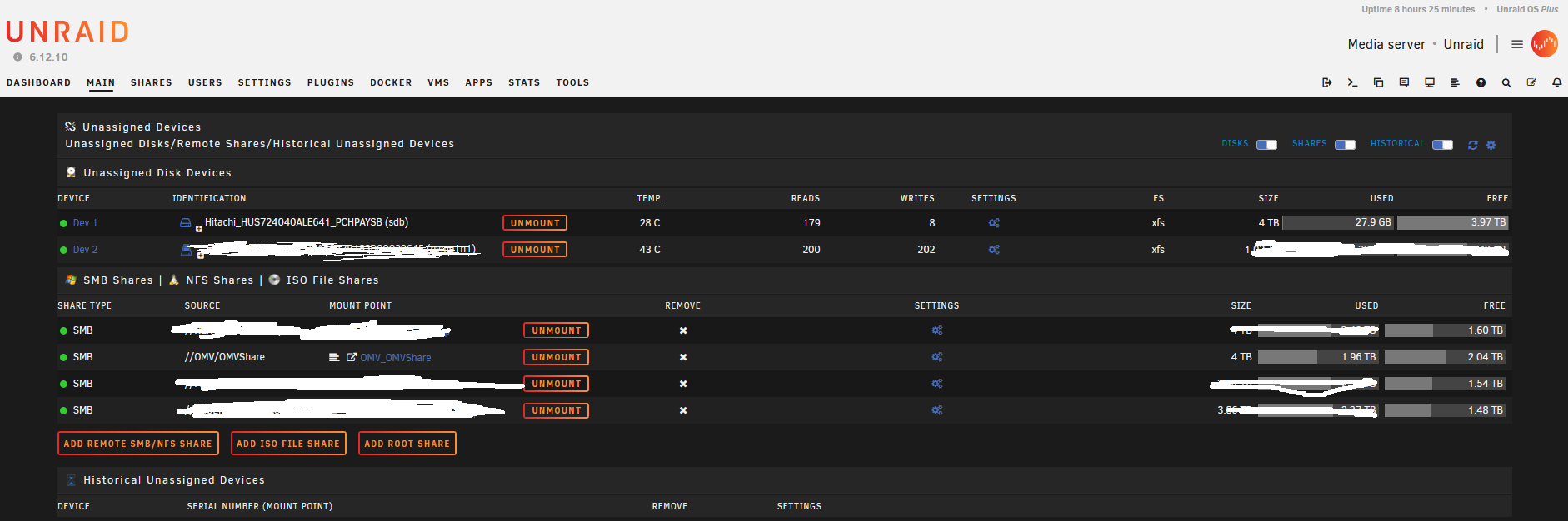

Hello folks, got some strange behaviors with an unassigned disk that is passed thru to an OMV VM as a backup disk on my unraid. The cheap hitachi 4 tbb disk appears in the UA section, I successfully passed it thru using /dev/disk/by-id/ata-Hitachi_xxxxxxx in the OMV VM 2nd vdisk location section, then I created an SMB Share which works, both are mounted, but the hitachi disk appears empty when I use the file manager. The hitachi disk and the OMV/OMV Share are supposed to be the same disk. When I'd click the clickable links before it would open a window showing me both folders exactly the same. I deleted the old OMV VM to make a new, updated one and while that was happening I installed the new UA plugin. This is driving me nuts! I spent 7 hours fiddling around with this, and just gave up. Any help is appreciated.
