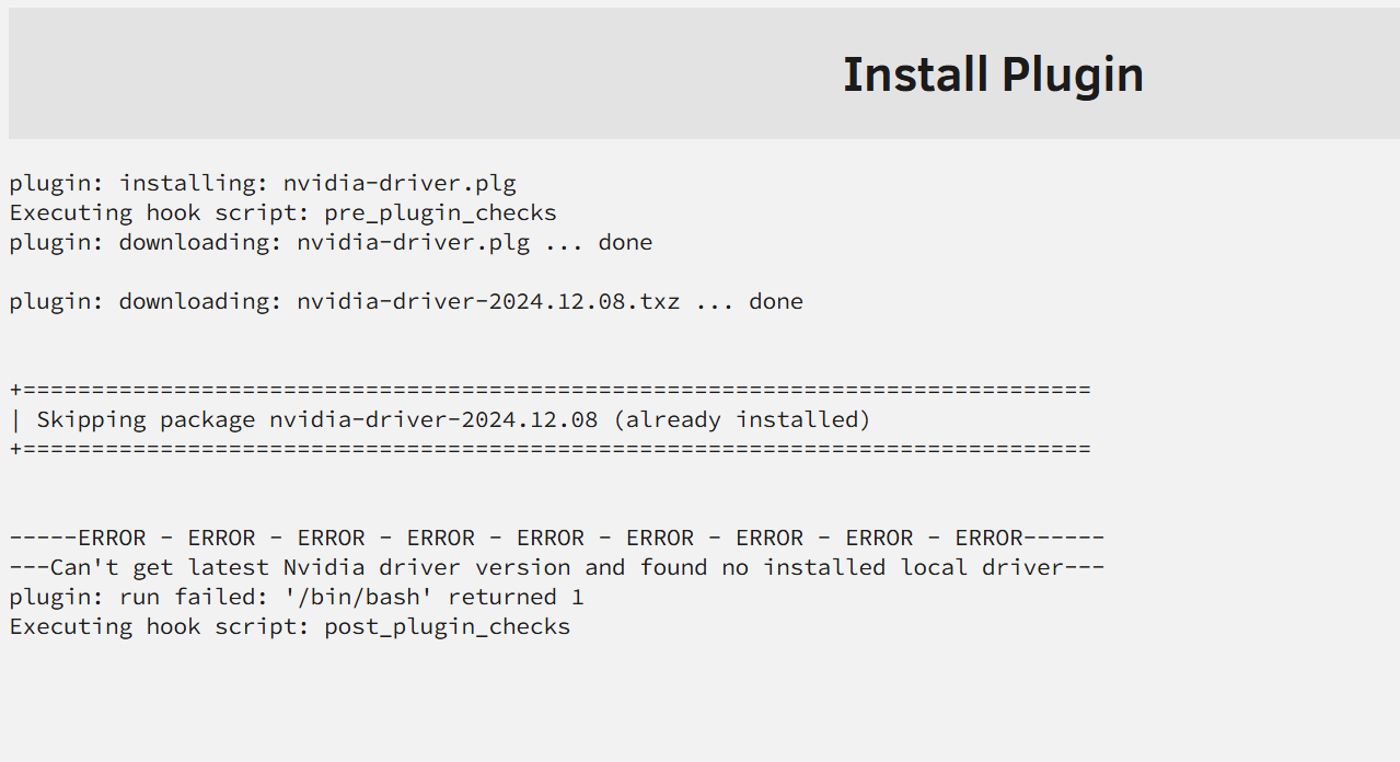

  1. I have a sneaking suspicion that it was VSCode or at least one of the extensions that was using up all my free API requests, will need to dig in to that but for now the drivers have now installed successfully. Thank you for al your help and patience!!
  2. I have shutdown all containers although i don't see anything that should be using any API calls, I will wait to see what happens when the next hours reset happens
  3. root@SamsNas01:/boot/config/plugins/nvidia-driver# wget -qO- https://api.github.com/rate_limit | jq -r '.rate' { "limit": 60, "remaining": 0, "reset": 1737660527, "used": 60, "resource": "core" }

  6. The plugin does not show as installed anywhere so I can't remove it. when I tried the downgrade to go back to where I started from the option was 6.12.14. I downgraded because the drivers did not update and would not install on 7 so I tried the downgrade in an attempt to get back to the previous state.samsnas01-diagnostics-20250123-1451.zip
  7. Error trying to reinstall the drivers after upgrading to UnRaid 7 and downgrade 6.12.14, how can I properly remove the existing install and then re-install? plugin: installing: nvidia-driver.plg Executing hook script: pre_plugin_checks plugin: downloading: nvidia-driver.plg ... done plugin: downloading: nvidia-driver-2024.12.08.txz ... done +============================================================================== | Skipping package nvidia-driver-2024.12.08 (already installed) +============================================================================== -----ERROR - ERROR - ERROR - ERROR - ERROR - ERROR - ERROR - ERROR - ERROR------ ---Can't get latest Nvidia driver version and found no installed local driver--- plugin: run failed: '/bin/bash' returned 1 Executing hook script: post_plugin_checks System log Jan 23 13:24:35 SamsNas01 root: plugin: creating: /boot/config/plugins/nvidia-driver/nvidia-driver-2024.12.08.txz - downloading from URL https://github.com/ich777/unraid-nvidia-driver/raw/master/packages/nvidia-driver-2024.12.08.txz Jan 23 13:24:36 SamsNas01 root: plugin: checking: /boot/config/plugins/nvidia-driver/nvidia-driver-2024.12.08.txz - MD5 Jan 23 13:24:36 SamsNas01 root: plugin: running: upgradepkg --install-new /boot/config/plugins/nvidia-driver/nvidia-driver-2024.12.08.txz Jan 23 13:24:36 SamsNas01 root: plugin: creating: /usr/local/emhttp/plugins/nvidia-driver/README.md - from INLINE content
