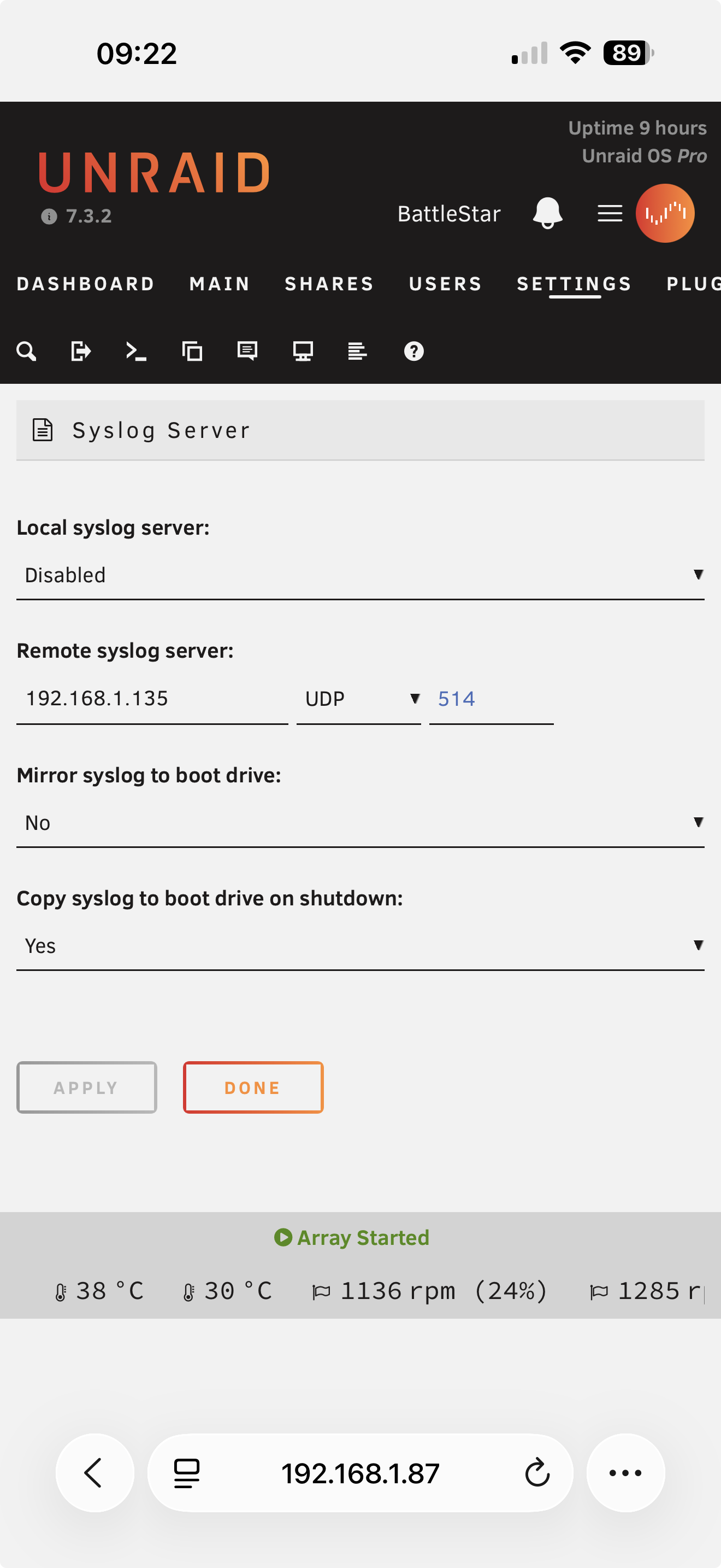

So I have set up the Syslog server and things have been going on for the last few days. I logged in today to try start a vm and when I pressed the vm tab it failed to load. I opened a new browser and could go to the apps tab no problem. Tried the vm tab again and it wouldn’t load. I ssh’d into it and rebooted and it said it was rebooting but stayed replying to a ping. I had to hard reset it again so can anyone tell me what logs in the syslog I can provide to try and determine the issue?Smokie started following Web page loads to login screen but goes blank after logging in- Web page loads to login screen but goes blank after logging in
I just rebooted it and it took a while to come back up. She’s replying to a ping and the webpage loaded at first now it wont load and I can’t ssh into it. Back up now with a hard reset- Web page loads to login screen but goes blank after logging in
Does the syslog server not need to send the diags to another machine? I have a old synology NAS i could probably use- Web page loads to login screen but goes blank after logging in
Will it keep the diags if I have to hard reset it? If it goes I normally can’t get access. Is there a command to run from ssh that will create and download the diags?- Web page loads to login screen but goes blank after logging in
