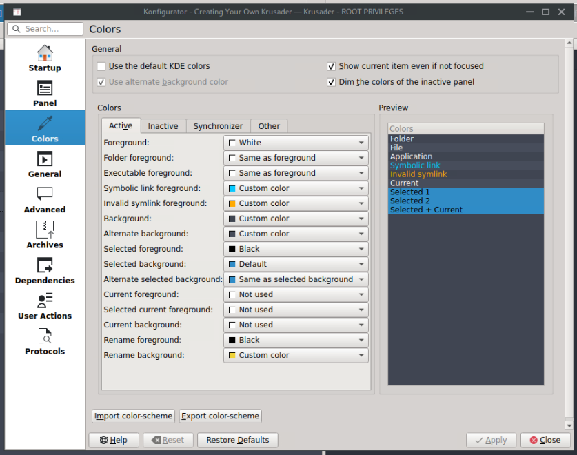

  11. Awesome thank you! Good to know this exists. I managed to figure out how to make mine look like below... it was just editing the color map like you said. Never found out how to change the actual window elements (titlebar, etc) but from the looks of that site, I guess you can't. Surprised more dark themes aren't on there!! One thing I've tried and tried is to get the taskbar icons to show their titles. So if you ever figure that out, please let me know! Well here's mine now.

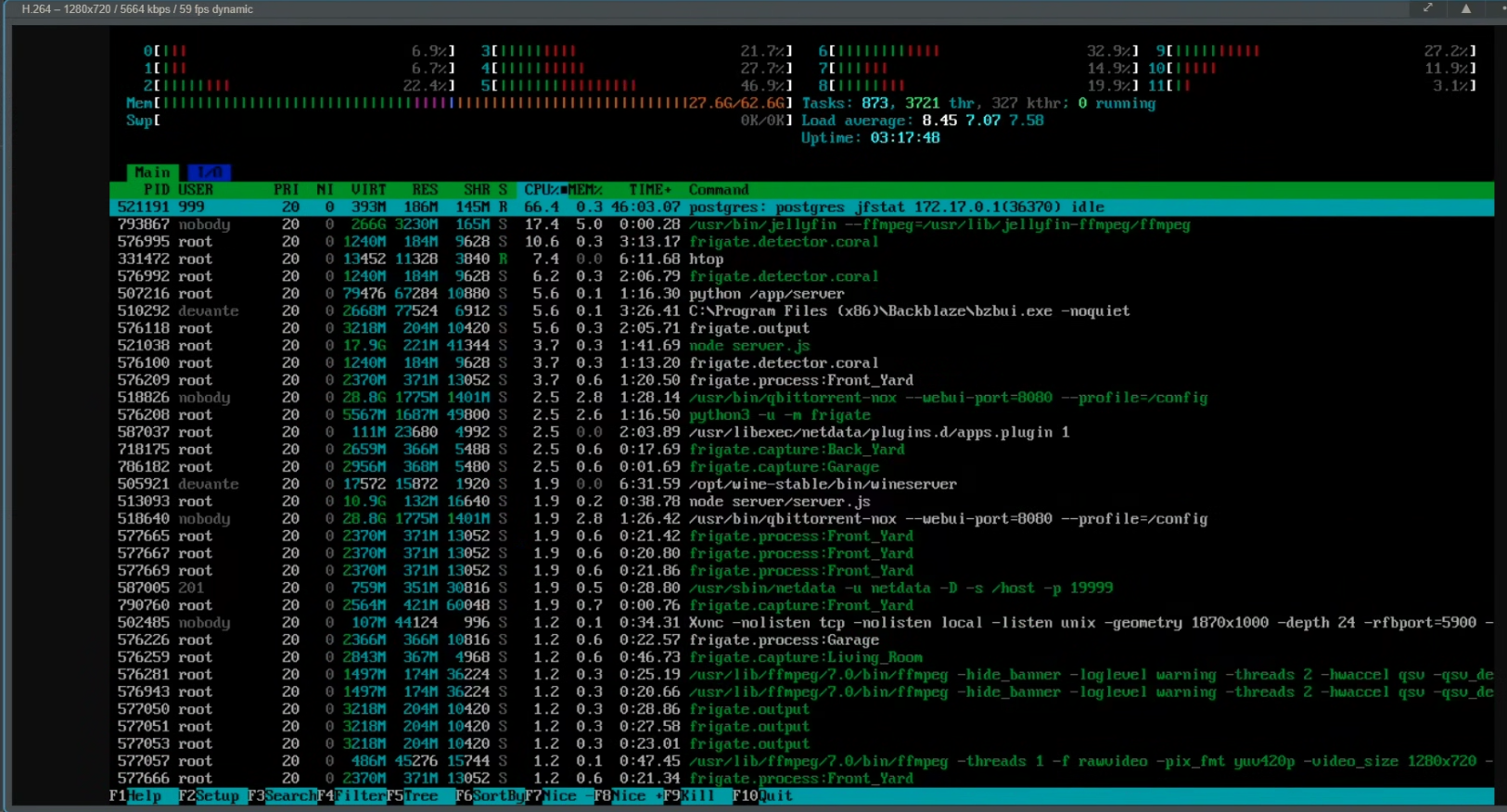

  13. @Michael_P Actually didn't take as long as I thought to try and narrow it down. I remembered Unraid Connect locked my machine up a few times before and sure enough, after removing it, my machine is running like butter again. I hope they get this Unraid Connect thing fixed, I use it almost everyday. This is what it usually looks like, even with 50+ containers going...

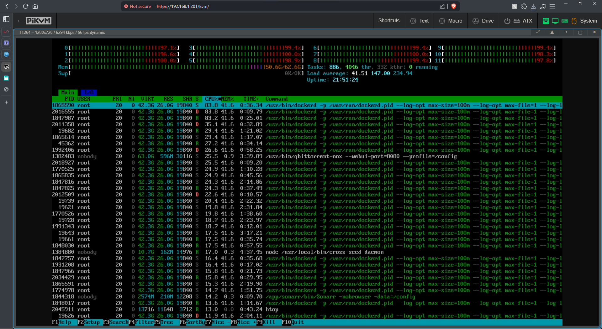

  16. Issues started a few days ago. Every morning when I wake up, the server is completely unresponsive aside from being able to login in via command line and being able to run HTOP. But even then, half the time even the command line is locked up. The only two things that pop into my mind are: 1) My Appdata Backup/Restore plugins runs around 5am and takes about an hour or a little more. It's not running when I wake up though. 2) Imported a ton of shows into Plex and I do have it configured to detect credits, intros, etc. However it doesn't lock up until the morning and pretty sure all those detections have already been finished. Just randomly thinking what it could be. Here's a screenshot and my diagnostic. If I scroll over, it says log-level=fatal. Thanks for any advice! devante-nas-diagnostics-20250716-0658.zip
