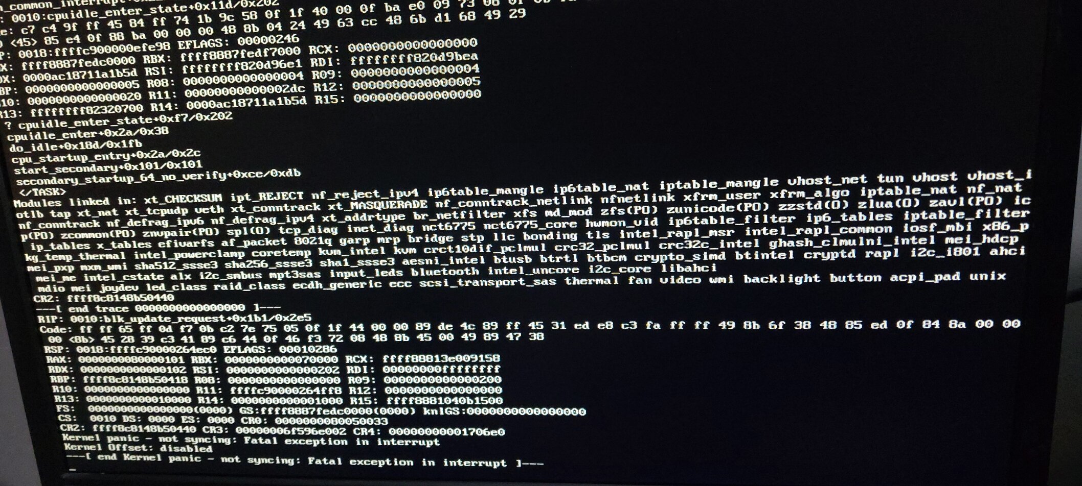

  7. Hi All, Diagnostics and most recent log file attached. syslog-192.168.1.95.log sdchonitower-diagnostics-20250507-1144.zip When I go to back up my windows computer using Macrium Reflect Unraid will stop responding after ~2.5hrs. When I press the power button on my unraid server the display outputs the below (sorry for the picture. I need to buy a DVI to HDMI adapater and start running this through a capture card....) and does not shut down unless I do a forced shutdown. When it reboots, my bios doesn't see the flash drive unless I reboot the computer again. After rebooting, it successfully completes a parity check with 0 errors (this is the time this has happened). I originally thought this was related to docker failing and/or b/c of the FTPGrab Docker I was running, but I have not been running the FTPGrab Docker and the most recent logs (attached) do not mention the cache being full at the time of failure (it does mention it being full at other points though? I ran the mover a few hours ago to make sure this would not happen). Side note: I'm aware of the UPS failing error message. I'll get to that later....
