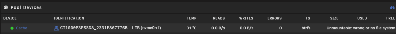

  5. i have done this i woke up this morning to the same thing hers the digs friday-diagnostics-20260319-1043.zip i checked the uptime of all containers and none of them had restarted since that morning when i had to reboot edit: it dose seem that checking this morning majority of the containers restarted 7 hours ago i dont know if thats related
  6. so about 3 days ago all my shares disappeared the smb shares where unreachable and all my dockers where down as they couldn't access there AppData. i rebooted and everything went back to normal since then it has happened 2 more times the latest when i woke up this morning. the latest thing i installed was the unifi-os-server this was a few hours before it happened the first time but i dont know how they could relate. i did download digs after each occurrence friday-diagnostics-20260317-0833.zipfriday-diagnostics-20260315-1202.zipfriday-diagnostics-20260318-1029.zip i checked through these myself and all i found was in the /shares/shareDisk.txt it says Share does not exist but all the shares cfgs do still exist. either way if anyone knows or could help that would be appreciated thanks!

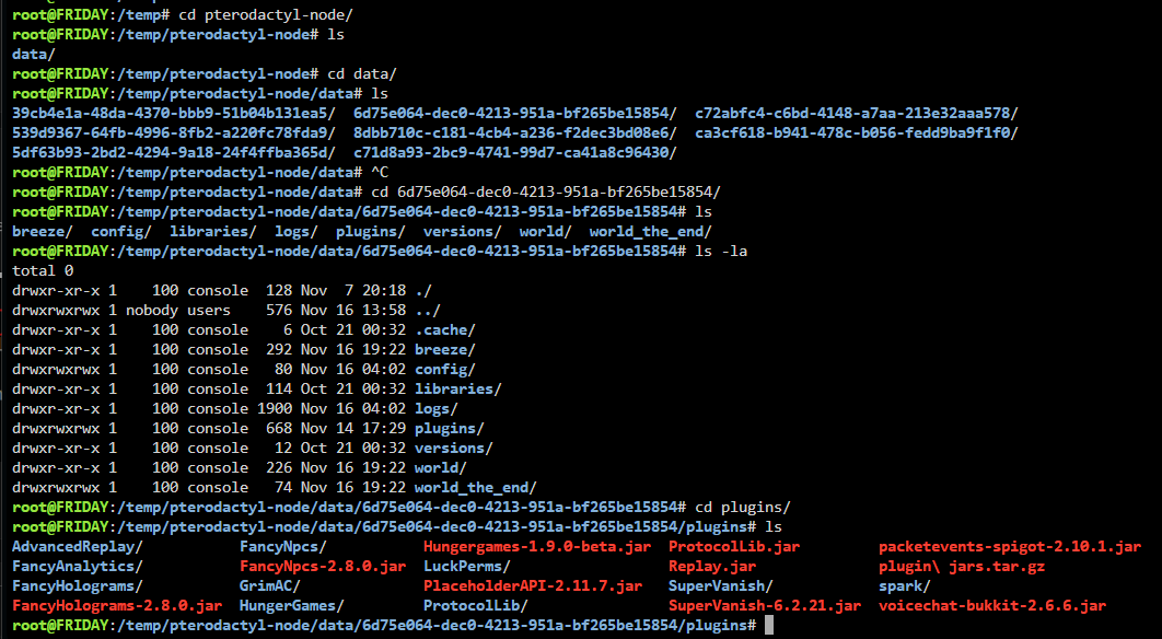

  7. so i have decided to move everything like so rsync -avh /temp/ /mnt/recovery/ then when thats done im going to reformat the drive then move everyhting back over then doing a scrub to check all the files dose this seem right to you guys?
  8. everything that was on the cache drive is now in the temp folder. thank you so much but now thats where the guide stops do i need to reformat the drive then copy everything over? how do i do this?

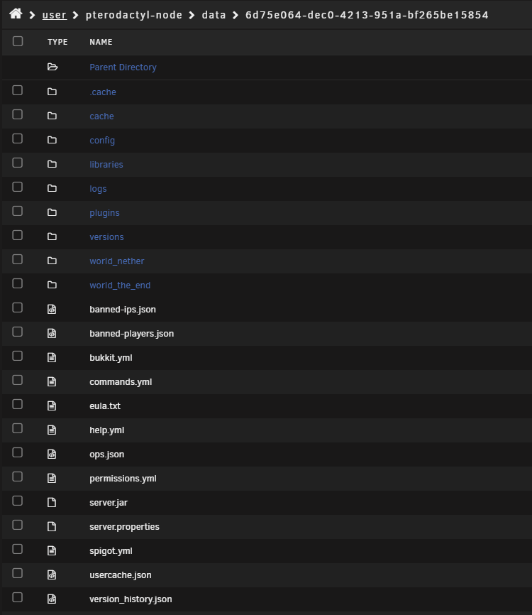

  9. it seems it copied over the directory's but not all the files as there should be lots of files in all them directory's but there's just folders but for some reason the .jars are there but red?... but all the files do show in this view when looking in to the share dose this mean there just on diffrent drives

  13. ye i know about the ram issue and i already fixed that again so its just repairing this i couldn't figure out
