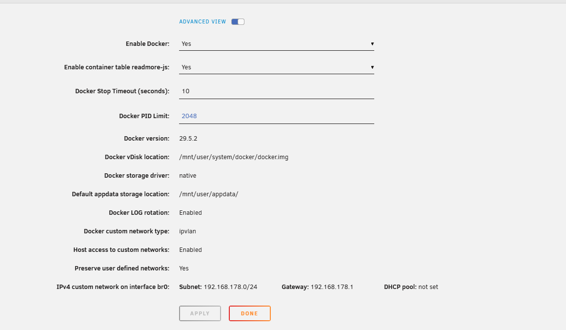

  1. Heya, Its a bit late, but in case you were still having the problem or if someone else has a similar problem. Here is what I did. Essentially in the docker setting, I clicked on that tick box next to IPV4 custom network on interface br0 (not in this picture, but it will show up if you stop docker), and defined the subnet and gateway. (That is for my local network). Because I access my container through a local reverse proxy, I only edited my local NPM container. The primary network was the br0 network, and I defined a static IP, and under advanced, I added --network=dockernet under extra parameters. Basically after that, I was able to access my containers through the reverse, but I stil am not able to access my container by putting the direct IP. But this gets the job done
