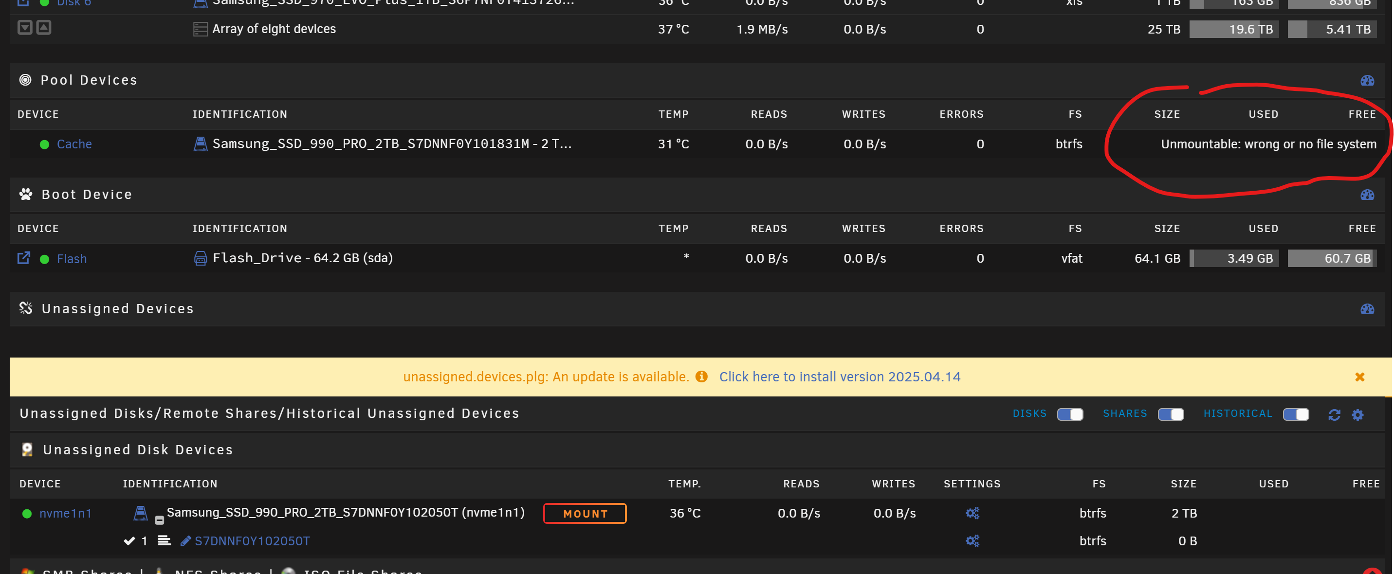

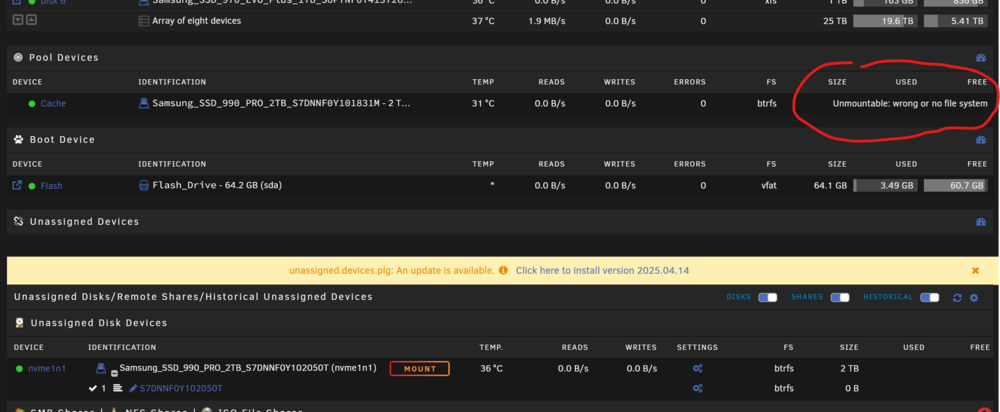

  1. I did remove the SSD that was giving trouble, and my Array starts now, but gives this error: Unmountable: wrong or no file system. What can I do now? tower-diagnostic-20250416-1738.zip
  2. Unraid 7.0.1 Array : 2 x 8TB array drives, (2 parity) and 5 data drives (xfs)) Cache Pool: 2 x 2TB SSD drives (btrfs). I have a double cache pool, of 2 SSD drives. One of these seems to be broken. How do I disconnect one, so that the other just works as a single cache drive again? tower-diagnostics-20250416-0809.zip

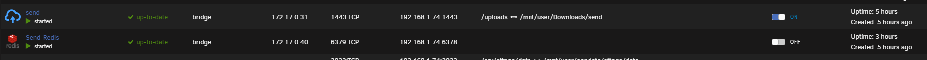

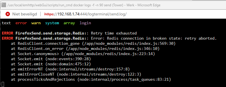

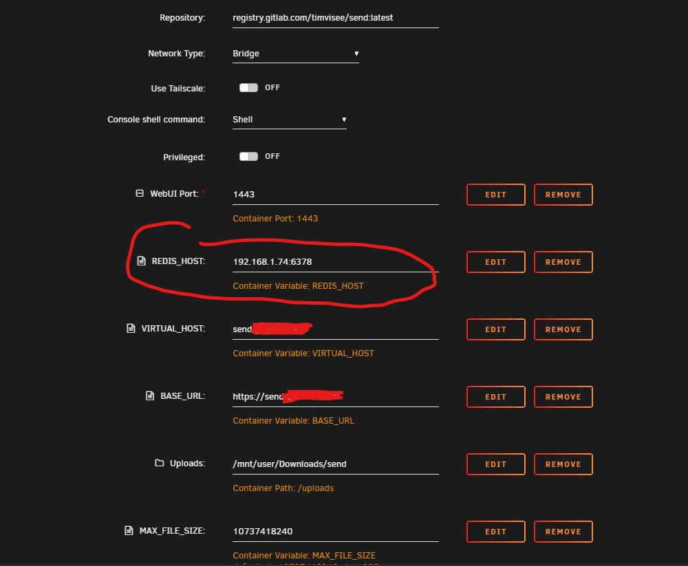

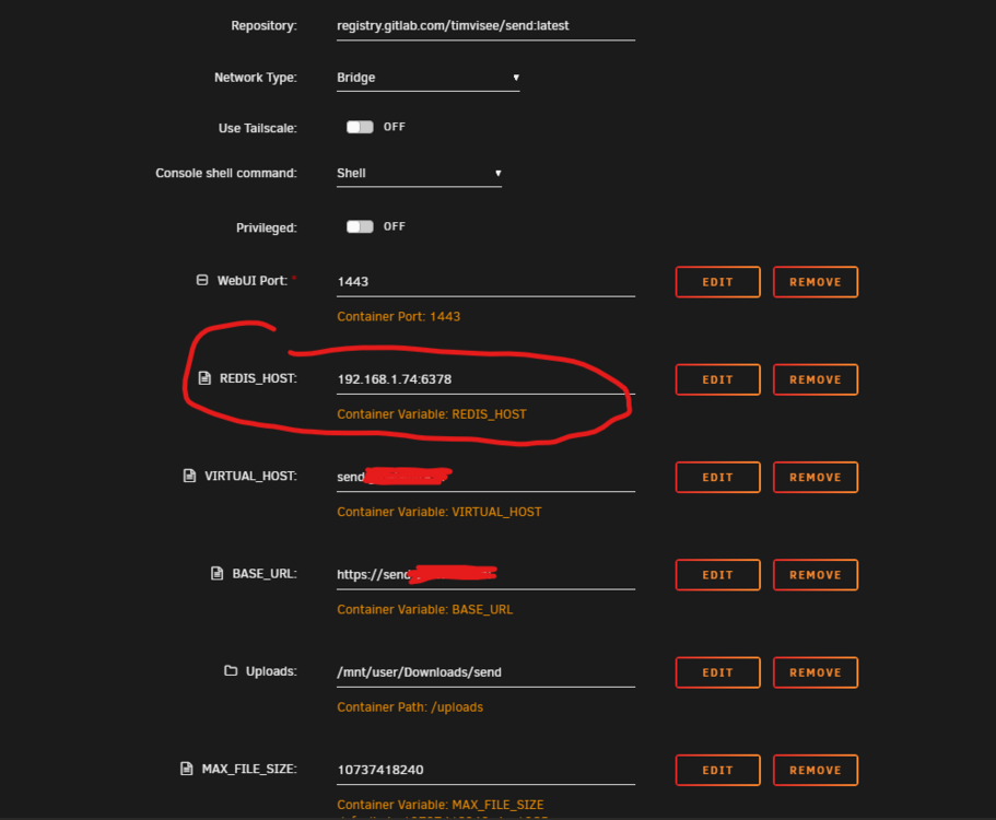

  5. I want to use Send (filesharing) and that uses a docker of Redis. Both work after installing. But Send can't connect to the Redis docker for some reason. I can't figur out what the problem is. Logfile Send:

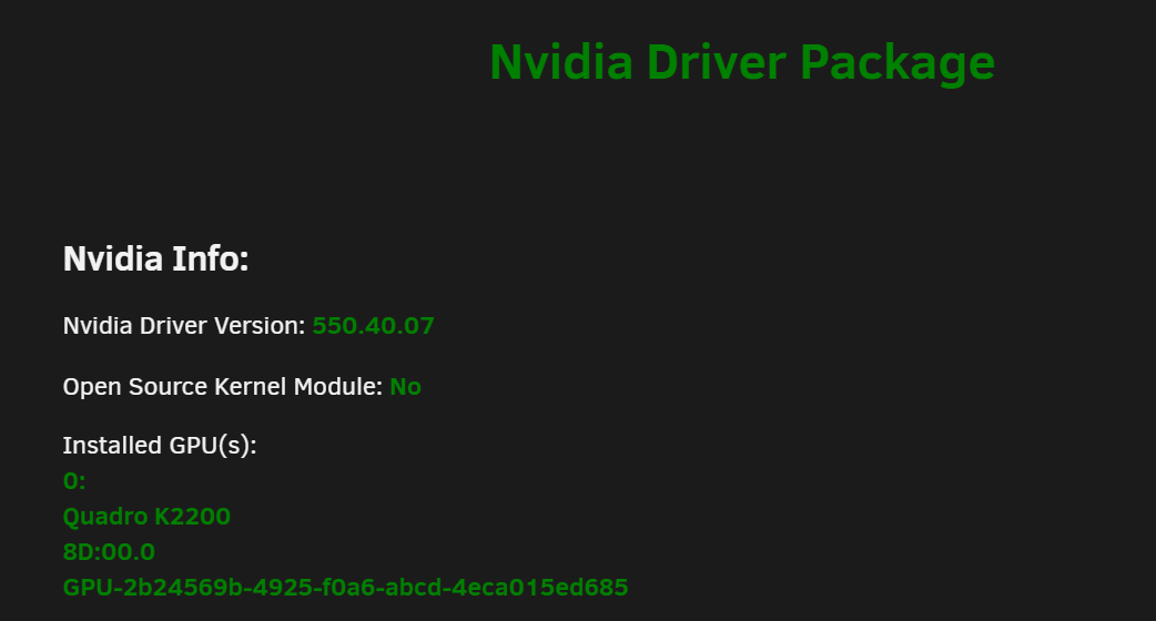

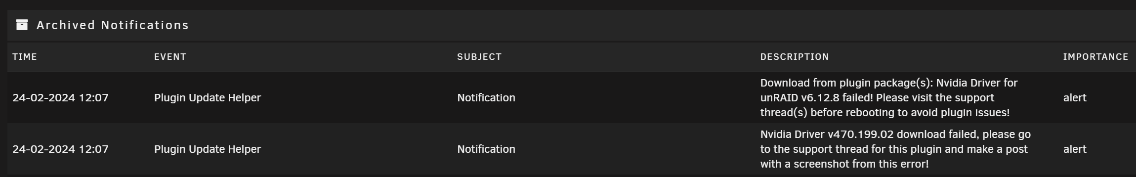

  13. It pulled the new driver indeed. Reboot solved it. Thnx
  14. I got an error updating Unraid 6.12.6 to 6.12.8 with my Nvidia K2200 card
