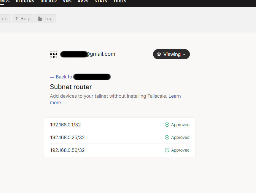

  7. I checked a little bit more, whatever is on br0 (pihole, filebrowser) is not accessible vith tailscale and subnets. Solution for me was to enable host access to custom networks in docker settings. Now, I can access everything. One question, is this maybe some kind of security risk?
  8. I just checked, Pihole is only one unreachable. My unraid server is 192.168.0.25, and when I am accessing webui via desktop pc, I can access everything, all dockers, including pi on 192.168.0.50. When I do that on the phone, and phone is on wifi, I can access everything on 192.168.0.25, all docker apps, but not pihole on 192.168.0.50. So I guess it has nothing to do with tailscale it self.
  9. Just wanted to say, great plugin. I have one small problem, I advertised subnets, to be able to access from unraid my pihole and router that are on different subnet. I can access router remotely, but cant access pihole. I entered ip correctly, 192.168.0.1/32 for router, and 192.168.0.50/32 for pihole. Where did I make a mistake?
  10. Yes, I have docker container installed. But for some reason I cant access apps to install plugin version.
