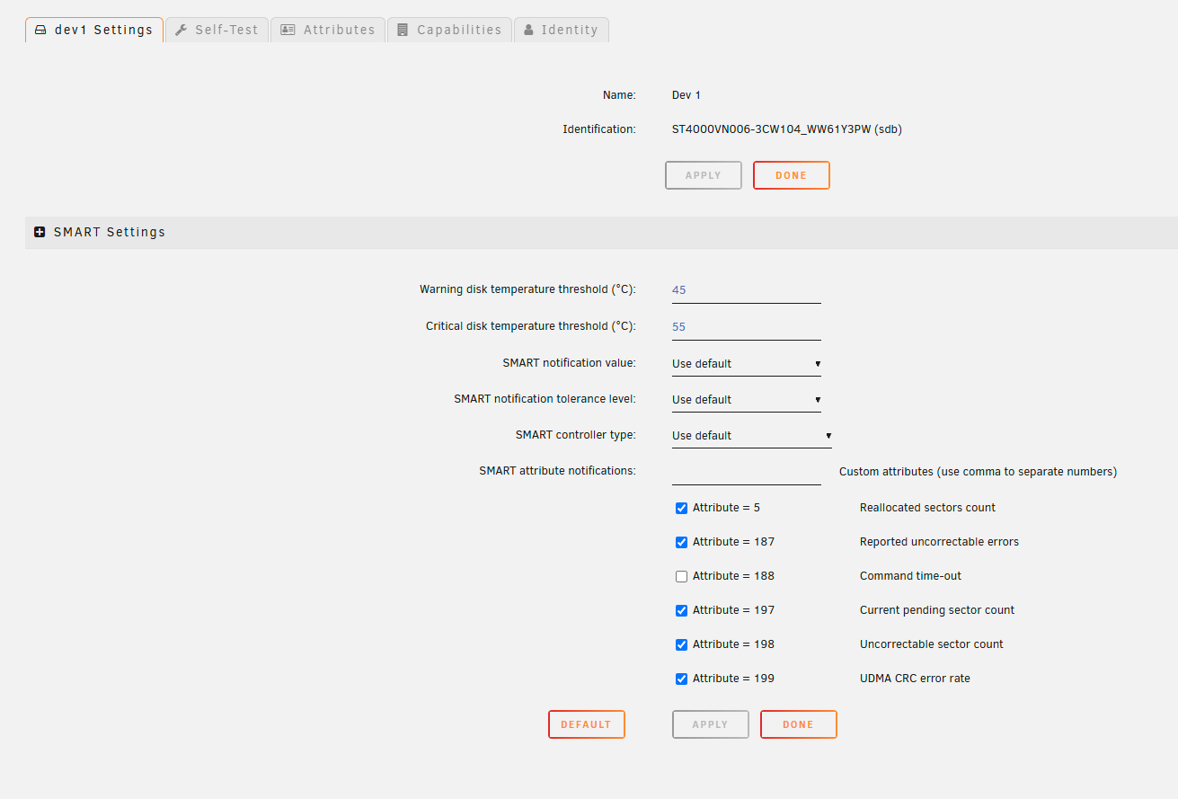

Done, try mounting and still fail, here is the new diagnostic, thanks tower-diagnostics-20250424-2207.zip
Cloned Parity Drive is not recognized as a new Parity Drive
sorry, I try mounting sdb (dev1 ) which is the new drive, the bad disk is WD EARX (dev 2), Thank you
