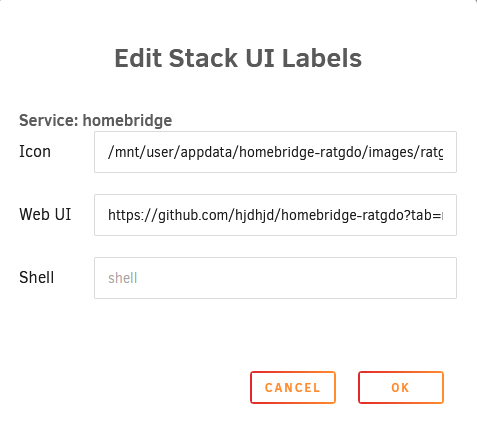

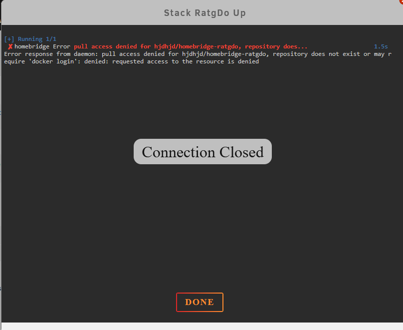

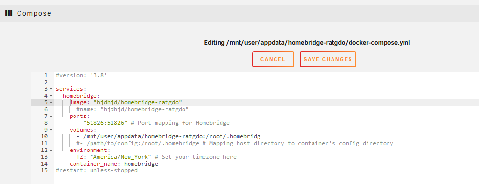

  2. I am running Unraid 6.12.10 and am trying to install a docker from github to control my garge door. I am running into some errors that i am not sure how to get past and was hoping the screenshots would give be able to identify what is going on. Github link - https://github.com/hjdhjd/homebridge-ratgdo I read on a Reddit form to try and use Docker Compose Manager to install it and i followed the instructions as close as i could. Here is my Compose file setting Here is my UI Labels When i go to compose up i keep getting this error and am unsure how to get around it. I have tried to docker login and it still gives the same error.
