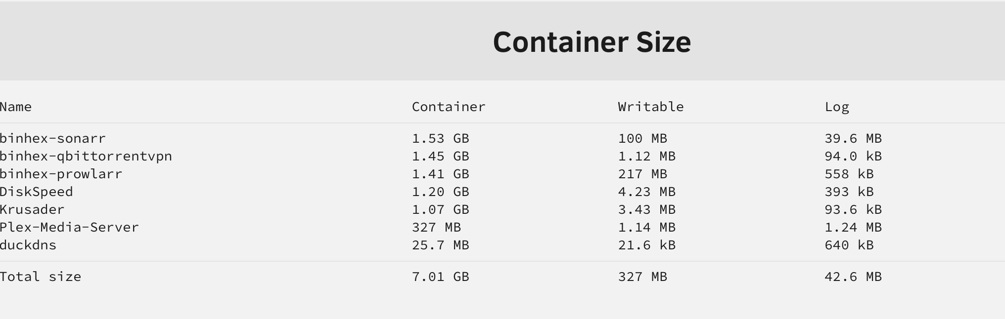

Hi again, I got the docker utilization warning again but looking at the container size nothing is getting larger.

Hello, Trying to move docker and libvirt folder from disk1 to cache. When trying to move it I get this information in syslog. Will it be safe for me to delete the files in disk1? I was getting notification of high utilization in docker.img while using plex Jul 30 17:03:49 Tower move: file: /mnt/disk1/system/docker/docker.img Jul 30 17:03:49 Tower move: move_object: /mnt/disk1/system/docker/docker.img File exists Jul 30 17:03:49 Tower move: file: /mnt/disk1/system/libvirt/libvirt.img Jul 30 17:03:49 Tower move: move_object: /mnt/disk1/system/libvirt/libvirt.img File exists Jul 30 17:03:49 Tower root: mover: finished Thank you in advance for the assistance
