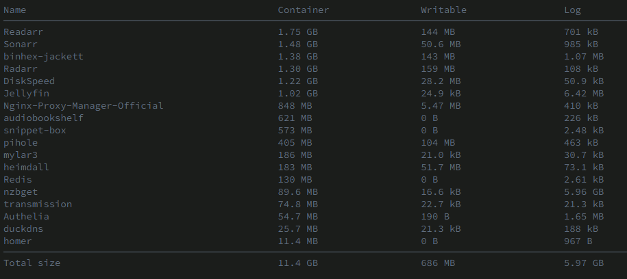

  13. Can i up my container size so i dont get these messages anymore?
  14. I have found out why my logs were so huge. NZBGet was running privelaged. and logged almost everything. Turned privelaged off and log reduced a ton. Still would like to know if its normal that some containers like readarr and sonarr are almost 2gb
  15. I found a few big ones, but all the paths are mapped. and why is my total log size so huge? Can i clear my logs?
  16. I’m using Jellyfin so it might be that, how do i find out what is causing this?
  17. Hey guys, I keep getting warnings that my docker image size is at 95-100%. What can i do about this? Do i up the size? or am i doing something wrong in my setup? (probably the second one, im super new to unraid)

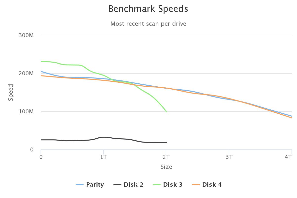

  18. UPDATE: Parity check completed after 2+ days, parity showed up as valid. Removed the parity drive and replaced it by a new one. Rebuild was done in 8 hours. New drive much faster im no longer bottlenecked. Everything is up and working! Thanks for all the help!

  20. One sticks out like a sore thumb
  21. It is still running the parity-sync/rebuild. it says it will take days. im certain this is because one of my old drives is bottlenecking me. I ordered a new one toay which will arrive tomorrow. If it takes too long ill try draining the drive and replacing it. But hopefully the rebuild speeds up soon and i can replace the old drive tomorrow the normal way.
