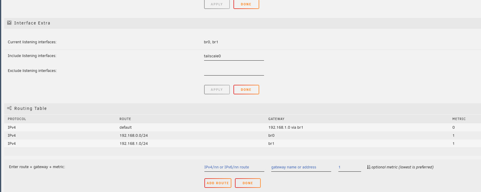

Deleting network.cfg in flash drive fixed it! But my server reset to DHCP back so you guys will need to set to static back and connect server to monitor to check which IP unraid is using after deleting and rebooting network.cfg.

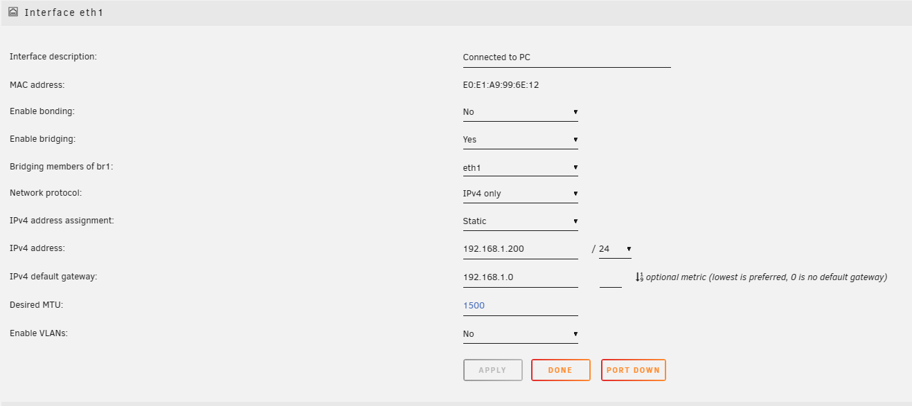

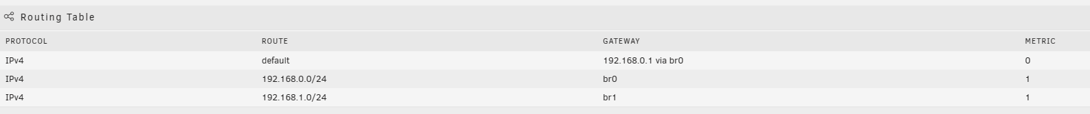

Hi, I got this error when I unplug my 2.5 NIC card that connected LAN with my PC (I plan to not use that card anymore) My 2.5G card use isolated network which is 192.168.1.200 and my network for router use 192.168.0.136 I got this when pinging 8.8.8.8 Unraid network settings might be wrong here as it's using 1.0 gateway. Any idea how to fix this? Solution I tried : ✅restart unraid api

nevermind I fixed it. I just need to manual put different IP address into my PC setting. this video helps me : Truenas: How to set up a 2nd static route a direct connection to your computer #truenas #nas #tplink (youtube.com)

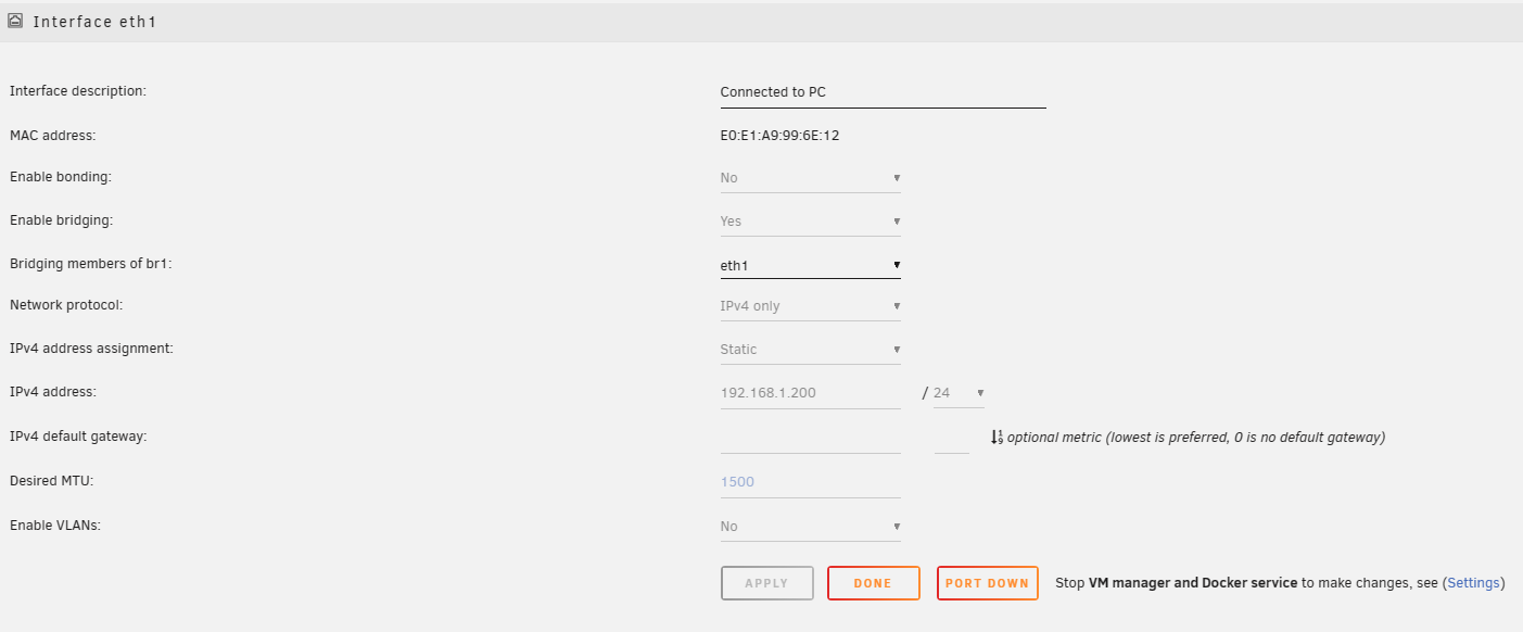

My router connect directly to both of my PC and unraid via LAN (Motherboard built-in port) I got 2 2.5GB network card, both are inside PC and unraid and directly connected with LAN. My unraid server use 192.168.0.136 as static IP from router. I choose to do 192.168.1.200 directly from both card (it's within their own network) My router support only 1Gbps LAN connection so I use that card to get 2.5Gbps before.- NETWORK CARD WONT RESPOND AFTER NETWORK RESET

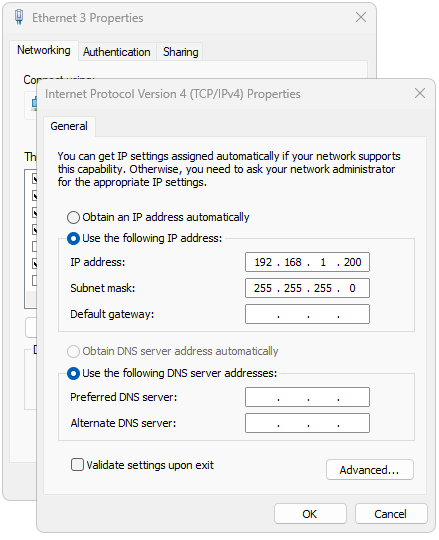

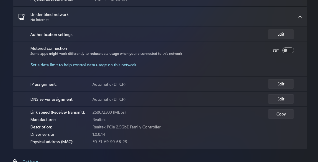

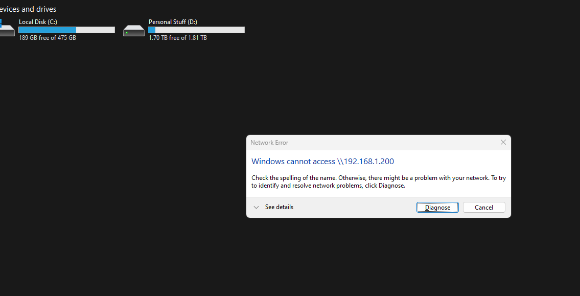

I set my PC to DHCP yesterday and only now have free time to check. But my IP 192.168.1.200 won't connect.- NETWORK CARD WONT RESPOND AFTER NETWORK RESET

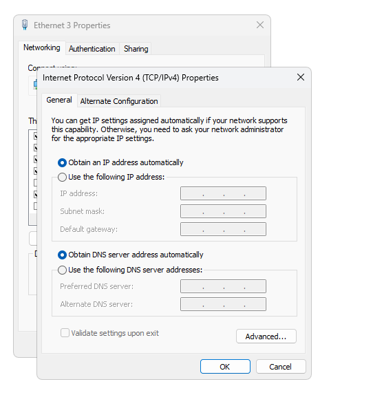

I will set my PC to use DHCP. Sorry for asking but is there any need to set up router here? Because I use LAN and directly plug it into both my PC and Unraid Network card.- NETWORK CARD WONT RESPOND AFTER NETWORK RESET
Should I set this to automatically?- NETWORK CARD WONT RESPOND AFTER NETWORK RESET

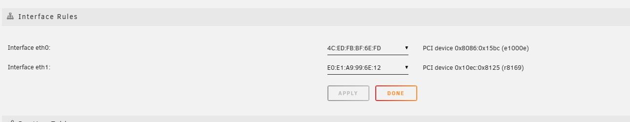

The picture above (unraid screenshot) is my old setting. It works and I didn't touch it at all yet. So the wrong thing I did is in my Windows settings but I don't which one is it.- NETWORK CARD WONT RESPOND AFTER NETWORK RESET

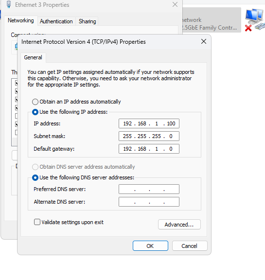

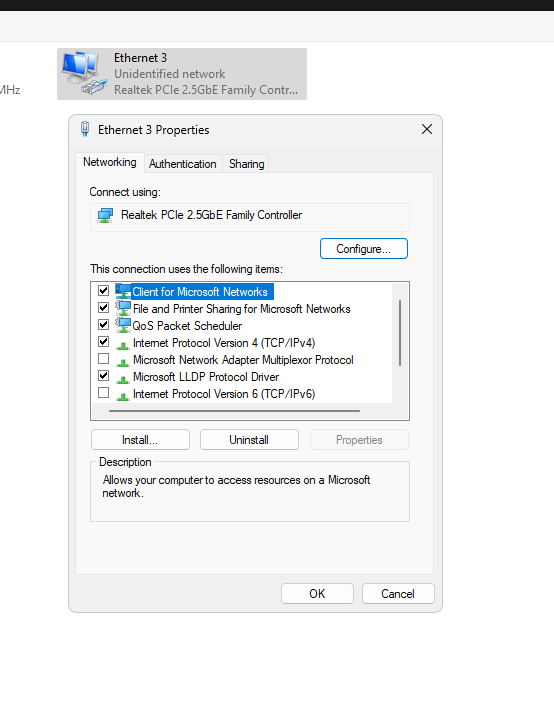

Hi, I use windows PC and I do reset my network, uninstall and install ipv4 back and etc. Now the network card which directly connect from my PC to Unraid card won't even responding. Here's some screenshot of the setting and etc. Hope someone can point out, it might be some wrong configuration on my PC. paradyne-diagnostics-20240325-2159.zip- [Plugin] Appdata.Backup
