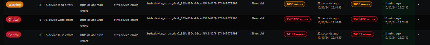

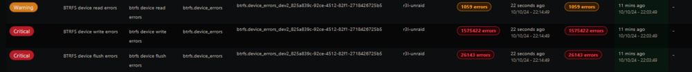

  9. Some more info, looks like they are real after all. Ran btrfs dev stats /mnt/cache and got the below results [/dev/nvme0n1p1].write_io_errs 1575422 [/dev/nvme0n1p1].read_io_errs 1059 [/dev/nvme0n1p1].flush_io_errs 26143 [/dev/nvme0n1p1].corruption_errs 0 [/dev/nvme0n1p1].generation_errs 0 Edit - More info: Result of smart test below: UUID: 825a839c-92ce-4512-82f1-2718426725b5 Scrub started: Thu Oct 10 23:11:35 2024 Status: finished Duration: 0:01:41 Total to scrub: 544.39GiB Rate: 5.39GiB/s Error summary: no errors found Downloaded results: === START OF INFORMATION SECTION === Model Number: KINGSTON SFYRD2000G Serial Number: 50026B7686D58263 Firmware Version: EIFK31.7 PCI Vendor/Subsystem ID: 0x2646 IEEE OUI Identifier: 0x0026b7 Total NVM Capacity: 2,000,398,934,016 [2.00 TB] Unallocated NVM Capacity: 0 Controller ID: 1 NVMe Version: 1.4 Number of Namespaces: 1 Namespace 1 Size/Capacity: 2,000,398,934,016 [2.00 TB] Namespace 1 Formatted LBA Size: 512 Namespace 1 IEEE EUI-64: 0026b7 686d582635 Local Time is: Thu Oct 10 23:06:51 2024 BST Firmware Updates (0x12): 1 Slot, no Reset required Optional Admin Commands (0x0017): Security Format Frmw_DL Self_Test Optional NVM Commands (0x005d): Comp DS_Mngmt Wr_Zero Sav/Sel_Feat Timestmp Log Page Attributes (0x08): Telmtry_Lg Maximum Data Transfer Size: 512 Pages Warning Comp. Temp. Threshold: 84 Celsius Critical Comp. Temp. Threshold: 89 Celsius Supported Power States St Op Max Active Idle RL RT WL WT Ent_Lat Ex_Lat 0 + 8.80W - - 0 0 0 0 0 0 1 + 7.10W - - 1 1 1 1 0 0 2 + 5.20W - - 2 2 2 2 0 0 3 - 0.0620W - - 3 3 3 3 2500 7500 4 - 0.0620W - - 4 4 4 4 2500 7500 Supported LBA Sizes (NSID 0x1) Id Fmt Data Metadt Rel_Perf 0 + 512 0 2 1 - 4096 0 1 === START OF SMART DATA SECTION === SMART overall-health self-assessment test result: PASSED SMART/Health Information (NVMe Log 0x02) Critical Warning: 0x00 Temperature: 42 Celsius Available Spare: 100% Available Spare Threshold: 10% Percentage Used: 0% Data Units Read: 1,720,439 [880 GB] Data Units Written: 4,067,836 [2.08 TB] Host Read Commands: 13,936,702 Host Write Commands: 31,345,141 Controller Busy Time: 146 Power Cycles: 2 Power On Hours: 173 Unsafe Shutdowns: 0 Media and Data Integrity Errors: 0 Error Information Log Entries: 478,986 Warning Comp. Temperature Time: 0 Critical Comp. Temperature Time: 0 Temperature Sensor 2: 55 Celsius Error Information (NVMe Log 0x01, 16 of 63 entries) Num ErrCount SQId CmdId Status PELoc LBA NSID VS 0 478986 0 0x4019 0x4004 0x102c 0 0 - 1 478985 0 0x4018 0x4004 0x102c 0 0 - 2 478984 0 0x701a 0x4004 0x102c 0 0 - 3 478983 0 0x2019 0x4004 0x102c 0 0 - 4 478982 0 0x1019 0x4004 0x102c 0 0 - 5 478981 0 0x1018 0x4004 0x102c 0 0 - 6 478980 0 0x7006 0x4004 0x102c 0 0 - 7 478979 0 0x6005 0x4004 0x102c 0 0 - 8 478978 0 0x0018 0x4004 0x102c 0 0 - 9 478977 0 0x101b 0x4004 0x102c 0 0 - 10 478976 0 0xe018 0x4004 0x102c 0 0 - 11 478975 0 0xf01b 0x4004 0x102c 0 0 - 12 478974 0 0x4011 0x4004 0x102c 0 0 - 13 478973 0 0x4010 0x4004 0x102c 0 0 - 14 478972 0 0x3000 0x4004 0x102c 0 0 - 15 478971 0 0xf003 0x4004 0x102c 0 0 - ... (47 entries not read) Should also note this is just a single cache pool.
  10. I just noticed these while browsing netdata: Loads of errors on my cache drive showing in Netdata yet nothing in the Unraid system log - surely they would be there if true right? Any thoughts on how to clear this or investigate further? I have recently changed to a new cache drive, done everything correctly and its been working fine ever since for over 2-3 weeks now. Log file attached. Edit - Some additional info, I am on the stable branch of Netdata, I was on latest but changed it to stable to check if this kept up. r3l-unraid-syslog-20241010-2118.zip
