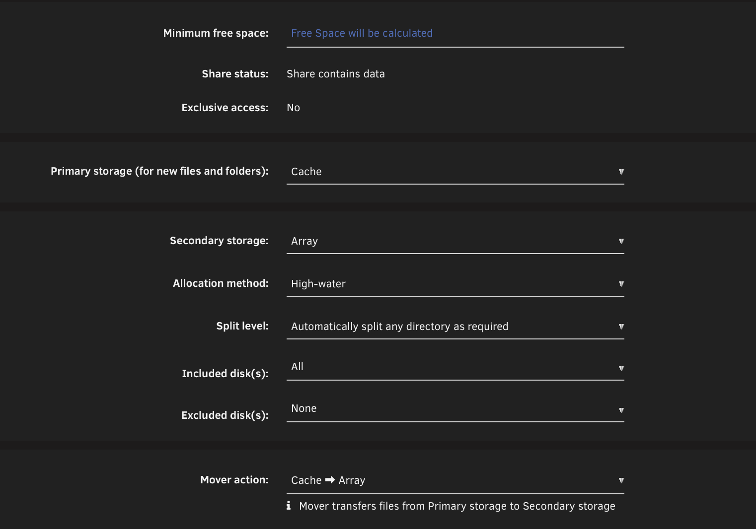

  1. I’ve removed it now and triggered the mover again. Let’s see if anything happens. And it's works. Thx everyone/
  2. Yes, I saw it, I just didn’t figure it out right away. I set it to "10GB", which seems to be correct. Thanks.
  3. What values am I supposed to use here? "10" - does this mean 10 MB? "10Mb" - does this mean 10 MB? "10Gb" - does this mean 10 GB? I’m not quite sure what format these values are expected to be in.
  4. homenas-diagnostics-20260110-0133.zip
  5. Hello everyone. I’ve run into an issue and would appreciate some help. I have a share accessible via SMB. The primary storage is set to cache, with array as secondary storage, and I’m facing two problems: 1.When the cache disk becomes full, writes stop completely with a “not enough space” error. Logically, I would expect the data to continue writing to the array instead of the cache. 2.When I try to start the mover manually, it completely ignores the command, nothing happens at all. Any insights would be appreciated. Unraid version 7.2.3
