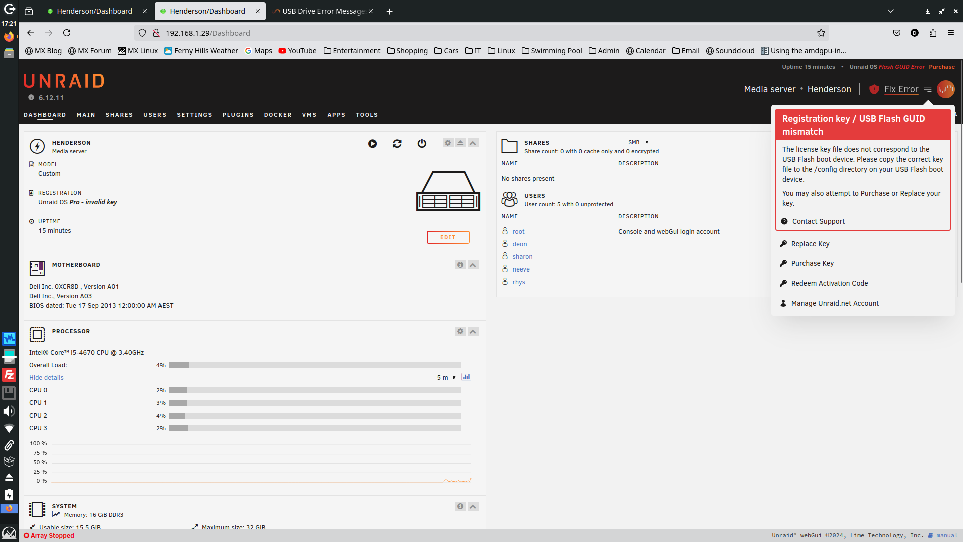

  6. Think I have resolved by selecting the "Replace Key" option, which makes no sense to me at all, however it worked. Thank you
  7. Hi JorgeB, I went through the process as described in unraid documentationbut I found it difficult to follow. UnRaid boots now using the new USB and I get the screen below. However I don't want to "Replace Key" (I purchased a Pro licence in March this year so I am not expecting to have purchase again because a USB drive got corrupted) or "Purchase Key" or "Redeem Activation code" (dont know what this is ) I want to "Replace USB" but this option doe snot exist? Really hard to understand how to progress with the set of options presented to me?

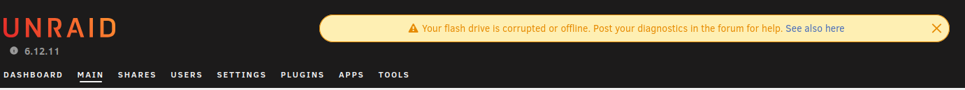

  8. I followed the instructions regarding replacing the USB but it has not worked. I've lost unraid, now can't get in.
  9. Looks like I may be too late to identify the problem. I wonder if it related to a power outage we had last week. I normally let the unraid server run 24/7
  10. Ok, JorgeB am advising that there is only ONE USB in the unraid PC and the rror messages continue to show as per the attached syslog. Thank you henderson-syslog-20240813-2305.zip
