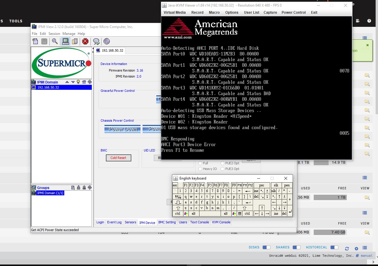

  3. Hi, Trying to install a new 14TB Gold disk, getting a AHCI(port 3) device error, anyone had this before? See pic, is there something I need to enable? I'm replacing Parity 1(6TB) with this bigger one, no drama with booting etc if I put this one back in, so don't think it's cable related Regards Mitch d

  12. A win, both Parity disks back online, Parity is valid, I'm no expert, obviuosly, doesn't look to be any ATA errors and such, thanks for everyones help. I'm going to put it down to and older PS/cables, have replaced both. tower-diagnostics-20210826-1826.zip
