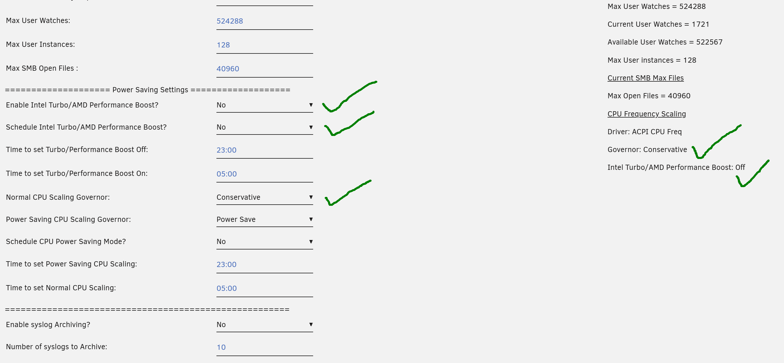

@dlandon thank you, that works fine. The driver is now again "ACPI CPU Freq".

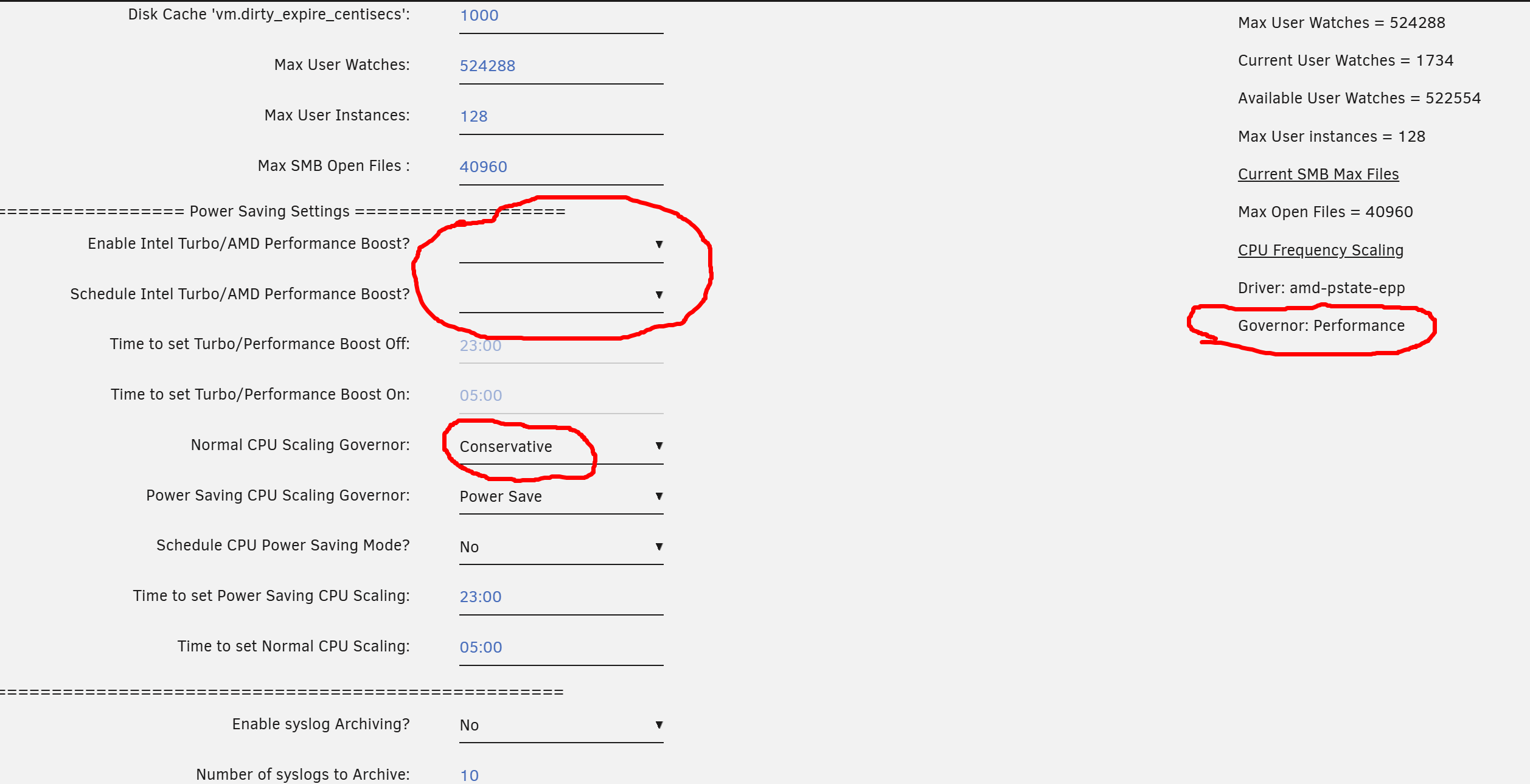

Hello @dlandon The result for "cat /sys/devices/system/cpu/cpufreq/boost" on Unraid 7 is: # cat /sys/devices/system/cpu/cpufreq/boost cat: /sys/devices/system/cpu/cpufreq/boost: No such file or directory

@dlandon It was: ACPI CPU Freq Now it is: amd-pstate-epp Yes there are problems in this forum with pictures it seems...

@dlandon What information is missing? I think everything is displayed on my screenshots. Where can I find the missing information? Thats the complete area at the settings with Unraid 6:

I downgraded to Unraid 6.12.14 and my server needs now again less power. It was about 45 to 50 watts with Unraid 7.0.0. As I already wrote, I reported this to the author of "Tips and Tweaks" plugin, as I think thats the problem.

Hello, it seems that your plugin "Tips and Tweaks" does not work correct anymore after updating to Unraid 7.0.0. - my server need now about 35% more power. You can also see on the screenshot, that the options for performance boost are not displayed anymyore and my Normal CPU Scaling Governor is set to conservative, but on the right there is displayed "performance". With Unraid 6.12.14 everything worked fine. Would you please check this? This is with Unraid 6.12.14: nas01-diagnostics-20250220-1928.zip

Hello, I upgraded to Unraid 7.0.0. between 17th January 2025 and 18th January 2025. Today I have seen, that my server now needs about 35% more power. There was no change of the hardware and no additional software. I am using the plugin from dlandon "Tips and Tweaks" to reduce the CPU scaling (conservative). Can anyone help? nas01-diagnostics-20250220-1928.zip
