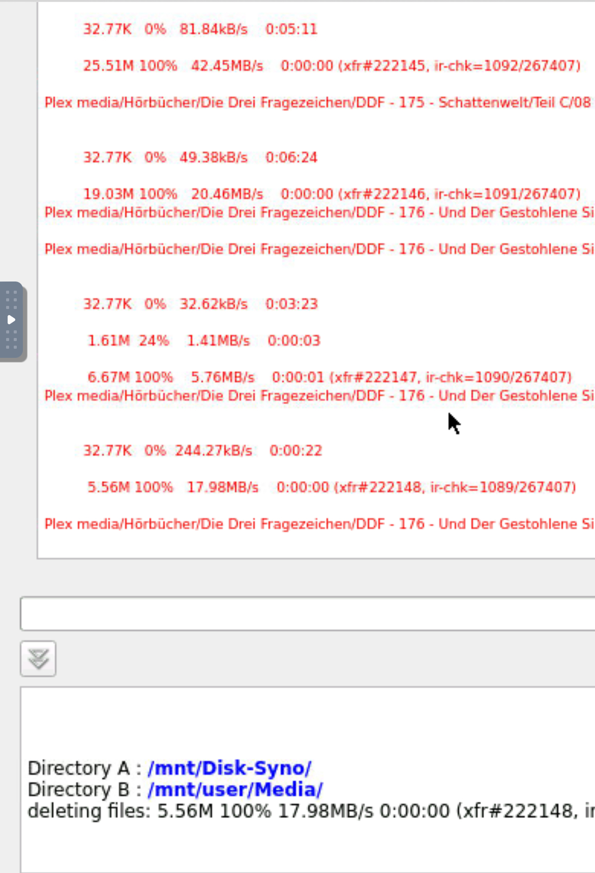

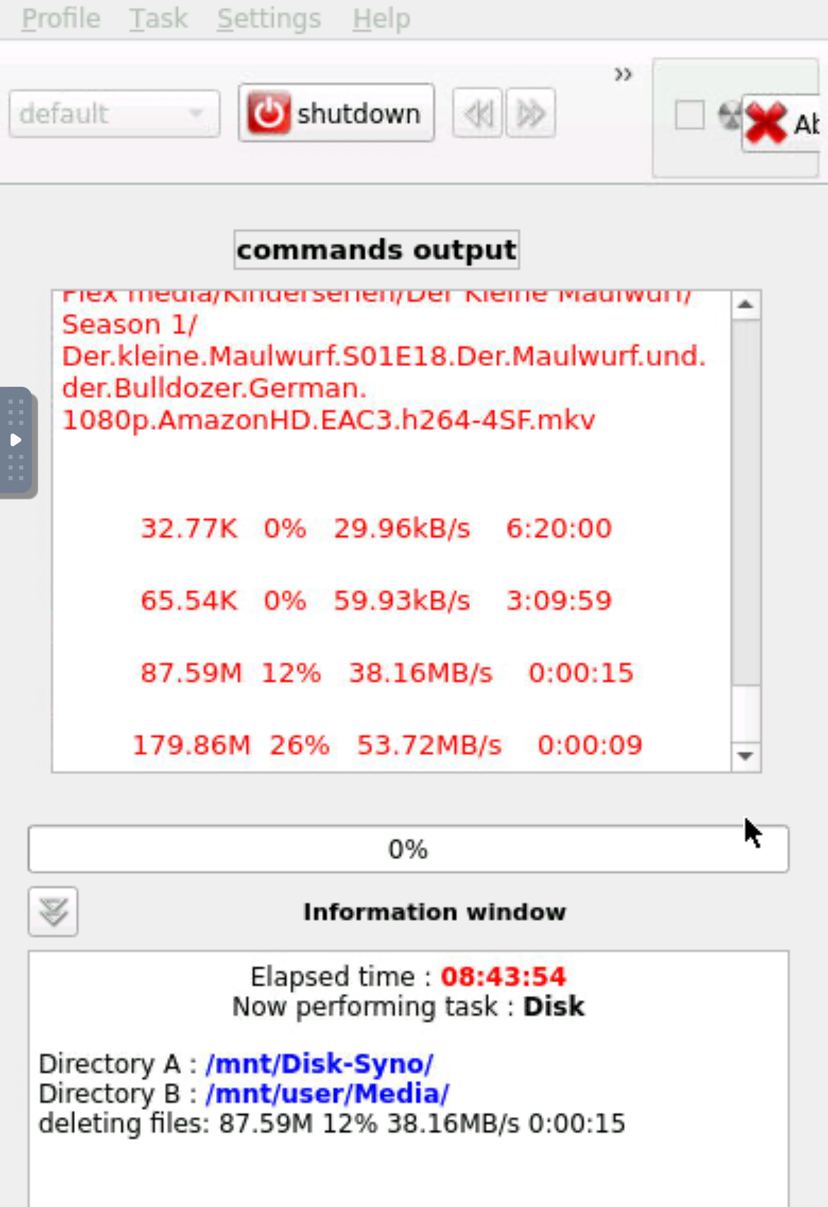

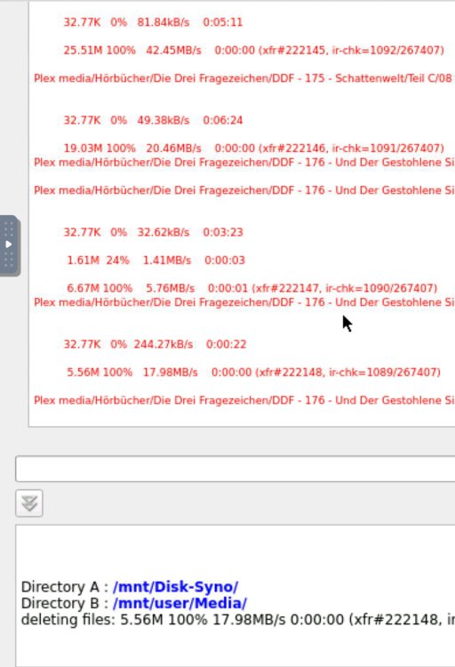

I can only offer a mobile screenshot. I configured it as a sync and without any additional manual options. It does transfer the files, the mentioned files are on the Synology NAS and on my Unraid server. It‘s a first-time sync, so there are no changes or deletions that would be processed. I guess, it‘s just weird behavior.

Thanks for the quick reply. That‘s what it‘s been saying for five hours in the information window. However, files are transferred and I don‘t know what files and where are deleted.

I am just using LuckyBackup to mirror my files from my Synology to my new Unraid-Build. Backing up one share worked like a charm, synchronizing another share that I might fill with new files on the Synology before the migration is complete however, scared me a bit. LuckyBackup via VNC shows "deleting files" in the Information Window for all the files mentioned in the commands output. However, this is the first sync and nothing has been deleted on the source nor the destination. Also, the files mentioned there are both still available on source and destination. Is this just a mistakenly shown text caused by VNC? I read about red text in the commands output being a VNC error, too. For my understanding this should read "transferring files:".
