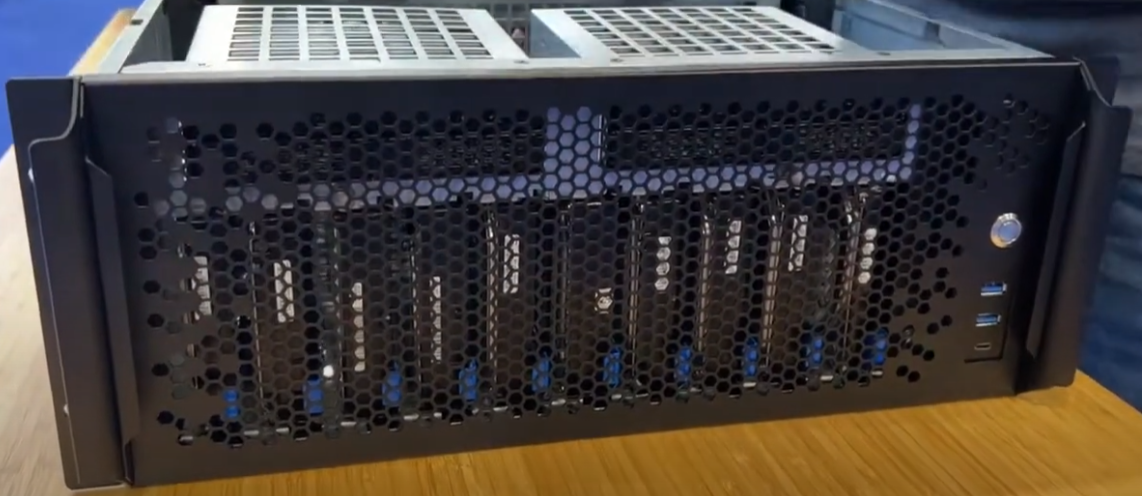

  1. I have a Sliger CX4712 It would be awesome to have an icon of this one. Thanks for all your effort!
