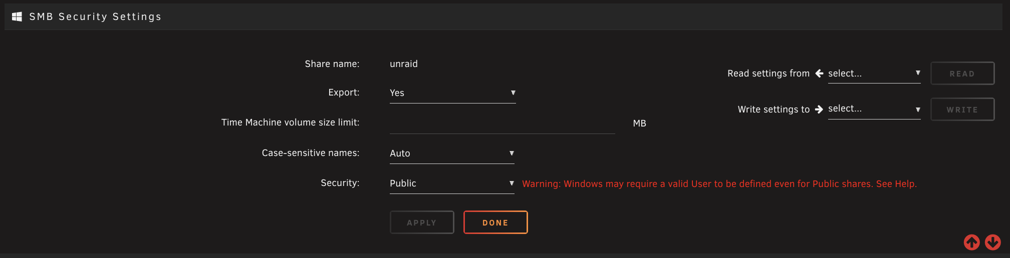

  4. Hmm I'm still having trouble getting this to work: //192.168.0.30/mnt/user/unraid /mnt/unraid cifs rw,guest,_netdev,noatime,noserverino,cache=none 0 0 I have set SMB Security Settings > Security > Public. Do I have to set any particular mount setting for fstab to pick up the mount?

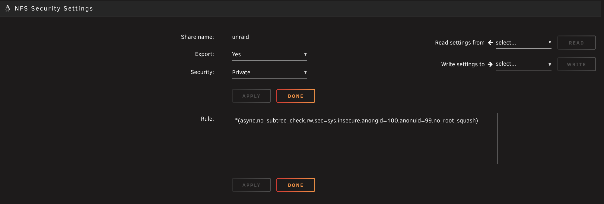

  10. This is an absolutely amazing tutorial and incredibly well formatted! A few questions I have along the way. Configure NFS on UnraidFrom this guide, I have set the rule to (attached): *(async,no_subtree_check,rw,sec=sys,insecure,anongid=100,anonuid=99,no_root_squash)Does the <star> replace the <ubuntu_ip> in your example? Should I specify the <ubuntu_ip> instead? NFS Version> mount.nfs --version mount.nfs: (linux nfs-utils 2.6.4)Test NFS ExportDoes this look good? > showmount -e 192.168.0.30 Export list for 192.168.0.30: /mnt/user/unraid *Manual Mount Test> df -h | grep unraid 192.168.0.30:/mnt/user/unraid 219T 191T 28T 88% /mnt/unraid > ll /mnt/unraid drwxrwxrwx 1 99 207 Dec 4 2023 . drwxr-xr-x 3 root 4096 Jan 27 01:04 .. drwxrwxrwx 1 99 4096 Dec 20 22:41 Movies drwxrwxrwx 1 99 4096 Nov 16 07:54 ShowsCheck PermissionsDoes this look good? > ls -ln /mnt/unraid drwxrwxrwx 1 99 100 4096 Dec 20 22:41 Movies drwxrwxrwx 1 99 100 4096 Nov 16 07:54 ShowsCreate /etc/fstab EntryFrom this guide, it recommends the following mount parameters: hard,timeo=50,retrans=5,relatime,rsize=1048576,wsize=1048576Are these mount parameters okay? It looks like you have several other parameters as well, so should I combine these parameters into this: rw,vers=3,hard,_netdev,noatime,hard,timeo=50,retrans=5,relatime,rsize=1048576,wsize=1048576In Unraid > Settings > NFS > Max Server Protocol Version, should I set this to NFSv3? I really don't know what NFSv4 is or when to use it, but I am on the latest Ubuntu Server 24.04.3. @bmartino1 any thoughts on the mount parameters?

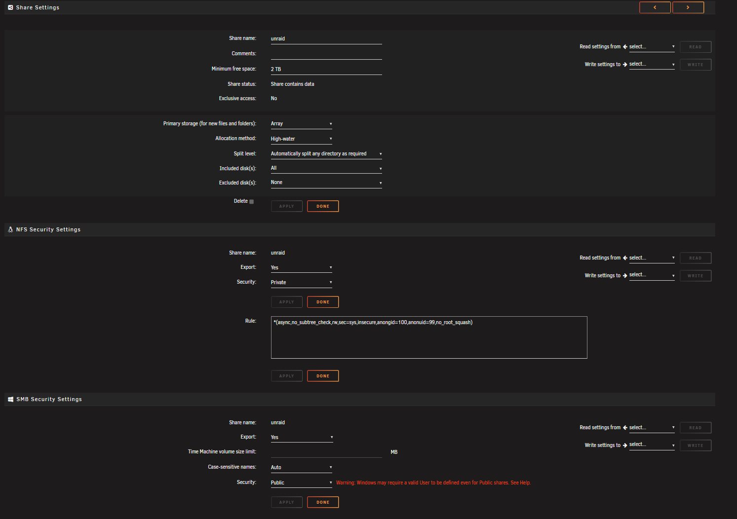

  11. Unraid 7.1.4 I have an SMB share to allow connecting to my Unraid share from a Windows PC (attached). I would like to mount my Unraid array to my Ubuntu Server to be able to read/write to it. Apologies for the beginner questions: Do I create a new share in Shares > Add Share, or is there a way for a share to support both SMB and NFS? Is the best way to create a shared drive through Unassigned Devices? Should I delete my share from Shares and create the SMB/NFS share through Unassigned Devices instead? Should I use Unassigned Devices or Unassigned Devices Plus? It seems like Unassigned Devices is creating a share from a remote server to the Unraid server. I am trying to do the reverse. What's the best way to do this? This guide seems to suggest some settings for the client side mount parameters, so would this go in /etc/fstab? 192.168.0.30:/mnt/user/unraid /my_ubuntu_server/unraid nfs hard,timeo=50,retrans=5,relatime,rsize=1048576,wsize=1048576 Thanks in advance for the tips!
